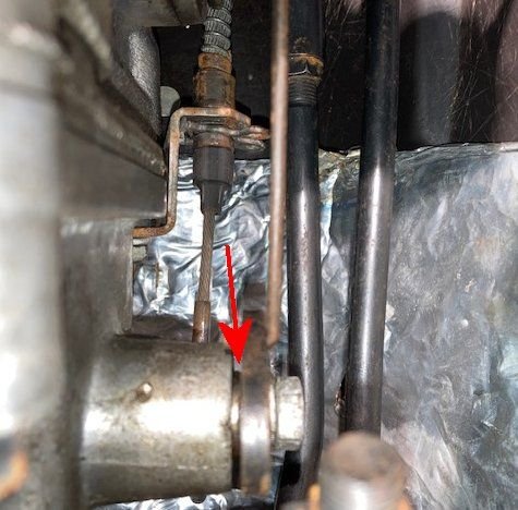

Well, maybe some success. I disconnected the lockout cable from the reverse lever and was able to eventually get shifted into reverse. However, doesn't work on every attempt. I'm able to move the cable not needing a lot of effort. So I don't think the cable is the real/only issue.
I thought I'd try what 4-vettes suggested earlier. I was able to get a box end wrench on the reverse lever bolt and move the lever into what I think might be reverse position. While rocking the bolt back and forth with little effort, it became apparent that the bolt was somewhat loose. The end of the reverse rod no longer aligned with the hole in the lever. Then I saw that there is a gap between the lever and the transmission body. There is no gap at the other levers. When looking at a reverse lever on a supplier's website it appears as though it shouldn't possible to slightly misalign the lever due to the "notches" in the lever that I assume should mate with the shaft in the transmission. Is this correct?
Looking at my photo of the reverse lever, is the gap normal, or should the lever be snug against the transmission body?
Another question: Should the shifter be lubed in any way? Everything is completely dry. If yes, what lube is recommended?
Thanks for all of the replies.
Remove the bolt completely and examine the lever hole where the shaft on the transmission engages it. If everything looks good reseat the lever onto the shaft and tighten the bolt.

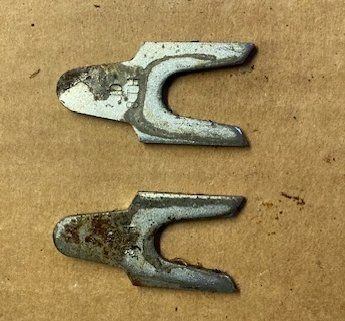

Got the shifter out. Removed the front exhaust pipe but not the bracket. Now forward to clean up and rebuild kit. Can someone tell me where these shims go? They fell from somewhere as I was pulling the shifter down. I don't see them in the AIM or the service manual.
Only guess is to adjust shifter bracket to frame.
