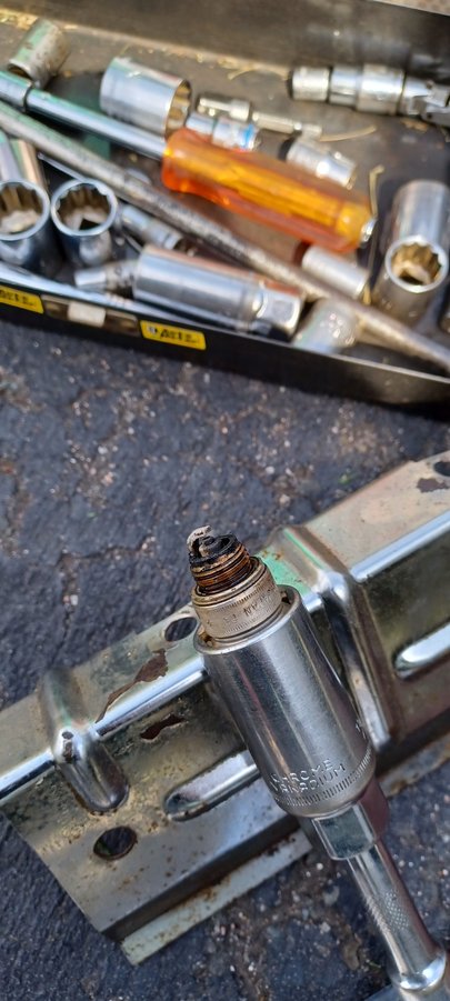

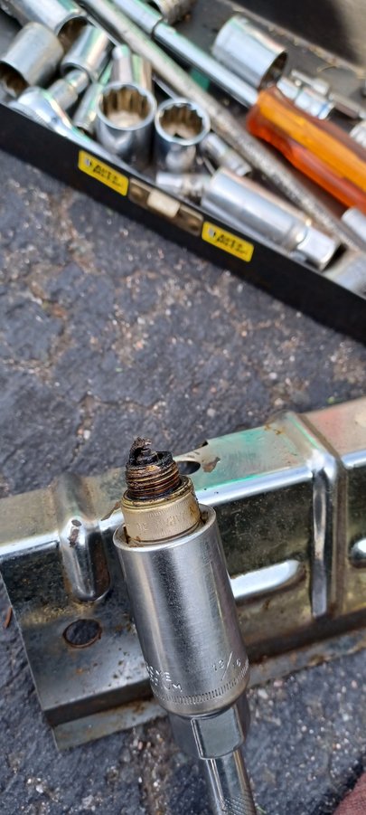

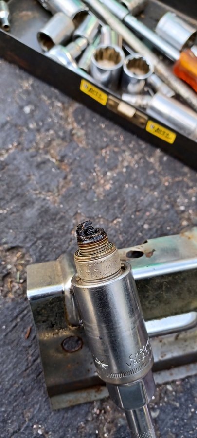

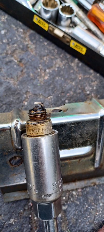

Hi, little update i warmed up car and felt pass side exhaust was weak with the choke on. So i pulled all the plugs on that side.
#4 and #6 seem to be clogged with oil.
I put them back in and swapped them around to see if the oil fouled ones follow the plugs or not.
If they do i think i can blame the plugs and order a new set.
I checked both ends of the wires and no corrosion i could see, and the dizzy looked practically brand new.
Next plan after i recheck plugs, is throw on the vacuum gauge and see if i can rule out valve train and piston issues.
here are some pics.
You're feeling and comparing the exhaust puffs from the side pipes with your hands? GM put a passenger-side "heat riser" valve where the exhaust pipe connects to the manifold. The valve's flapper will cause that side to have a weaker puff than the driver's side. If your flapper has been cut out or a spacer substituted for the valve, there shouldn't be much difference between sides.
I see they are Accel plugs -- do you know the heat range?
