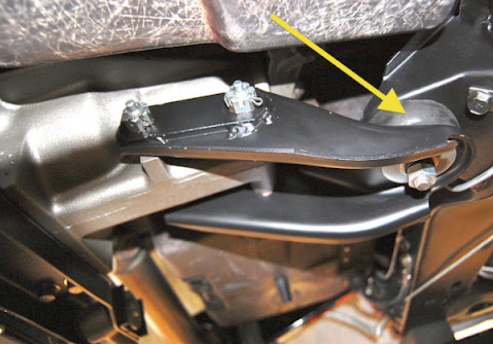

I have a 69 vet I bought in 2010, and I'm recently hearing a clunk sound sometimes taking off in first gear and other times while i turn and accelerate. sound is from the rear. Does anyone know what is could be.

check the snubber bushing

Clunk sound, yup, could be the diff snubber bushing. Could be a bad U joint. I think you need to get underneath and have a good look.

See above....snub bushing. That's what it was for me..

Snubber bushing
Snubber bushing
