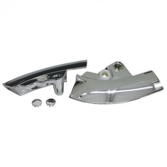

Have a 1972 coupe. Is it possible to convert the sun visor to one that will pivot to the side window. Looking at the later models, 1980 through 82, it looks like these sun visors do pivot. Is it possible to convert a 72 to the later version, or is there another option in the aftermarket?

It might be possible, but beside the 77-82 visors and rods you'd need to use the 77-82 windshield header top corner moldings.
Thanks for the reply.
Do you know if the 77+ windshield piece can mount in the earlier models without too much modification? And will it still accept the old style T-Tops?

To the best of my knowledge, if they're not a direct bolt on they should be close to it. I can tell you the windshield frame (the header, 2 a-pillars and 2 corners) that the corner moldings mount on are the same basic stampings for all 68-82 Corvettes. The top outer windshield molding is the same on 68-82's, except for the later ones being painted black. There are differences in the top header "T" shaped molding (the one that goes between the two chrome corner pieces) but to my knowledge those differences are more about the area where the "T" molding meets the targa bar and not about where it meets the corners.
The one area I'm not too sure about would be how the interior a-pillar and header moldings will fit around with the area of the corner plates where the visor rods go in? The earlier a-pillar moldings are vinyl wrapped and padded making them much thicker than the molded plastic moldings used on 77-82's. The difference in the thickness of the moldings make cause interference between the molding and the hollow boss on the corner molding the visor rod goes through?
There shouldn't be any issues with the T-tops because the position of the front latches and alignment pins is the same on all tops.

Thanks again! I think the vinyl moulding would be retty easy to modify.
