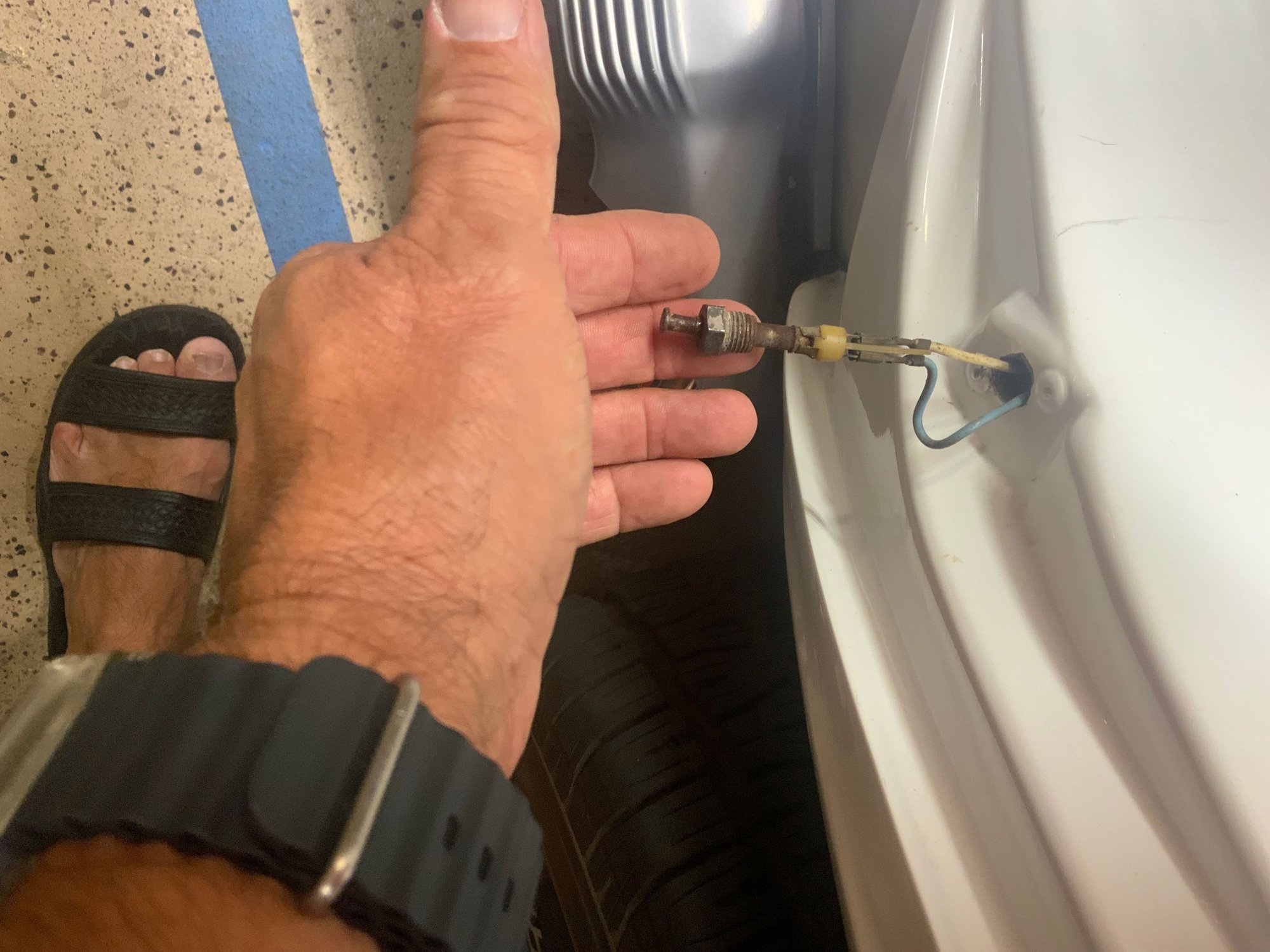

I see them, but how in the world do you get those out?
Old Apr 23, 2025 | 01:09 PM
MelWff's Avatar
MelWff
Posts: 18,739
Likes: 2,583
Hold the center plunger and use a box wrench to unscrew it.

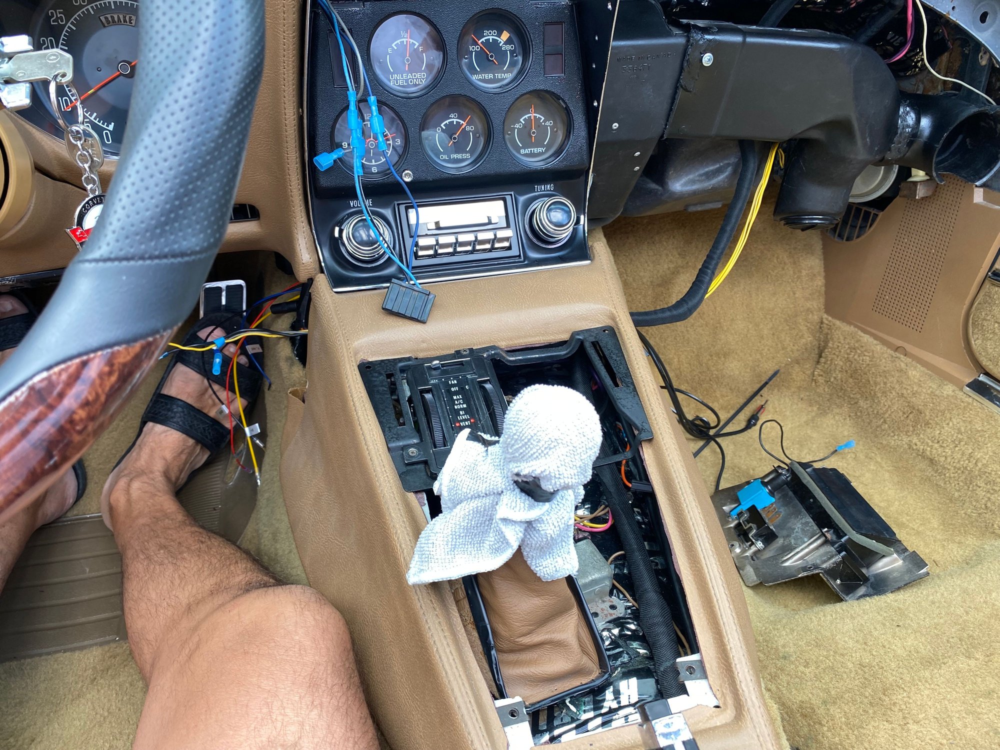

This thing is very loose but won’t turn, it will tighten…I put some liquid wrench in it. Try again tomorrow, I found a crack underneath my center console, I’ll repair that tomorrow to give me a sense of accomplishment….🤣

I got them out, and they have zero power on the meter…blue wire and white ground, I tried running a Separate ground..still zero power? Almost like these guys gave a fuse??? I’m stuck, any ideas, besides just trace the blue wire and?
