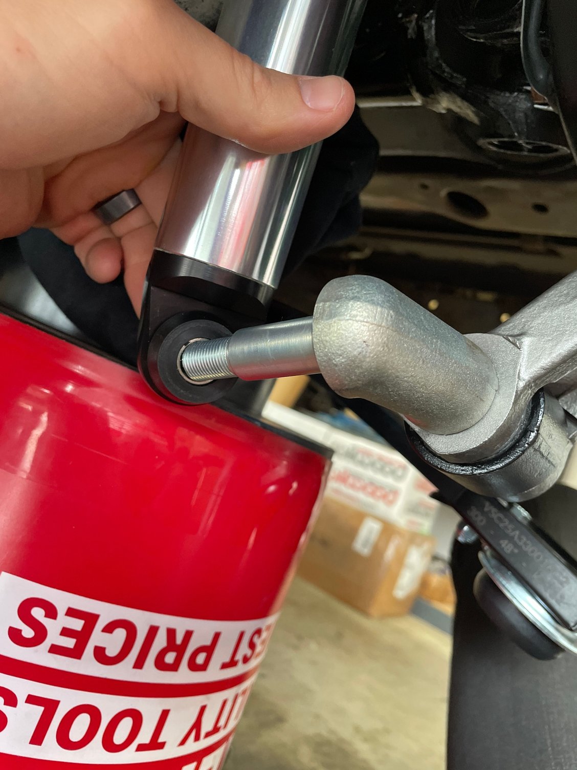

Installing Ez ride suspension kit from van steel. The QA1 shocks come with these metal sleeves that you can press in, but when you press them in they won’t fit. Also having trouble with the angle of the bottom mount (in picture). First time installing this stuff, what am I missing?

When you say after you press in the sleeve they won't slid into the upper mount bracket? The bottom mount you can twist the body of the shock to align it with the mount.

Start at bottom of the shock then jack up the ta arm. It will not just slip in you will have to work it in. It’s a pain.

Can you lift the trailing arm a bit to make alignment easier? Also, since everything looks new, did you use the correct shock mounts on the correct side? There is a left and a right.
If the steel sleeve is just a bit too long, perhaps you could sand it down, or spread the bracket apart. How close to fitting is it?

Yep. Jack up the T/A till the hole and mount line up.

Did you get it sorted? My shock mounts are parallel to the ground, even at full droop.

They sent me 2 right side shock mounts. All is well now. Thank you.
