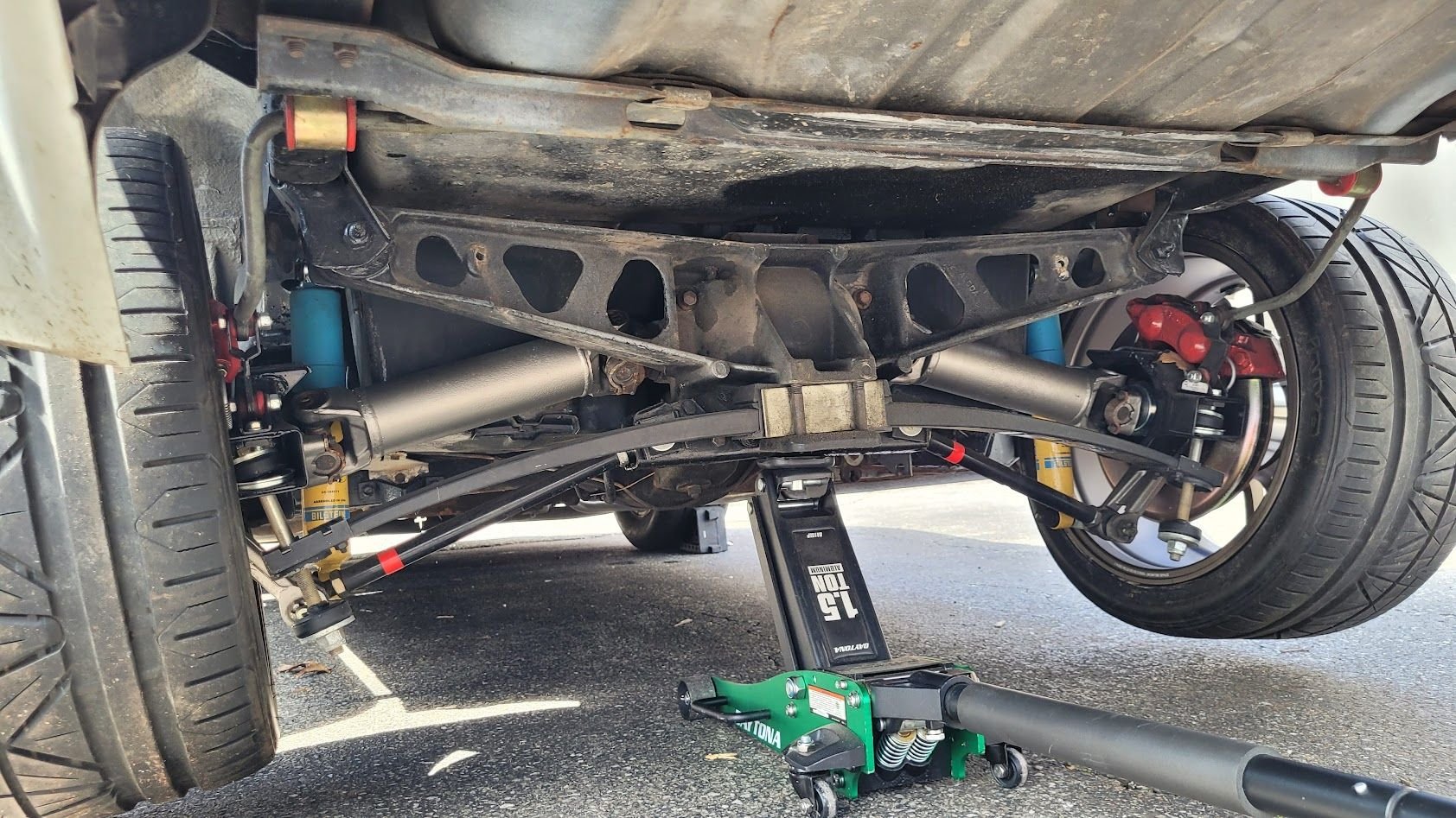

Bilsteins, or better. It's a sports car!
Sports in the rear, HDs in the front. I wish I had a stiffer rear spring, though (this is only 360/385 after cutting).

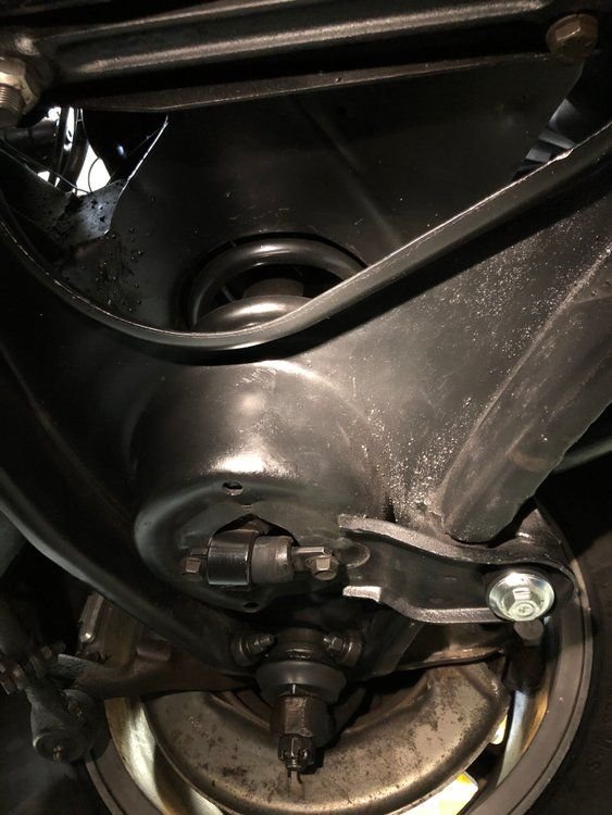

I would not recommend ac delco.
bush gs came out on mine.
went bilstens here and further learning
https://www.corvetteforum.com/forums...nt-advice.html
