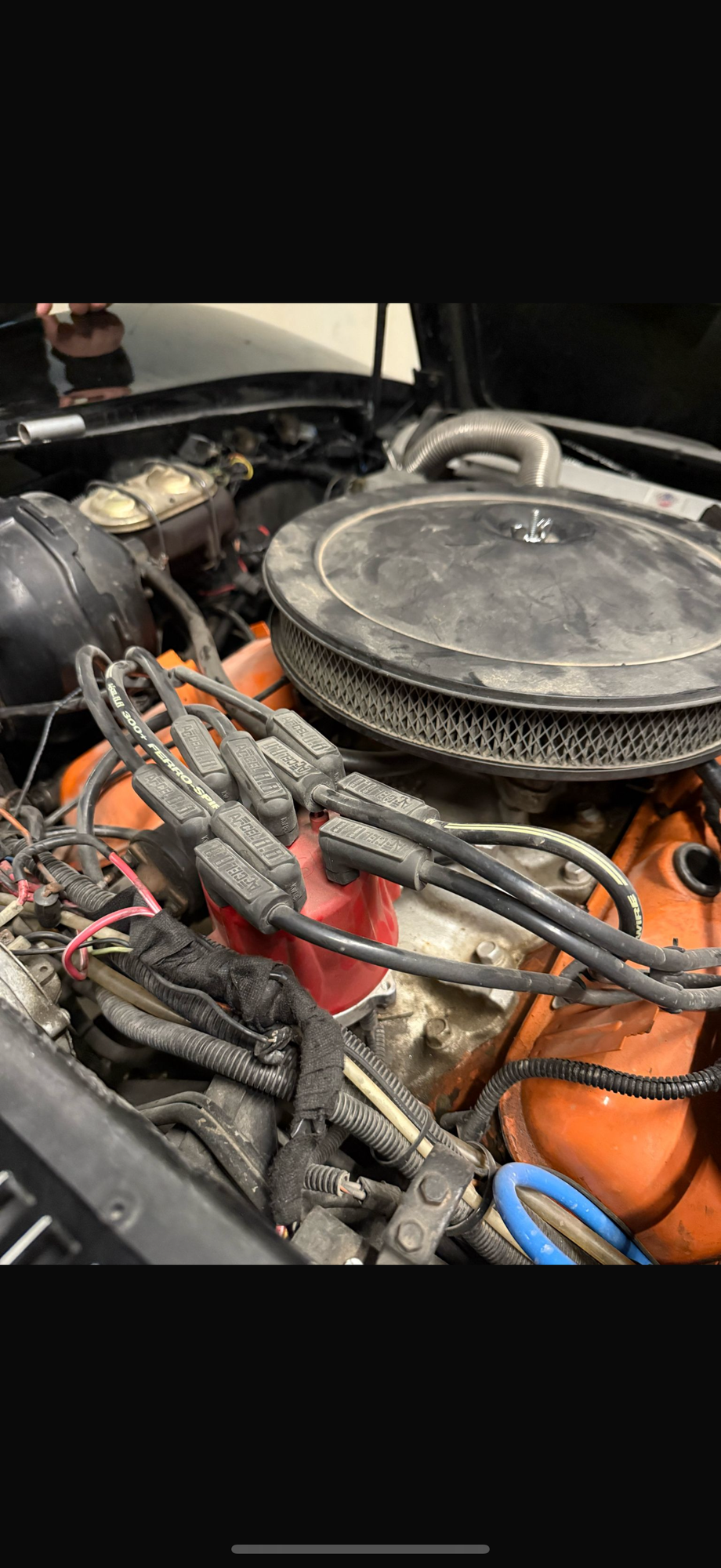

First of all, hello everyone, I am writing from Türkiye. I have a 1972 model 454 big block c3 corvette. The engine of the vehicle is not working right now.I took the car out of the garage in the evening as a routine. After driving 1 km, the engine suddenly stopped. The fuel was a little low but not so low that it would not start. Then I thought it might be the fuel and filled it with fuel. It still did not start. I thought it might be the fuel pump fault, so I disconnected the hose going to the carburetor and started the starter, and the fuel filled the bottle very quickly. I thought it might be the spark plug and saw that I had 2-3 burnt spark plugs. I put in 8 new spark plugs and it still did not work. There is ignition in the spark plugs, the starter works but the engine does not start. I am waiting for your help, thank you in advance. Meanwhile, when I press the starter, a very loud explosion sound comes from the exhaust.

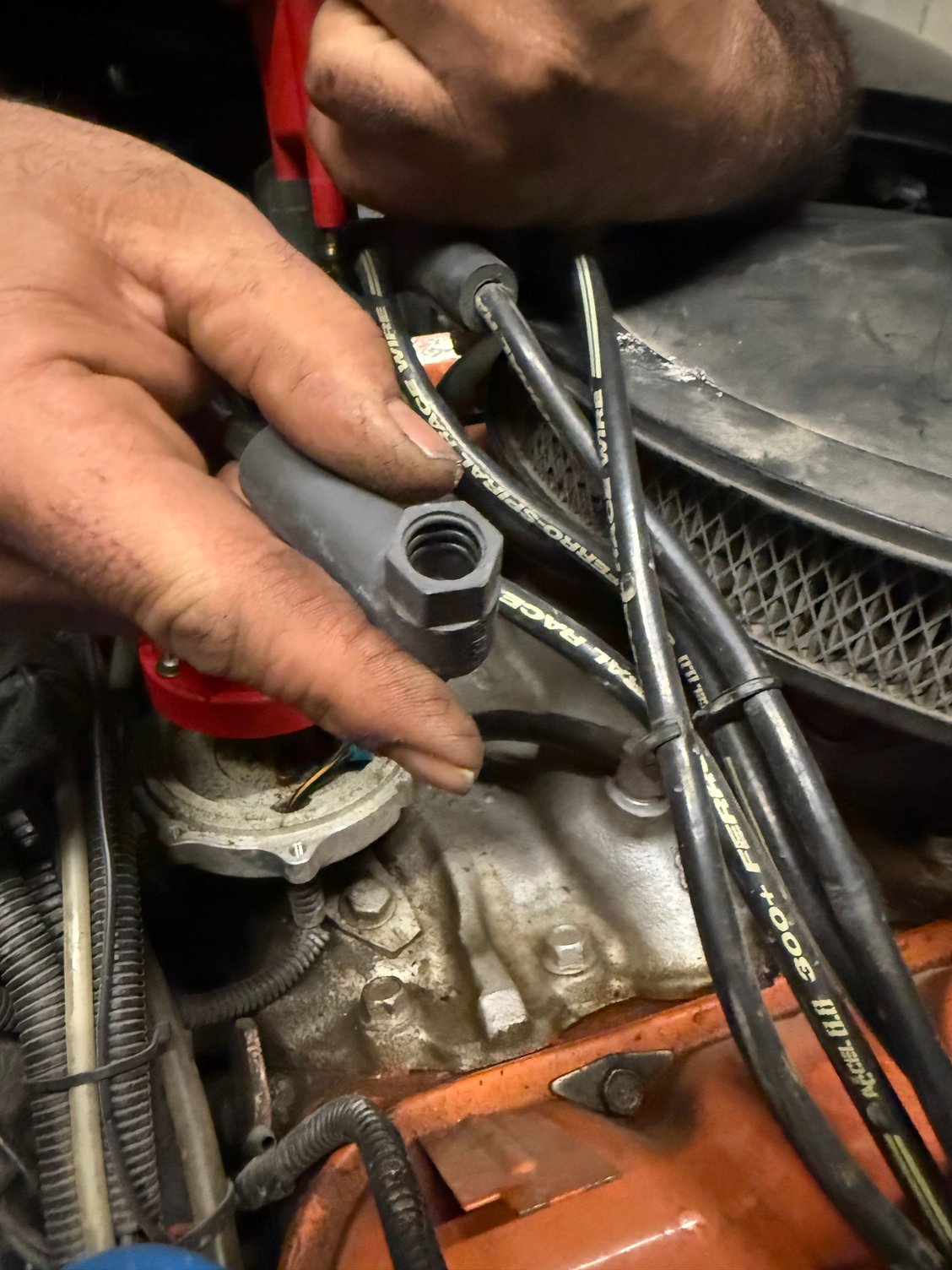

And by the way, if I may add, the mechanic told me that the carbon in the distributor cap was finished. But the mechanics here really don't know much about American cars.

Your mechanic was right, that distributor cap is SHOT... With a new cap and rotor do you get a spark at the spark plugs? It sounds like an ignition issue to me from your description and after looking at your distributor cap it appears that you might want to start with a good tune up. I see the distributor has corrosion so verify the ignition points and condenser are working properly. You might try another ignition coil as they are known for failing in many different ways. I have seen a bunch of the ignition coils fail over the past couple of years. The ignition coils that sit for any time can fail as they start to warm up.

Your mechanic has a "good eye" to catch that dist cap issue. Few people even look in there.
Not sure your parts availability in your area, but you need to order a Cap & Rotor as a set, soon.
The center terminal is shot. And likely the center of the rotor is bad also. And for what it's worth, there is a huge difference between a $19.95 set and a $50 set.
This is an easy fix. Just mark all plug wires with masking tape & a Sharpie. Swap both parts out.

Probably not related to your problem but you need to put a breather in the hole I see in your passenger side valve cover. assuming your PCV valve is hooked up on the driver side you do not want it pulling in unfiltered air into your crankcase and carb normally there is a hose assembly that goes from the valve cover to the stock air cleaner which you do not have. also, it would not hurt to remove your air cleaner assembly and take a few pictures of what you have going on with the carb and intake and someone may be able to notice if there are any hose etc. that are not hooked up correctly.
Pat
Thank you very much, believe me, I don't even know what the part you call pcv valve is, I just looked it up on the internet and learned it. I will take a detailed photo of the engine tomorrow. I hope I can make my vehicle better with the information you provided.

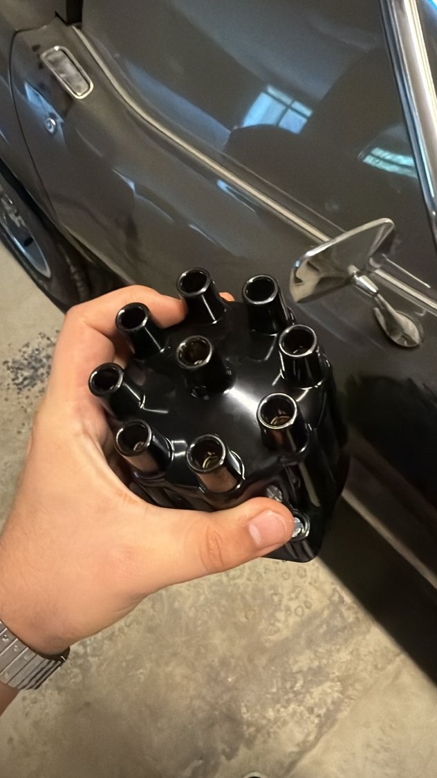

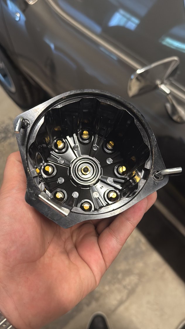

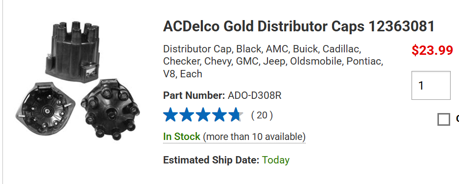

Hello everyone again, I bought the distributor cap as my mechanic and you in the forum said. However, the new black one did not have metal conductors on it like the old red cap, then when I looked to see if there were any on the cable, there were none on the cable either. Either the red cap is original or the black cap, I do not know which one is correct, I am waiting for your support, thanks in advance
To Big Block Engine is not starting please help

So in the end it didn't work because there were no conductors on the cover but it fit into the slot.

Your distributor is an aftermarket distributor and the red cap is probably the correct type cap for that distributor.
The black cap you purchased is for an original equipment type distributor and while it may fit, it is not correct for your distributor.
You’ll need to find the correct cap for your distributor.
If your distributor doesn’t have any brand or part numbers on it, you’ll have to do some research to determine what the manufacturer was for that distributor so you can find the correct cap.
When I bought my 73 a prior owner had replaced the distributor for an aftermarket HEI that had no identifying brand or part numbers.
I couldn’t find the correct cap and so I just purchased a new MSD distributor.

Looks like you have a standard size distributor. Non Hei. It is not original since it has an aluminum body. With an internal electronic pickup module, no points. Uses clamp down caps. The red color means it may be an aftermarket MSD model or an overseas knock-off.
Your wires are set up for the aftermarket "tower" sockets. Factory uses a "socket" style, but would require different plug wires. These two styles are pretty standard. Racers prefer the MSD style, the wires may be better, they just do not look factory.
Just buy a new MSD style tower cap, and a new rotor. Summit Racing has them. 84335 is for the cap & rotor set.
Link:
Summit Racing
And yes the button in the cap can fail like that, and it happens quickly, without any drama, just dead.
