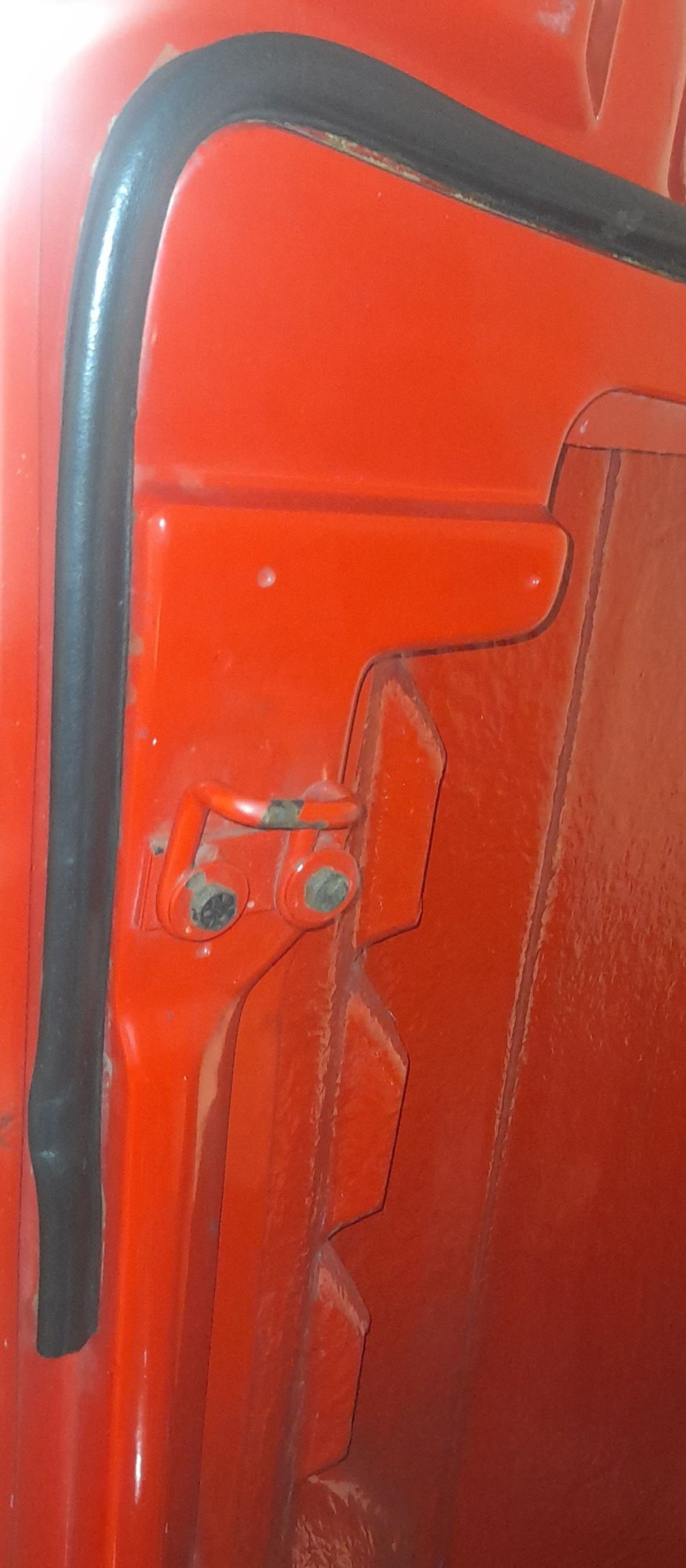

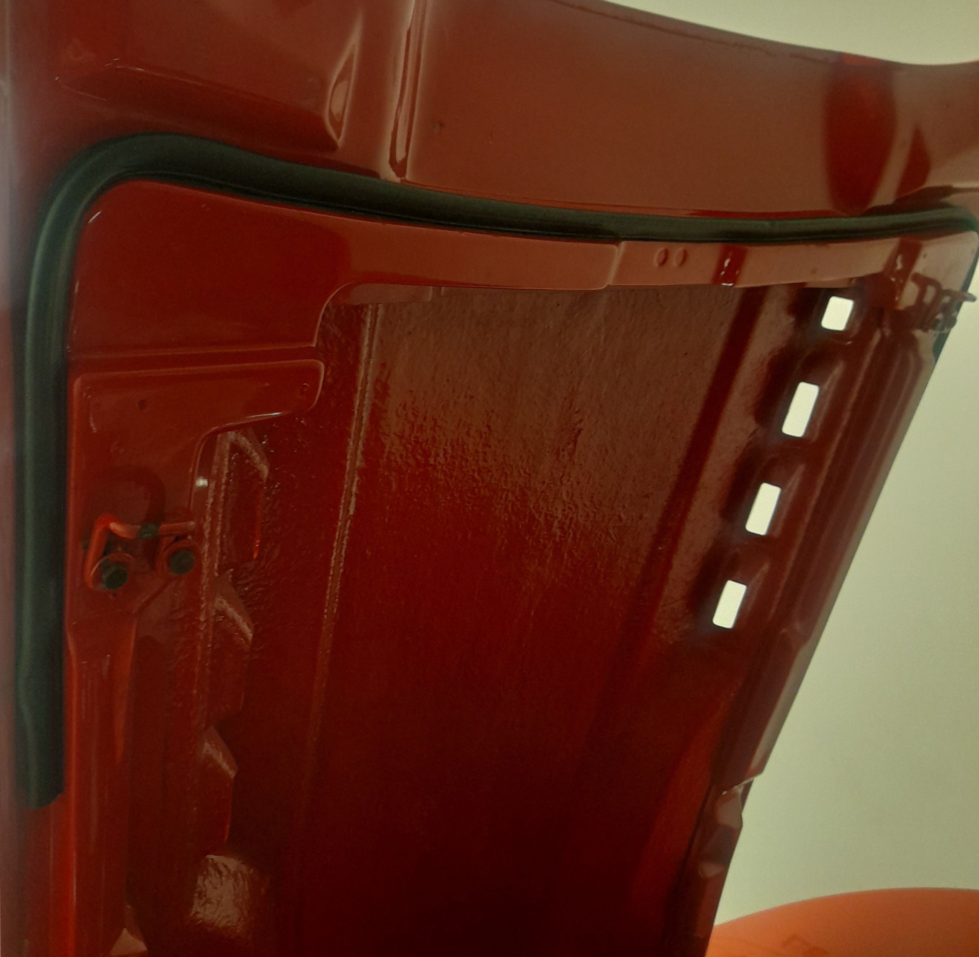

I went out and double checked the hood weatherstrip on my 77. As I thought, the ends are cut square, not tapered or angle cut.

I know my '77 weather strip is cut square as well.....

A few years back, 25 or so, I installed a new hood because I don't care to play the "will this fit under my stock hood" game. So,
I had the advantage of having the original hood and weatherstrip right next to the new hood and weatherstrip.
So, although I no longer have that original hood, here's a couple pictures of my current hood and weatherstrip.
