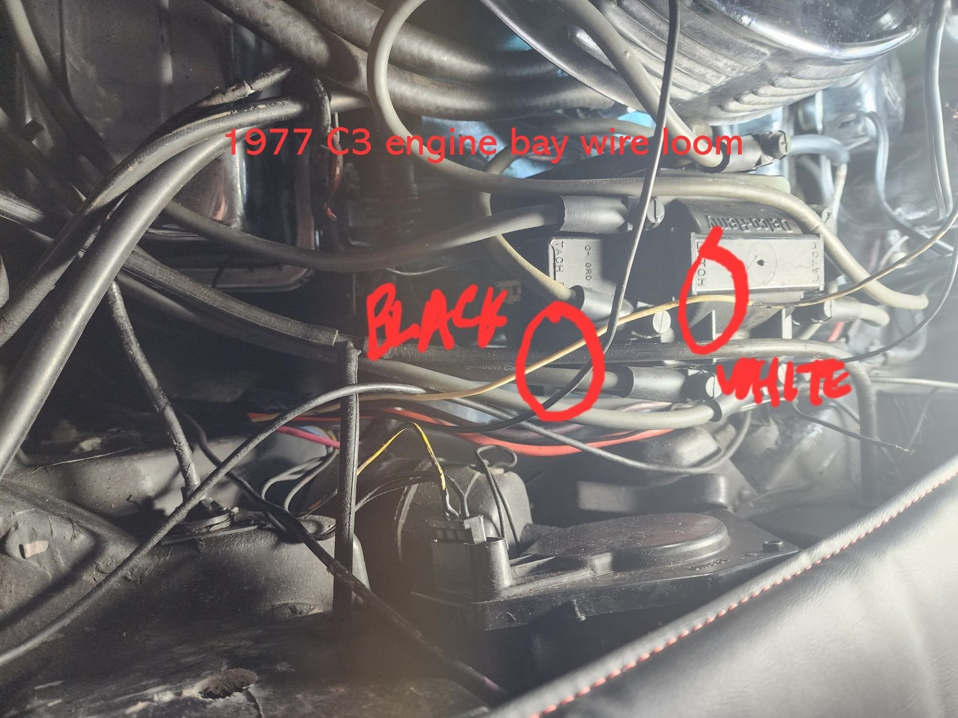

Hello,
I have two wires that are coming up from the engine bay wire loom that I do not know where they are to go to. 1) Check the wiring chart and it shows a white wire that comes out of the interior as white and changes color to black intended as a ground? 2) have a black wire coming up from the engine bay wire loom
Engine wire loom has a white and a black that goes to? Engine bay clean up revealed these wires
is black that goes to?

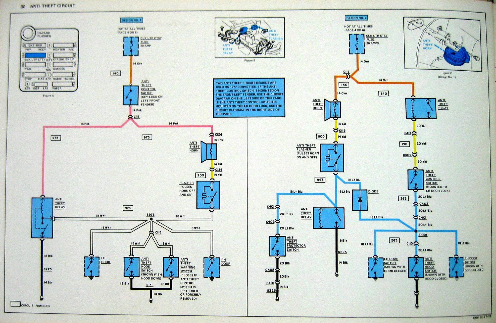

If your 77 is a early build my guess would be the anti-theft hood switch...
First design (early build) drawing left portion of the page...

Wow, that is nice, thank you, did not consider it. Also thsnk you for the diagram.

You too can have all those diagrams. Purchase the genuine GM Electrical Trouble Shooting Manual for your 77 corvette.
that's where that page comes from.
Worth its weight in gold while working on your car!
