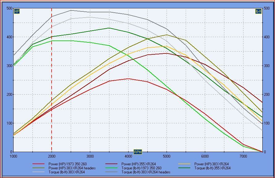

I ran a couple options for you thru Desktop Dyno to give you an idea of the power curves
Curve 1 - Stock1973 L48, as close as I could mimic it. Iron manifolds.
Curve 2: Rebuilt 355. Changes AFR 180 heads, 9.5 CR, Comp XR264 HR cam Iron Manifolds. Way more TQ but only from 3500 up. HP up significantly higher, 260 to 345 HP.. AFRs and a HR really help the power. 9.5 CR might still be OK on 87 octane pump gas. Could push to 10.5 CR if you want to run premium. 212/218*@ .050" HR cam. Nice mild & TQy street cam.
Curve 3: 383 same as above. Iron Manifolds. TQ @ 2000-2500 jumps 40-50# TQ. But HP not really up much. But look at the TQ jump.
Curve 4: 383 same as above with headers. TQ @ 2000-2500 jumps even more now 100# more than L48. Approaches 480# at 2500-3000.
383s like to breathe. This is still a kinda small street cam 212*/218* @.050. Going up one step on the 383 only to a XR270, 218/224*, gains 35HP up top, with virtually no TQ drop down low. That is a win-win. That would be around 435 HP @ 5500, and 480# TQ @ 2500. On 87 Octane regular pump gas no less.
Hopefully you can "see" the TQ difference at 2000-3000. That is where you drive it. You drive TQ not HP.
But the HP difference is also incredible when you floor it. From 260 to 435HP. You use HP when you race it.
With a 383 it will not feel like the same engine at either end of the power scale.
With a 355, it will feel better mostly when you rev it. It will be a lot stronger past 3000. But not too much change below that.
This program is not exact, it might be within 10 or 20 HP/TQ, but it sure makes it easy to compare engine combinations!
And if version 4/5 cost almost the same money????Why not?
