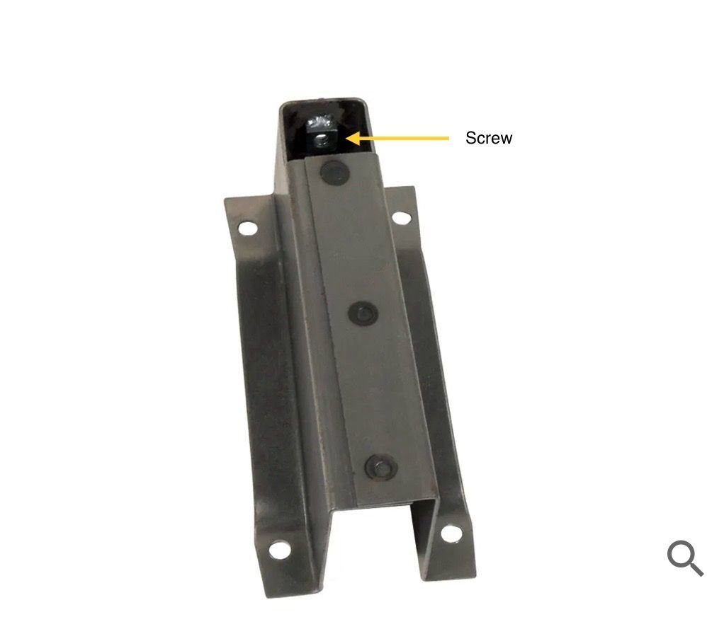

Does anyone know the thread size, coarse or fine of the bolt that goes through the Parking Brake console into the rear bulkhead?

I'll guess the bolt is 1/4 x 20 about 1 inch or 1&1/2 inches long.
You will find it is easier to screw the bolt into the consol first with the head facing the engine.and then slide the consol into the bulkhead hole.

Do you then put a nut on the other end behind the rear bulkhead?

The reinforcement (shown in your photo) gives the console strength so that if you lean on it the console does not crack, so no I did not put a nut on the bolt.

Or, you can make the threaded end a "bull-nose" that merely gets inserted into the hole in the rear blukhead panel. Then you never have to remove that bolt again.
