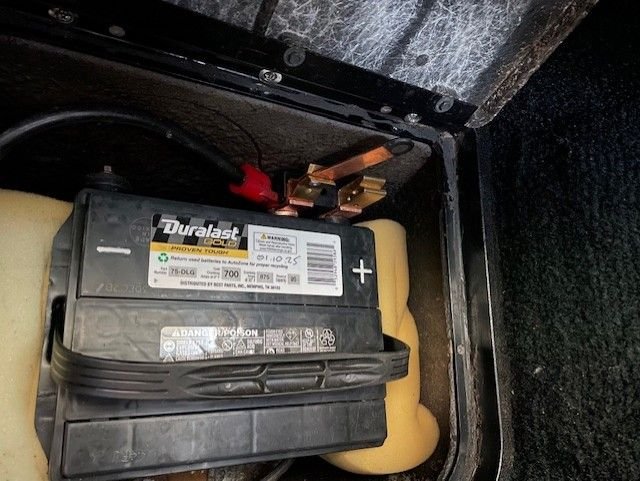

Hi all. Completely new to corvette (and cars). I purchased an 82' crossfire engine last summer and its given me a lot of headaches. I've gotten a few of the issues taken care of but this battery drainage - i dont even know where to start.
It was kept on a tender all winter but its not holding a charge. It did the same thing last summer but we replaced the battery, hoping it would fix the issue and it did not. The guy I bought if off of did put in a new stereo so I am wondering if that is the issue but I don't know how to determine that. If it isn't the stereo, I dont even know where to begin. Any advice or help would be appreciated!
