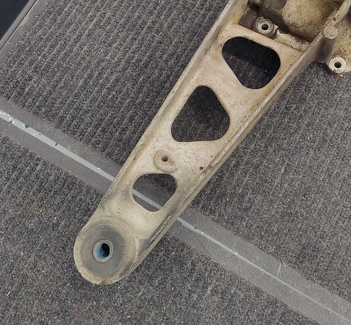

I'm looking for this bushing.............
That does not seem to be available in rubber only poly or aluminum for track use.
when I did mine I searched high and low no rubber that's why I went Poly, the front rubber kit is available. I don't think Poly made any difference anyway you won't notice the difference between rubber .

Poly in that location will not make any difference in ride quality.
