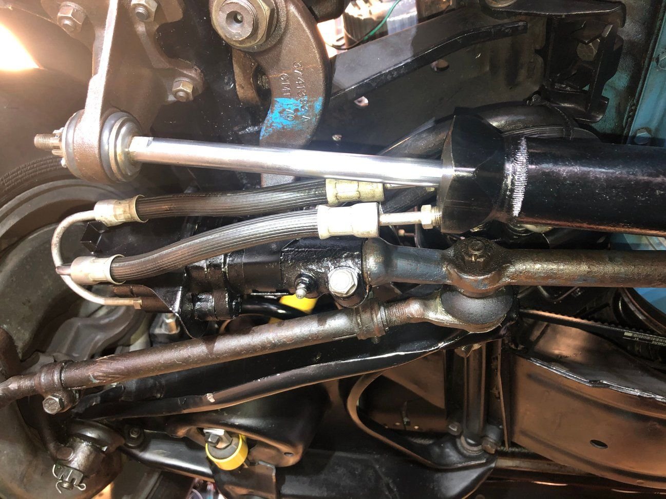

Hi, I have a 1978 Corvette I bought a couple months ago and its slowly dripping from the grease fitting on the power steering cylinder? Its a very slow drip. Im just curious how to remedy this or if it needs to be replaced.

The zerk fitting is a perfect drip point for fluid to collect on. I'd suggest your first step is to clean the components as well as possible: hoses, control valve, and hydraulic ram. Operate the car as normal for a bit and recheck the components for fluid seepage.

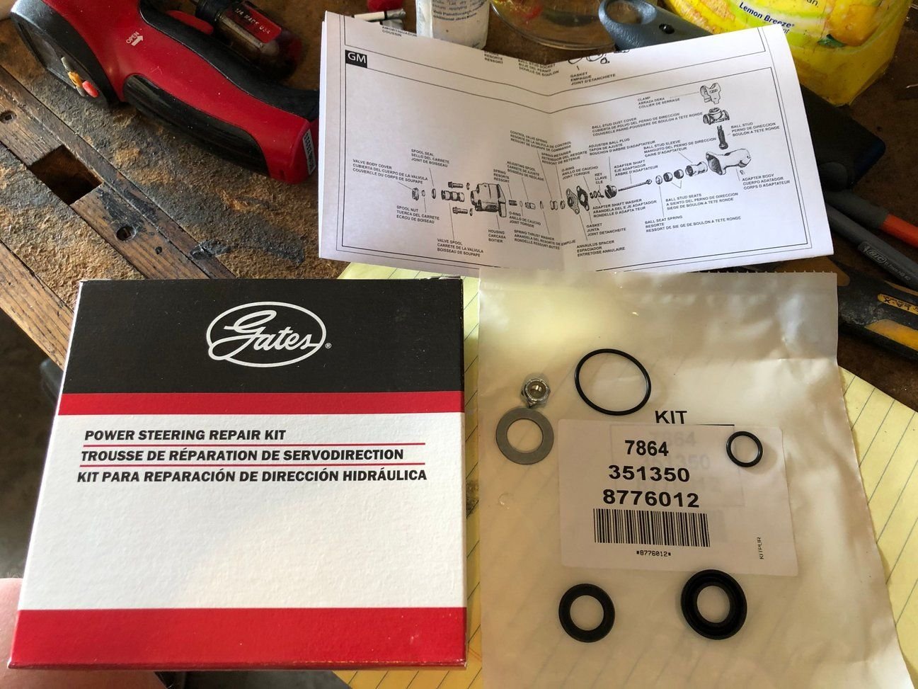

Very common. If its the Control Valve.
You have three choices to remedy this:
Purcha$e a brand-new unit.
Purchase a rebuilt unit.
Rebuild this unit on your workbench.
There is a video, step-by-step on how to accomplish this.
There are two kits that can be purchased to rebuild a C.V.
One is basic simple seals around $25. The other is more money with more labor / parts involved.
I would start with a YouTube video of how to remove the C.V. from the car.
Then find the video about rebuilding and see if that is something you are willing to do.
If its the ram cylinder leaking, save your time & money, just buy a new unit.
There is not a grease fitting on the ram.

Your simplest fix is to remove the Zerk fitting and insert a (properly sized) pipe plug with sealant on ONLY the threads (don't let any sealant get inside the control head).
That fitting is for testing during assembly operations only. IT IS NOT A FITTING TO BE GREASED. If you greased it (or some oil 'jockey' did), a seal was likely damaged internally which started the leak. After sale, that fitting serves no purpose. Delete it and hope that no functional damage was done to the control head.

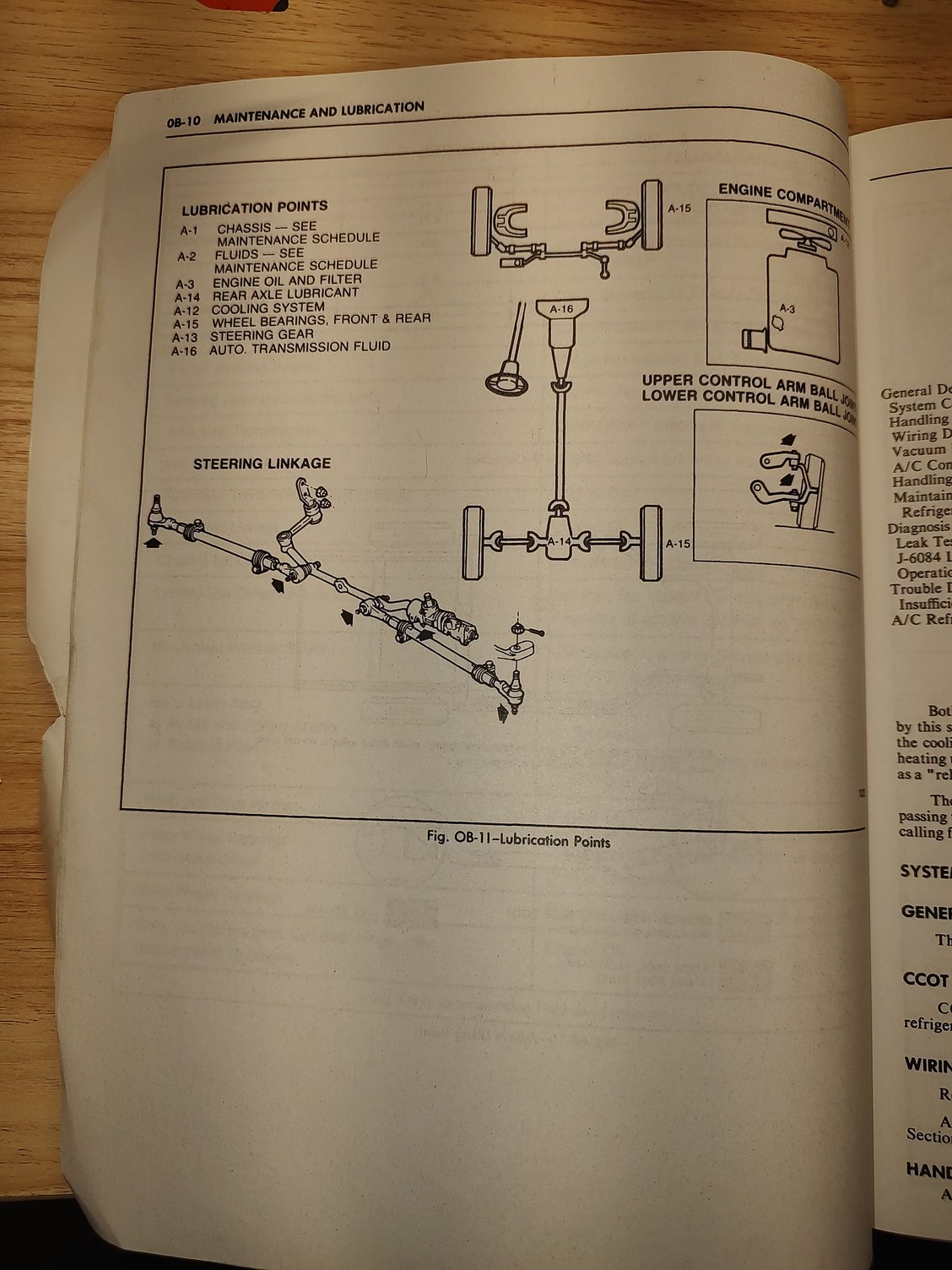

That's Bull. All you're greasing is a pivot ball and two cups. The hydraulic portion is off to the end. Even the factory service manual shows it should be lubricated. The control valve is very simple to rebuild.

Not "bull". If you are getting P/S oil from that nipple, the ball fitting is already being lubed...with P/S fluid. Grease isn't going to do anything for you. Seal it off.
