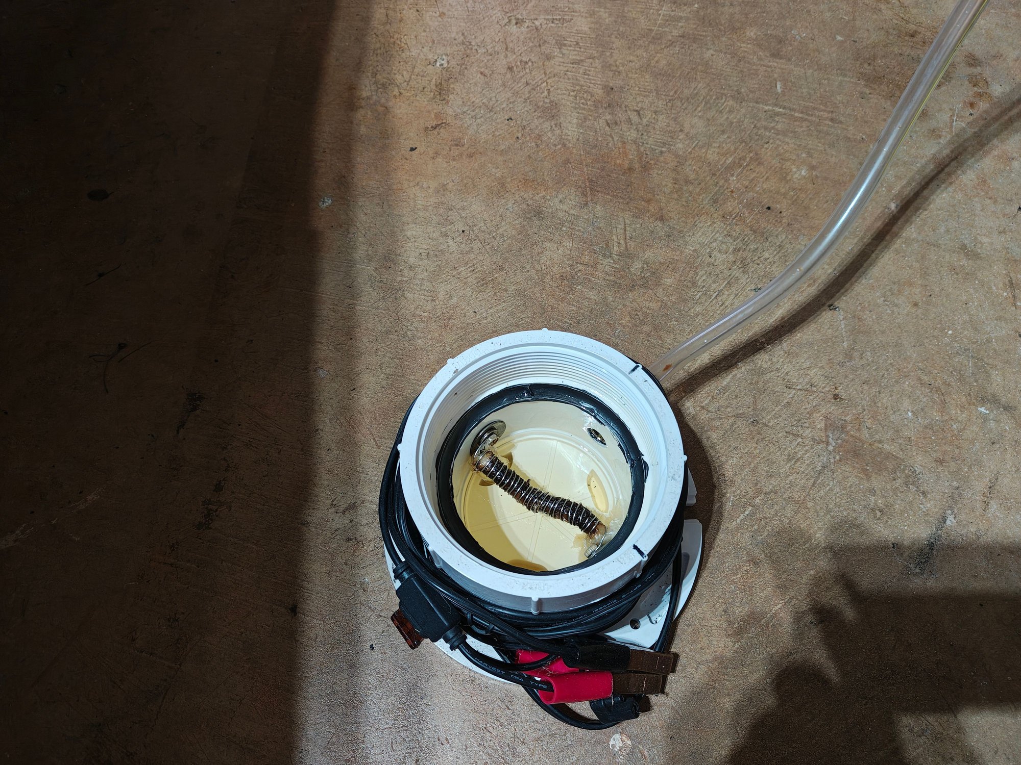

I had some thin Plexiglas that I made a plate with. I used door weather stripping to seal it and used a spacer and carb stud to hold it down. Worked great. I even made my own smoke machine.
Here is a video of the only small leak I found on my Holley Sniper 2 throttle body troubleshooting what I thought was a vacuum leak during installation. Holley said this was normal to leak at the throttle blade shafts a little. I even sent it back to Holley (warranty) and they checked it out and found nothing wrong. I ended up replacing my dual plane intake to a single plane. I never did find a leak.
