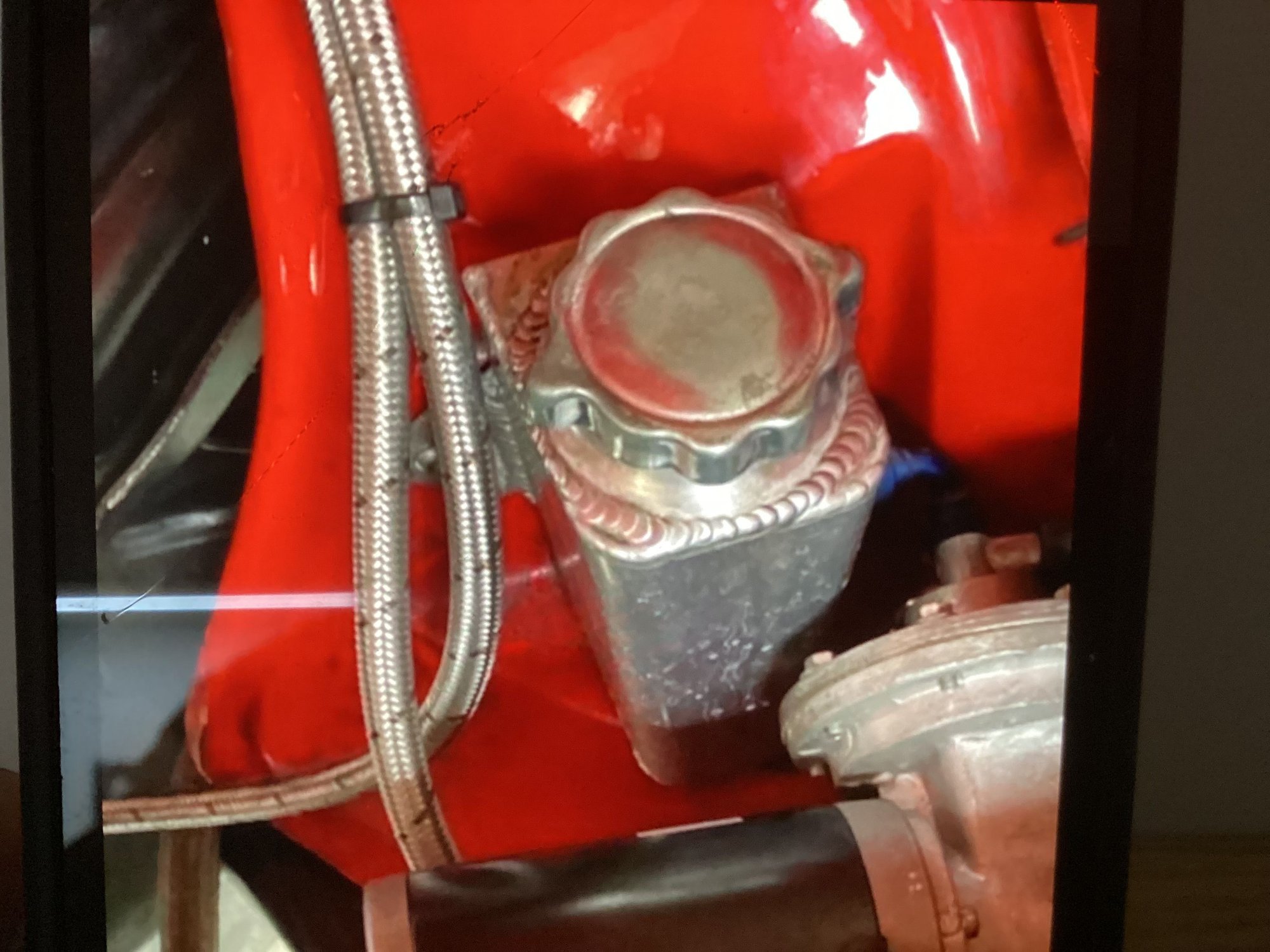

The reservoir hasnt any stick to check the level, I just opened it and I found out its level was at half of the capacity.

Old Jun 1, 2025 | 05:38 PM

Sorry. All bets are off.
You are in Italy.
You have an aftermarket PS pump.
It's not a GM Saginaw pump.
Before I put my foot in my mouth, I can't help you after all.
Good luck.
