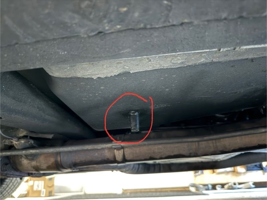

I found a new leak on my 82 CE. It's coming from what seems like a vent or drain just ahead of the passenger floor pan. I'm thinking heater core. Any suggestions on how I should get into it? Thanks!

That looks spot on as the floor board. Not ahead of it. But spot on the floor board.
is leak coolant green?
If so, Yes I would think your heater core has bit the dust.
What to do now?
Where do you live? Do you even need heat?

this is how i got into it..
https://www.corvetteforum.com/forums...-79-l82-m.html
