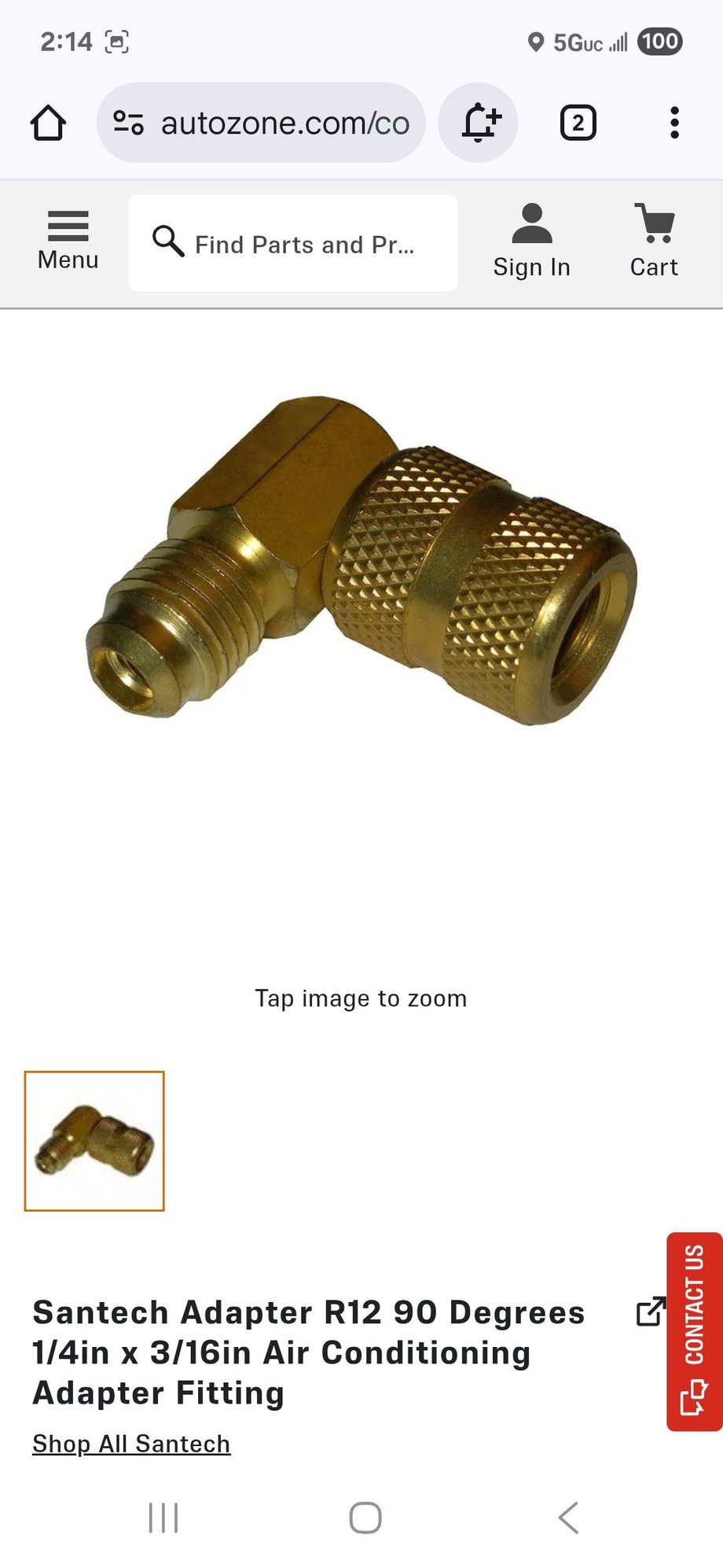

Originally Posted by interpon
Thanks guys... assuming this is what your talking about?
Old Jun 9, 2025 | 07:53 PM
interpon's Avatar
interpon
Joined: Jun 2019
Posts: 7,642
Likes: 2,463
From: Indiana
3/16 sounds right and looks right.
the link where i bought on ebay no longer exists so I cannot confirm.
thanks interpon, I've ordered it... I wouldn't proceed forward till I have everything I need so ordering everything now and reading up... thank you again.

Bob, That looks exactly like the adapter I have for the R12. If you end up going the 134 route there are adapters that screw onto the R12 fittings that will then allow you to use the 134 gauges. One advantage to them is you can shut off the gas flow before you disconnect the hoses. On the R12 set up the freon is leaking while you unscrew the hose.
thanks Kanvasman, right now I am planning on staying R12 as its still pretty readily available and thats the equipment I have, im picking up 4 cans when I get back from business later in the week with some PAG oil and an r12 can tapper, also ordered the gauges... as always this site helps me out... I'm always looking forward to the challenge. Thank you again
