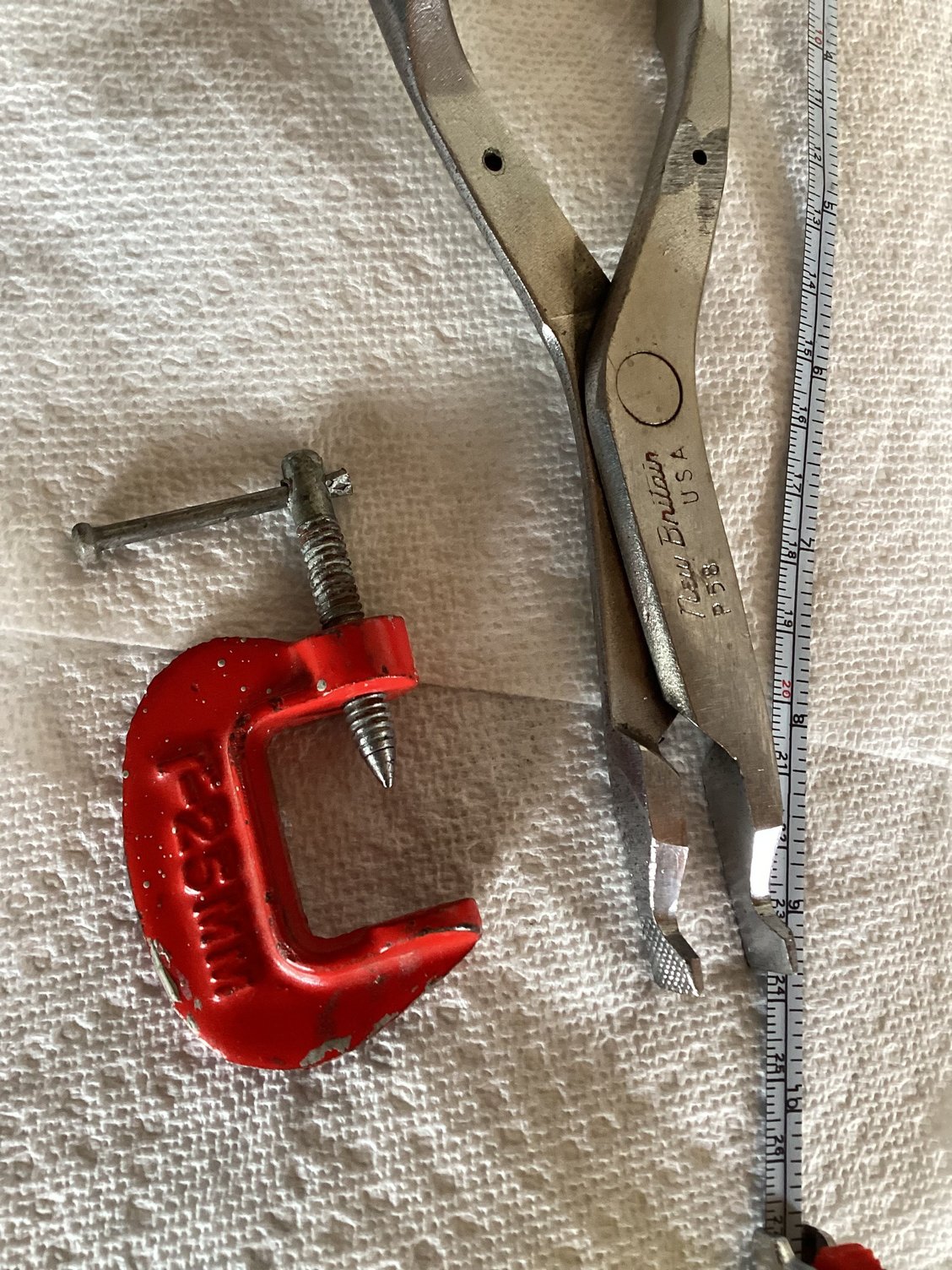

Maybe this might help with “T-Top Trim” installation without scratching fresh paint.
These are the two tools that I used, a pair of snap ring expanders and a
easily modified mini C-Clamp. (See 2- attached photos)
I gently spread the trim apart with the snap ring pliers, once in place I crimped
the trim at the factory crimp positions with the “point” I had made on the C-Clamp.
(NOTE: I was working with a 1978 Model - Your Trim might be different?)
Use plenty of “Blue Tape” to protect Your NEW Paint 🙂
NOTE: Modified C-Clamp “POINT”
Brilliant!
