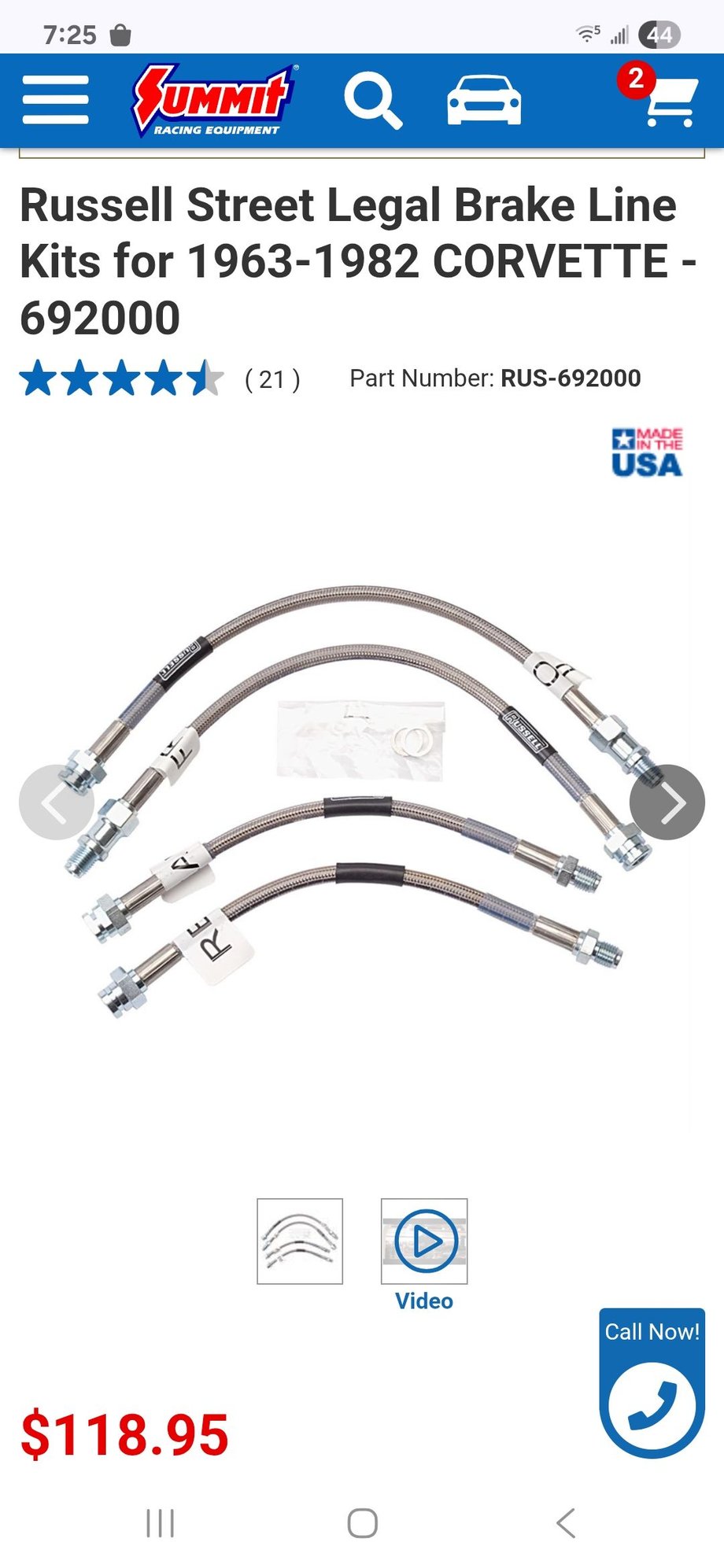

https://www.summitracing.com/parts/RUS-692000
I'm running these with stock calipers. They ship with a "born on date"... must of been a month old. No complaints.
