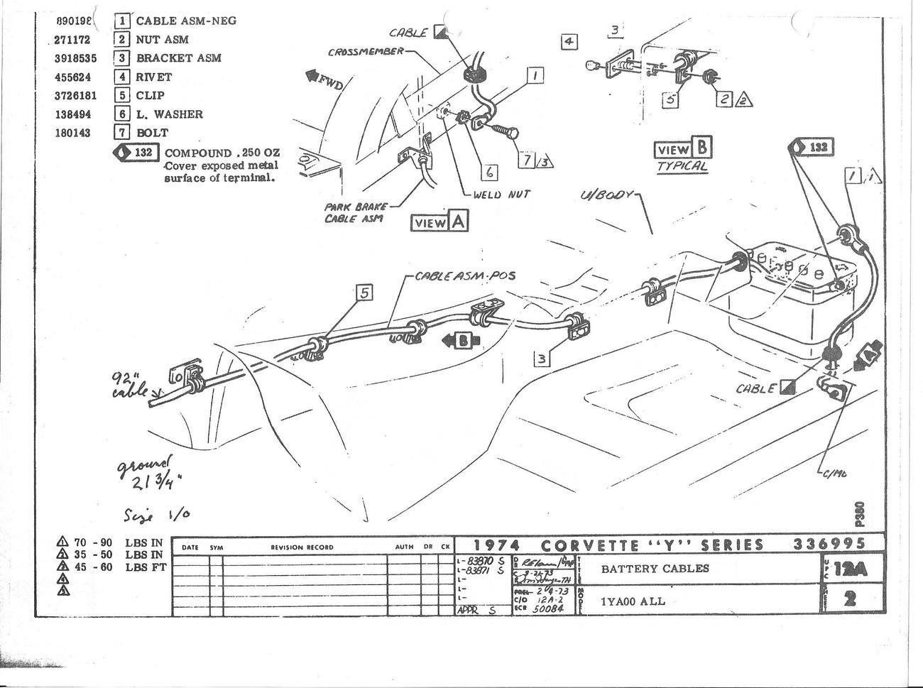

Have you checked or replaced the positive cable from the battery to the starter?

YEs I agree!! check the ground and positive leads at the battery and the ground on the frame. Makes sure the engine has good grounds. When the engine and starter are hot they take more amps to crank. IF its not turning over at all which I would guess from the push start comment then I would check that and maybe have your battery load tested, it may be weak
as peterbuilt said check the cables as well, if they are swollen any where along their length its corrosion, replace them

The ends were good and I had no trouble cold so I didn’t replace it. I’ll inspect it and move to the power steering project since I don’t have the right ends on hand and cable that long to make a new one now. I can order what I need and come back to the startup gremlin in a few weeks.

Look into testing for "voltage drop". You can have continuity and current flow, but if the wire is compromised, there's not enough voltage to activate the starter.
There are good YT videos explaining and showing how to test for it.

I solved the same problem on our '72 a long time ago by cutting off the last 1" or so of the leads going to the starter, and installing new terminal ends. I'd noticed that a number of individual strands of copper had broken over the years, so I re-terminated in 'fresh', unbroken copper.

I checked the starter, rebuilt the solenoid with a kit that was once available from GM with a stiffer spring, and wrapped it for protection against heat soak. Finally, I checked the wire leads and spliced in fresh copper wire by soldering and soldered on new terminal ends. That resolved it for me.

If you can't get adequate current to the starter/solenoid, it doesn't matter what starter you install....it still won't start. The front mount/bracket on many C3 starters is the primary connection for electrical ground, via the ground jumper wire from frame to right side engine mount. If that grounding system isn't fully intact, you will have starting problems, even when cold...but definitely when hot. C3 starters have worked flawlessly for decades. The starter CAN be a problems IF the brushes are worn out. Otherwise, GM starters are virtually bullet-proof.
Do yourself a favor and check out the presence and condition of primary current paths (positive AND negative), before you throw $$$ at the problem.
