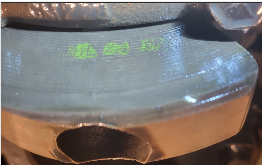

Finally digging into my 71 LT with NOM and trying to align facts from verbal history and current reality. I bought the car from the second owner who purchased it in late summer 73 with current engine.
This was related to me from 2nd owner as reason for replacement engine;
The original owner told me that he tried to change the camshaft when the car was new and did it wrong, pumping a rod through the block. He ordered a new 11 to 1 compression LT-1 engine assembly from Chevrolet, same as issued for 1970 LT-1s (the original 1971 engine had 9 to 1 compression), ergo, the CE stamp on the block. He told me he had an engineering shop install the new engine, changing the camshaft to a General Kinetics solid lifter, milling the heads, and performing a competition valve job on it.
The fellow I bought it from put minimal miles on it and never was inside the engine so I think everything I'm seeing is from the early on replacement. I'm trying to figure out what might have been replaced (block only?) vs swapped from the original engine. (if anything) Happy to have best guesses and or experience form having done this back in the day. Pics below of what I have, head stampings, underside of piston, 4 bolt main stamped CEB 1373 8 7, including crank weight stamp of Jul 24 1971 (which seems to predate the car?)
Guesses on current compression ratio?
Not sure how one would send a rod through the block by way of swapping the camshaft...
What is the body date of the car (upper left alpha-numeric on trim tag) and the last 5 of the VIN?
Head casting date of A111 seems to be Jan. 11, '71. Is the other head's date about this same time period - within a week or two? If these were original to the car, the body and VIN should place it around mid to late January.
I've not seen cranks dated like that... but, if the crank's 7/24/71 date "predates" the car, then there's something amiss, given the head date.
What is the block casting number and date? (Located on the top of the block's transmission mounting flange - cast # on driver's side, date, I believe passenger side.)
I thought LT-1s came with aluminum intake manifolds... could be mistaken on that. What's the casting date of the intake?
I realize this is a lot of questions, but when you're trying to answer another you've got to look at all the clues.

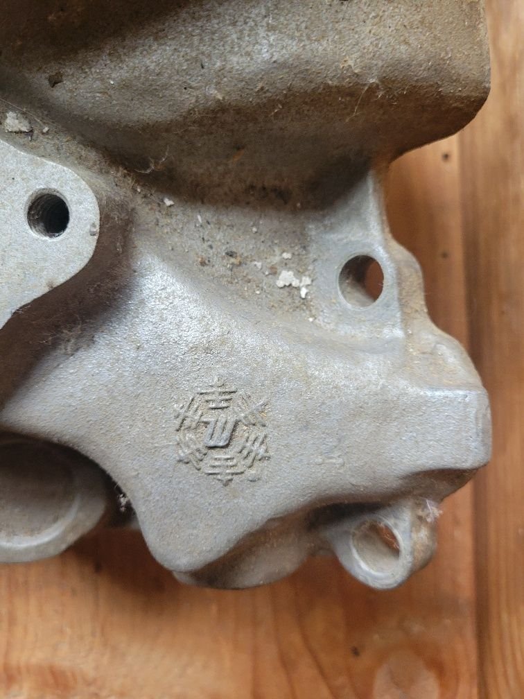

I'm guessing it was originally a 270 HP 350 since it has a Q-jet on it.
Looks like they bought an early LT-1 long block with heads and stuck the cast iron intake/carb, ex manifolds on it from the original engine. Pretty common thing to do. Now if they swapped the LT-1 cam for something else...it's anyone's guess if they helped you or not...depends on what it is. Same with head porting if they did any. You might be able to look closely and see if they used steel shim head gaskets like the factory did?
Upper right? I06 April of 71 14160
Yes, I read it as 11 71
My mistake I was thinking 70 instead of 71. July of 71 would be for MY 72?
Rear block numbers covered in grime. Original alu intake and Carb removed from car in favor of iron and Quadra jet back in the day! I have both original pieces. No casting date on the intake.
Sorry, upper right - was thinking C2 trim tags. Yep, April 6, 71 coincides with your VIN.
More than likely for a '72 since it's so late in the '71 production, but again, that sort of crank date is not typical Chevrolet and may be the rebuilder's date from the block swap.
Rear block numbers covered in grime. Original intake and Carb removed from car in favor of iron and Quadra jet back in the day! Have both. No casting date on the intake.
The casting date on Winters aluminum intakes is on the underside (maybe under the heat shield?).
