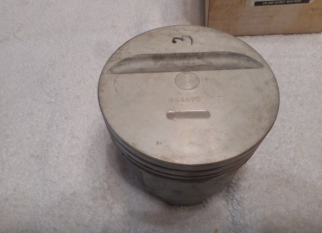

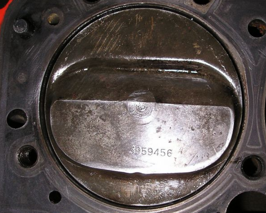

60s/70s era SBC OEM pistons are pretty identifiable by piston top shape.
Here is an original 1970 LT-1 pop up piston. Maybe 1/4
Here is an original 1970 LT-1 pop up piston. Maybe 1/4" high dome with a flat edge and a slot for the valve reliefs .Combined with the 64cc heads you got 11:1 C.R. I had these in my blue-printed '70 Z28, and after we decked the block some we got a true 11:1 CR. From the factory, with an un-decked block, they were about 10.7 CR. It seems Chevy's CR numbers were always .2 to .3 optimistic back then. That may be the setup what you have, with 64cc heads.
The 1971LT-1s lost the dome and became a flat top. Still forged. Had one long valve relief slot. Not eyebrows. Same forged piston used on all L82s. This lack of dome, combined with the 71+ up 76cc head chambers, gave about 9:1 CR with the big 76cc chamber heads. Upgrading these to the 64cc small chamber heads works extremely well and gives 10:1 CR.
The1969-70 L48 pistons were cast, not forged, flat-tops, and had either 2 or 4 valve reliefs. 10:1 CR.
The 1971 and up L48s had a deep d-dish depression in the piston top. And very low 8.0:1 CR. Their deep dish and lack of quench, gave detonation problems, even with the low CR. These pistons do not generally like being "upgraded" to small chamber iron heads, even tho the CR jumps to 9:1. They then like to detonate due to very little quench.

Old Jun 18, 2025 | 05:15 PM
Rebelyell's Avatar
Rebelyell
Joined: Jun 2025
Posts: 1,715
Likes: 597
This rebuilder/replacement piston (enginetech P/N P1505) is much more representative of the dished piston as found in '71-up low-compression L48/ZQ3 sbc.
It has 4 Valve Reliefs and its dish located in center of crown w/ very narrow quench band with a steep-wide chamfer; not D-Dish aka reverse dome.
FWIW, pistons' crowns in '96-up L31 Vortec truck motors are also similar to this pic's crown.

Old Jun 18, 2025 | 10:35 PM
leigh1322's Avatar
leigh1322
Old Pro Solo Guy
Posts: 8,088
Likes: 4,446
From: Marlton NJ
Yes those are much more correct to original than the d shape one I found. The quench band is a full circle, and very narrow, like 1/4" or so.

My boroscope skills are crap, (I can't seem to get the other side of the piston!) but from what I can see, they look like the first ones you pictured.

492 heads I believe were over the counter not factory but still 64cc heads which are the best original performance heads available back then.1.94 or 2.02 intake valves came in them ,as well could be had in angle plug.
Old Jun 19, 2025 | 04:56 PM
leigh1322's Avatar
leigh1322
Old Pro Solo Guy
Posts: 8,088
Likes: 4,446
From: Marlton NJ
Yep.
Sure looks like 11:1 pistons to me.

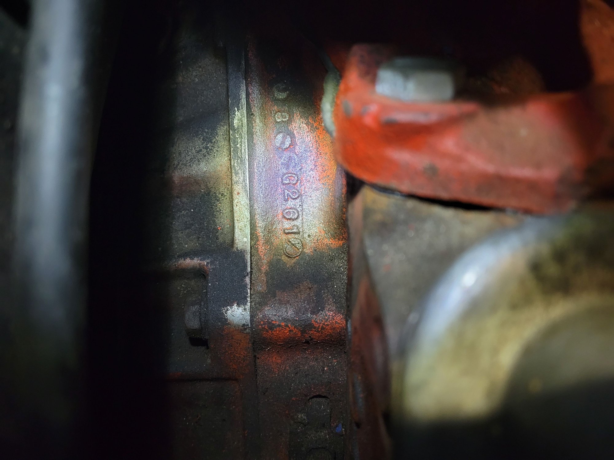

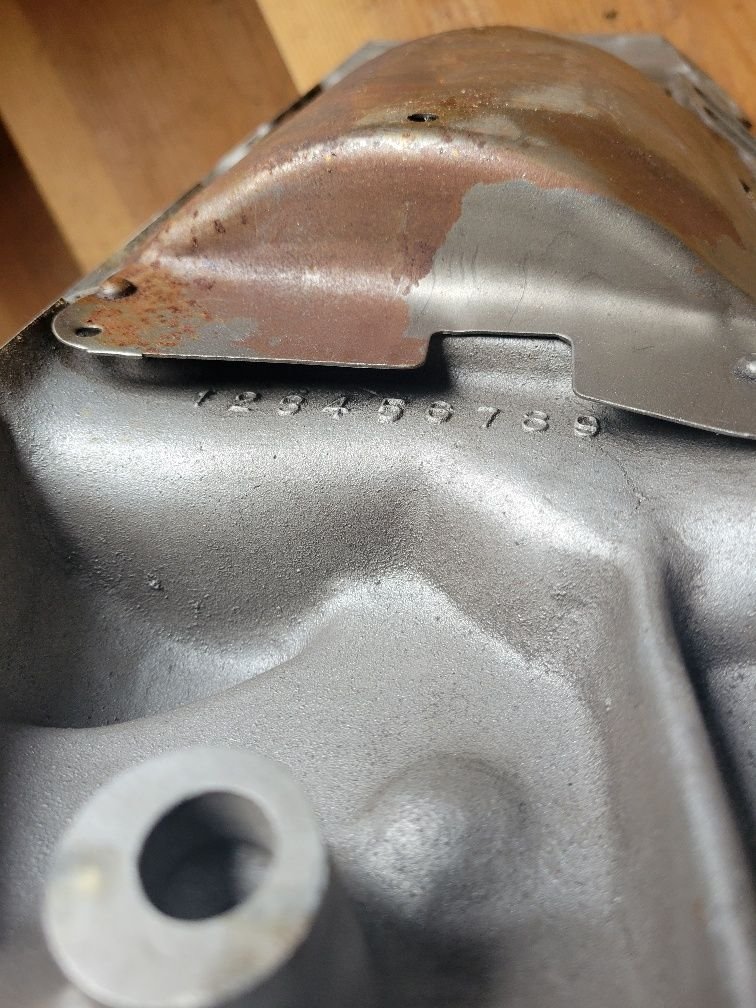

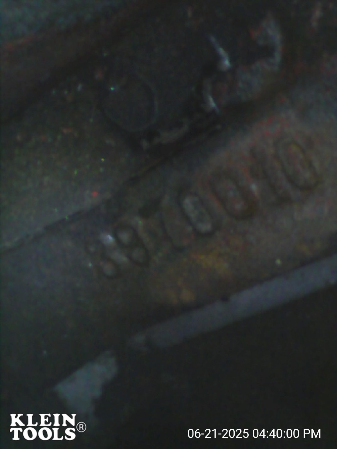

Old Jun 21, 2025 | 06:04 PM
  #35
fstntq's Avatar
fstntq
Joined: Sep 2011
Posts: 381
Likes: 90
From: Portland, the original!
[/Quote]What is the block casting number and date? (Located on the top of the block's transmission mounting flange - cast # on driver's side, date, I believe passenger side.)
I realize this is a lot of questions, but when you're trying to answer another you've got to look at all the clues.[/QUOTE]
Here you go. Tough to read =Drivers side, clear = pass side.
Old Jun 21, 2025 | 06:28 PM
  #36
Rebelyell's Avatar
Rebelyell
Joined: Jun 2025
Posts: 1,715
Likes: 597
FWIU
3970010 = casting number = very common 4" bore block, '69 thru '80, 2 or 4 bolt main, 2 piece Rear Main Seal
G261 = casting date = JULY 26 1971
*add* has medium size main webs to accommodate medium (~ 2.45" OD crank main) journals.
Old Jun 21, 2025 | 06:32 PM
  #37
gbvette62's Avatar
gbvette62
Joined: Oct 2000
Posts: 12,681
Likes: 3,134
From: Shamong, NJ
The "010" (last three digits) block is a very common block used for 350's from 1969-1979, and in just about every Chevrolet model. The date is July (G) 26, 1971. A block cast at the end of July in 71 would have gone into a 1972 Chevrolet, as most 71 models had completed "build out" by then (the last 71 Corvette was built on July 16, 1971).
Darn! Rebelyell beat me in with the answer. I have to learn to type quicker! LOL

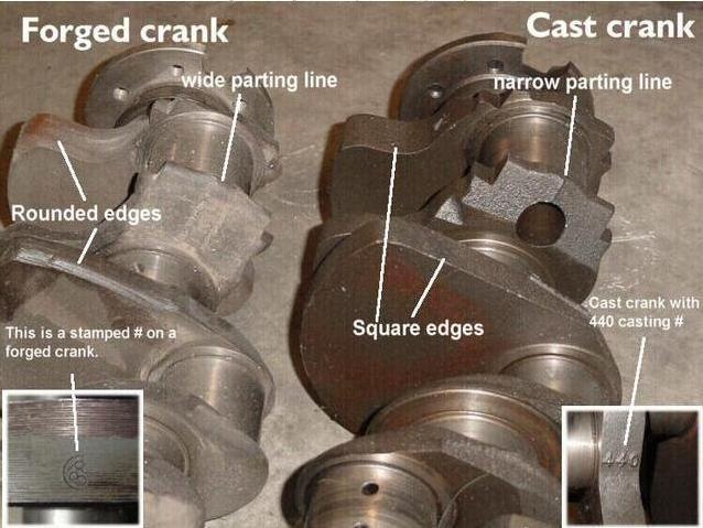

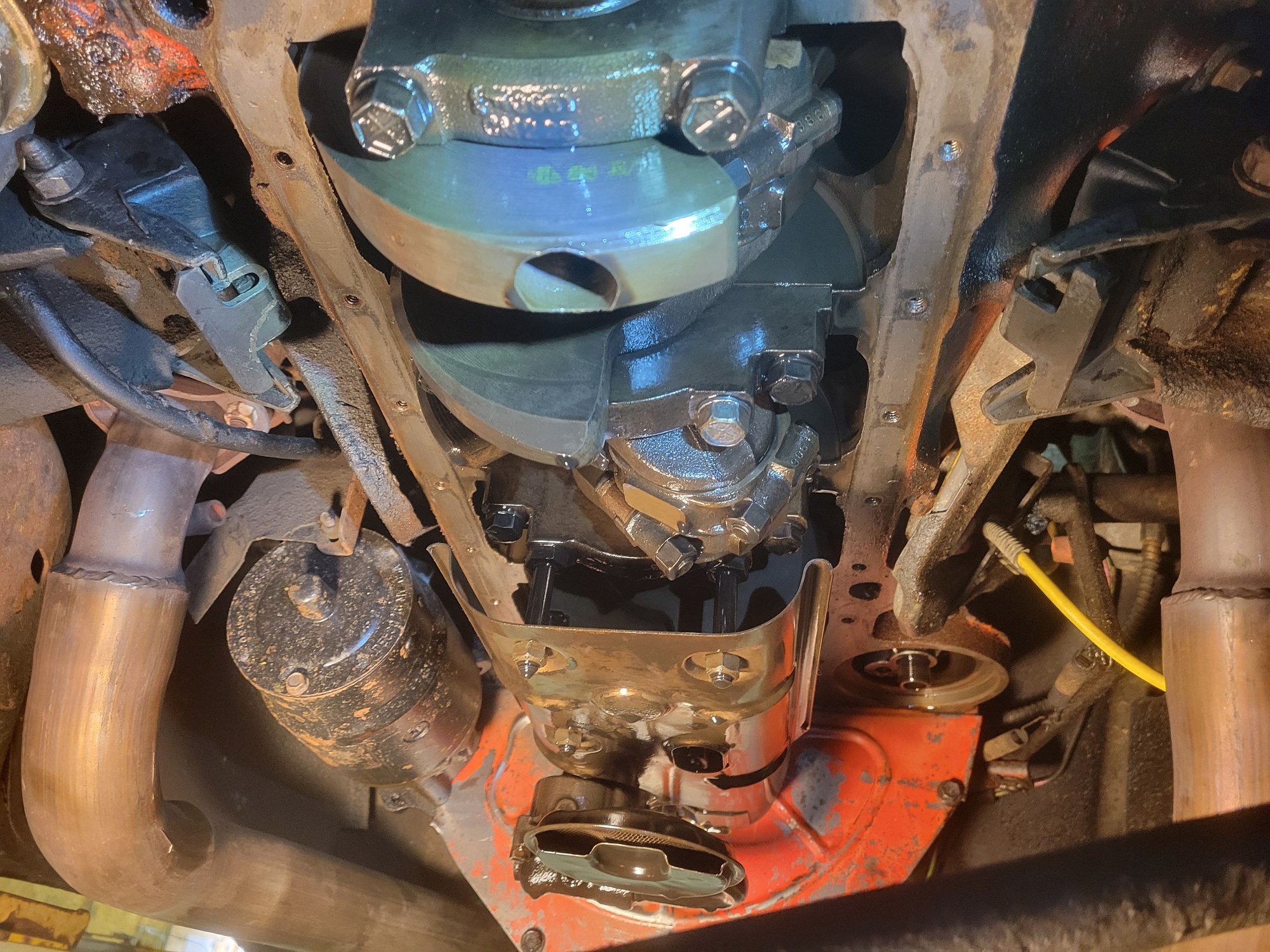

Since you have pics of the crank, can you get a pic of the main caps to see whether 2 or 4 bolts? An LT-1 block should have 4 bolts.
You could also stick a borescope thru the oil plug to see.
You might not be able to see the casting number of the crank, but I would bet you could see the LT-1 windage tray, and the casting part line on the crankshaft.
A thin part line means a cast crank.
A wide part line, that has been ground down, and looks like 1/2-3/4" wide, that signifies a forged steel crank, which an LT-1 should have.
A forged crank should also have an 8.0" diameter crank balancer on the front. That one is easy with a tape measure.
Old Jun 22, 2025 | 06:52 AM
  #39
fstntq's Avatar
fstntq
Joined: Sep 2011
Posts: 381
Likes: 90
....An LT-1 block should have 4 bolts.
As mentioned in the first post, it a 4 bolt main block. It has the LT partial windage tray as it has the later, smaller LT oil pan which will not fit a full windage tray. (Though it did have full windage tray main cap stand offs which were incorrect for the pan as well deforming it!) Crank weights look cast by your pix but parting line (and paint marks?) sure looks forged.
thx for all detective work.

Old Jun 22, 2025 | 11:38 AM
  #40
leigh1322's Avatar
leigh1322
Old Pro Solo Guy
Posts: 8,088
Likes: 4,446
From: Marlton NJ
Sure looks like a forged crank to me. Ground down parting line. Cast ones are really thin., so sharp they can cut.
As well as rounded off crank throws. Cast ones have will-cut-you sharp edges.
Windage trays could also have easily varied slightly between Camaro and Corvette LT-1s, because the oil pan varied.
And there were 2 different LT-1 vette oil pans anyway, the early 6 qt and the later 5 qt, with different length sumps.
That is why the early 70 C3 LT-1s could not be had with PS it would not fit, until after the pan change.
So 3 different configurations on oil pans alone. Just in 70. with the hi-compression.
A GM replacement hi compression block would have to allow for all 3. Likely be the reason for the unused long cap studs you found.
