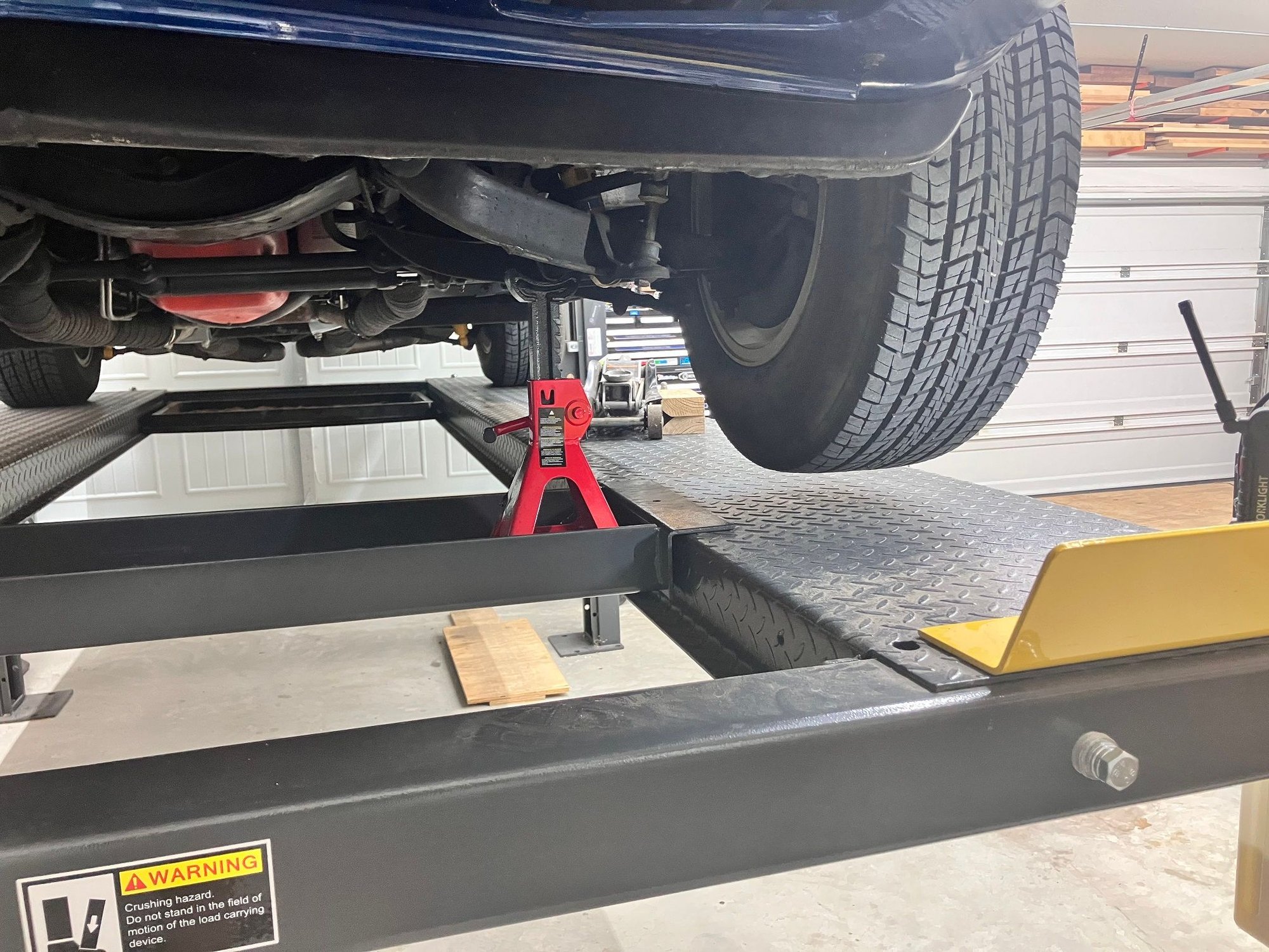

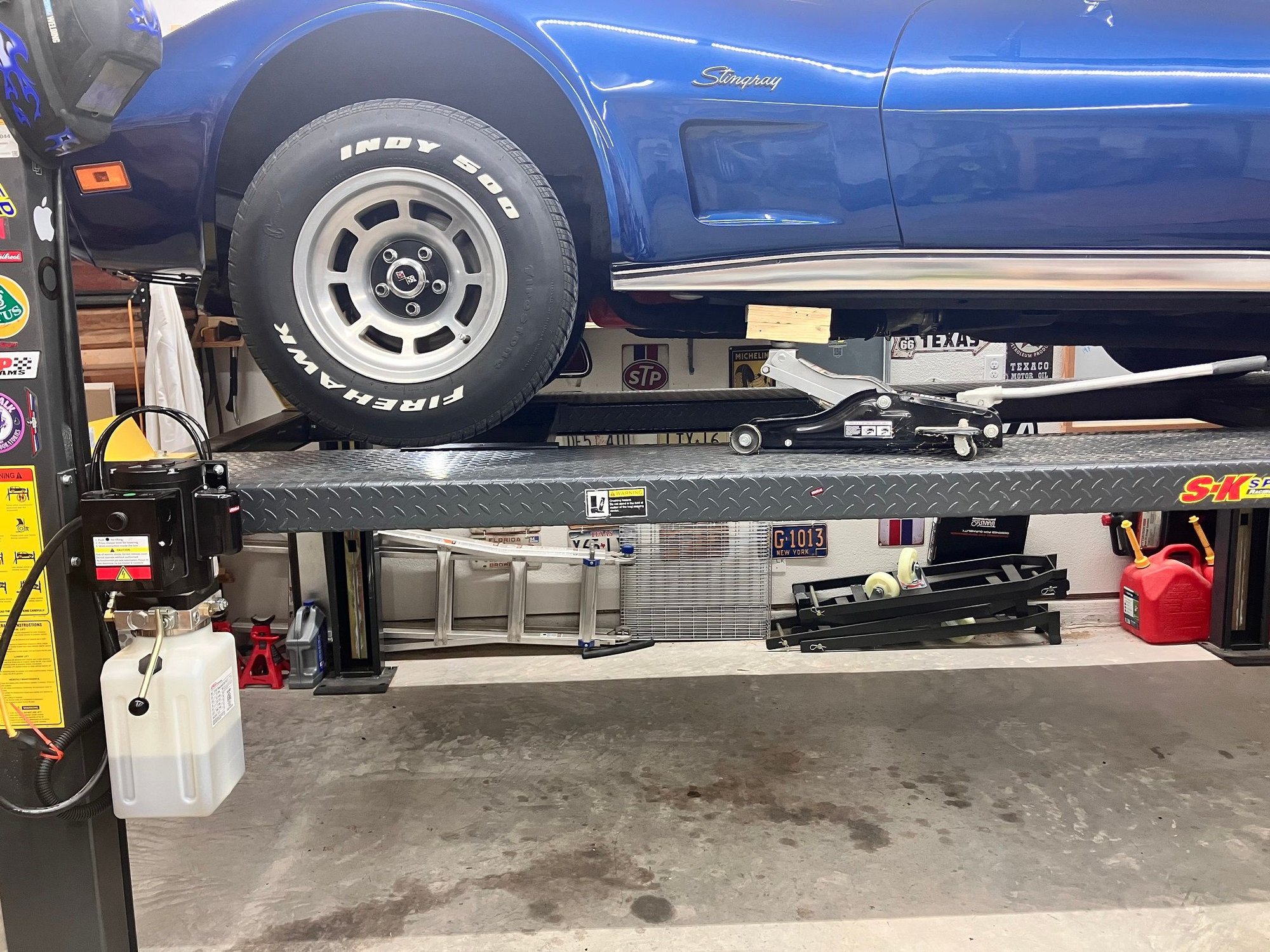

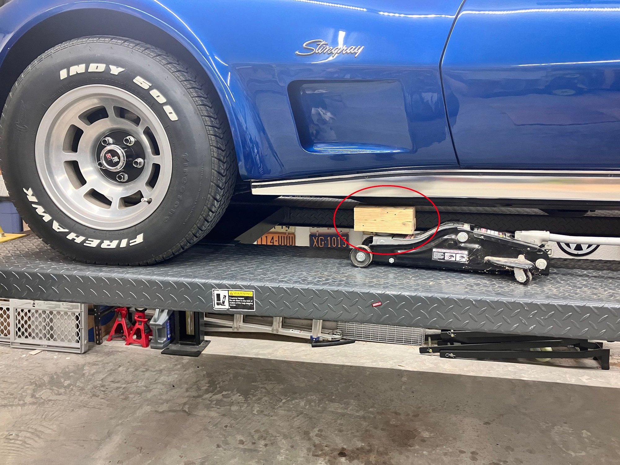

I use both low profile bottle jack and a small floor jack depending on what Im doing. I have the jack tray that spans the runways so I can jack the car up from the middle if needed. Im considering the scissor jack for the lift but it isnt cheep.

Making sawdust is my hobby and sometimes I make something useful
I totally understand the concern with floor jack creep. Normally what I do is use a block to close the gap to near zero so the creep of the floor jack is not a problem by the time the wheel gets in the air. Then I use the tray for the jack stand. Theyre small but still rated for 3 ton and they hold quite well. Although, your Wildfire is probably a wider lift than mine so this might not work for you. Hope this helps

Thanks so much for the photos, that makes perfect sense to use the block of wood. BTW, nice C3! I do some hobby woodworking as well and have made things like chicken furniture and dizzy bowls.
The Wildfire lift I have is wider on the outside but they are all the same inside width. I have 23" wide rails so I can get my C8 and C3 on there without any issues.
