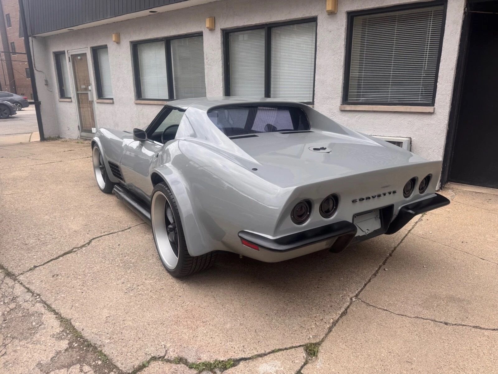

this will take a bit and I will keep you all involved from the get go with some picws, ideas, and problems I run into
always have craved the bumper cars again as I have had a few and despite them being old (like me), I grew up with these and they are still a beauty
well here's the canvas and the initial plan

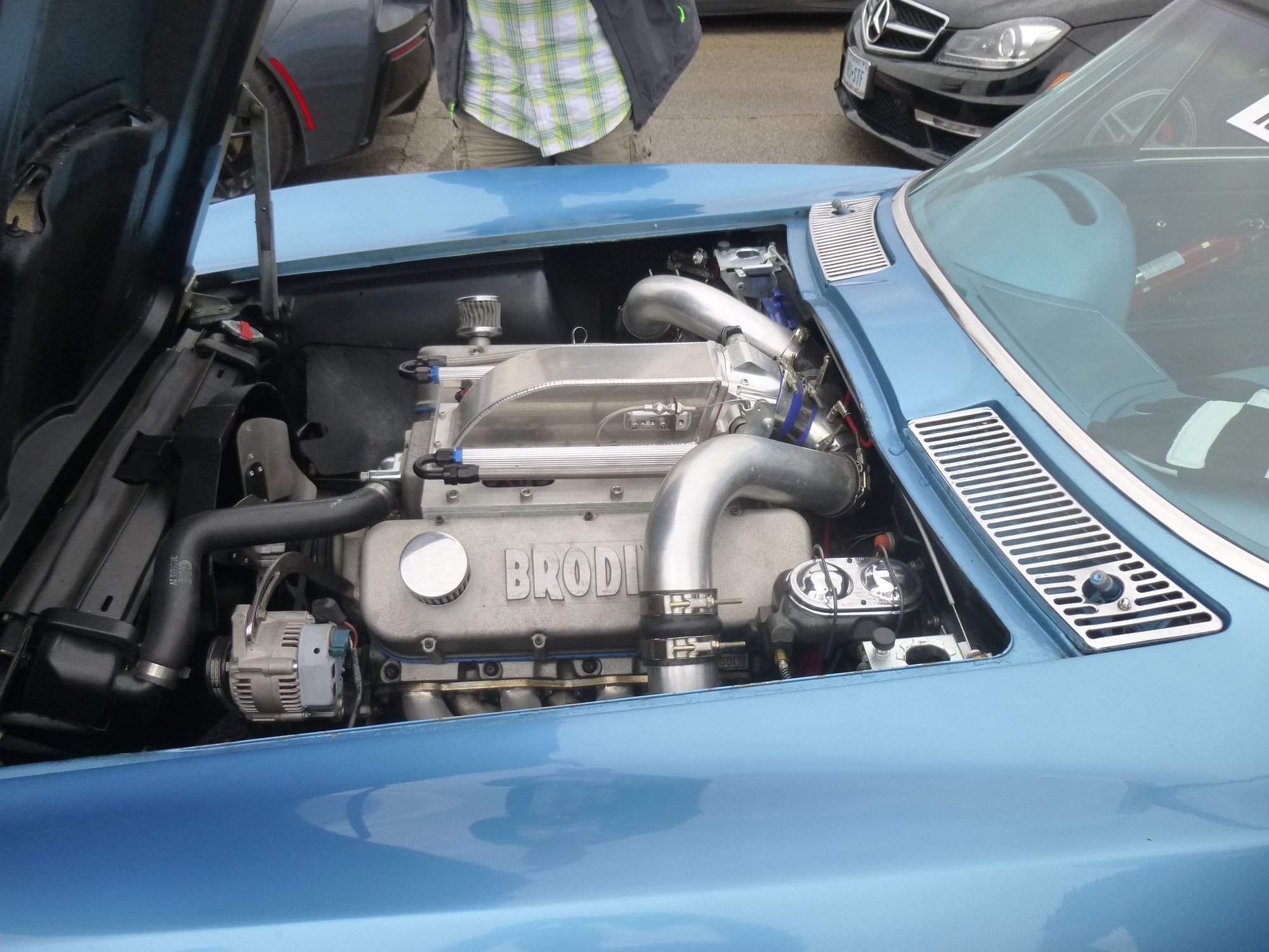

Very cool! Can’t wait to see the finished result. Here is a thread about a car with a twin turbo LS3.
