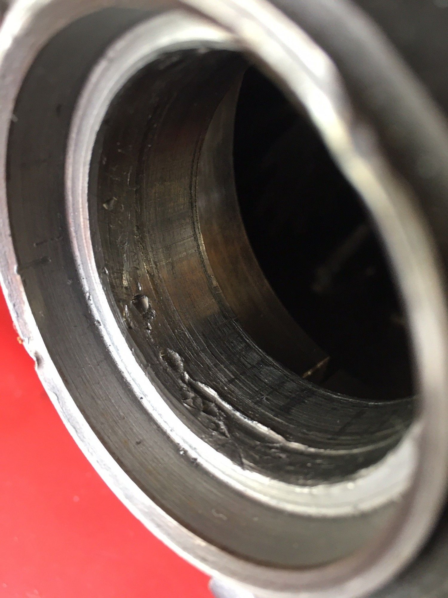

OK the bearing has been remove and here is the surface pictures show damage to the bearing seating surface. Is this repairable or need to replace the housing. I think you can resurface (smooth out) but there will be gaps in the surface.
or are there different repair methods that qualified shop would do ?

It appears the hole is still round, you can confirm with a simple snap gauge if you have one. The impacted areas can be carefully deburred with a Dremel tool.
I don't think I would machine that bore. If you don't have a snap gauge, deburr it and tap in the bearing from the other side. If it is a press fit still, you should be good.
Buy 2 new full complement bearings, a local bearing house can supply them. Use Loctite primer and #271 or #272 on the bearing and install it.
