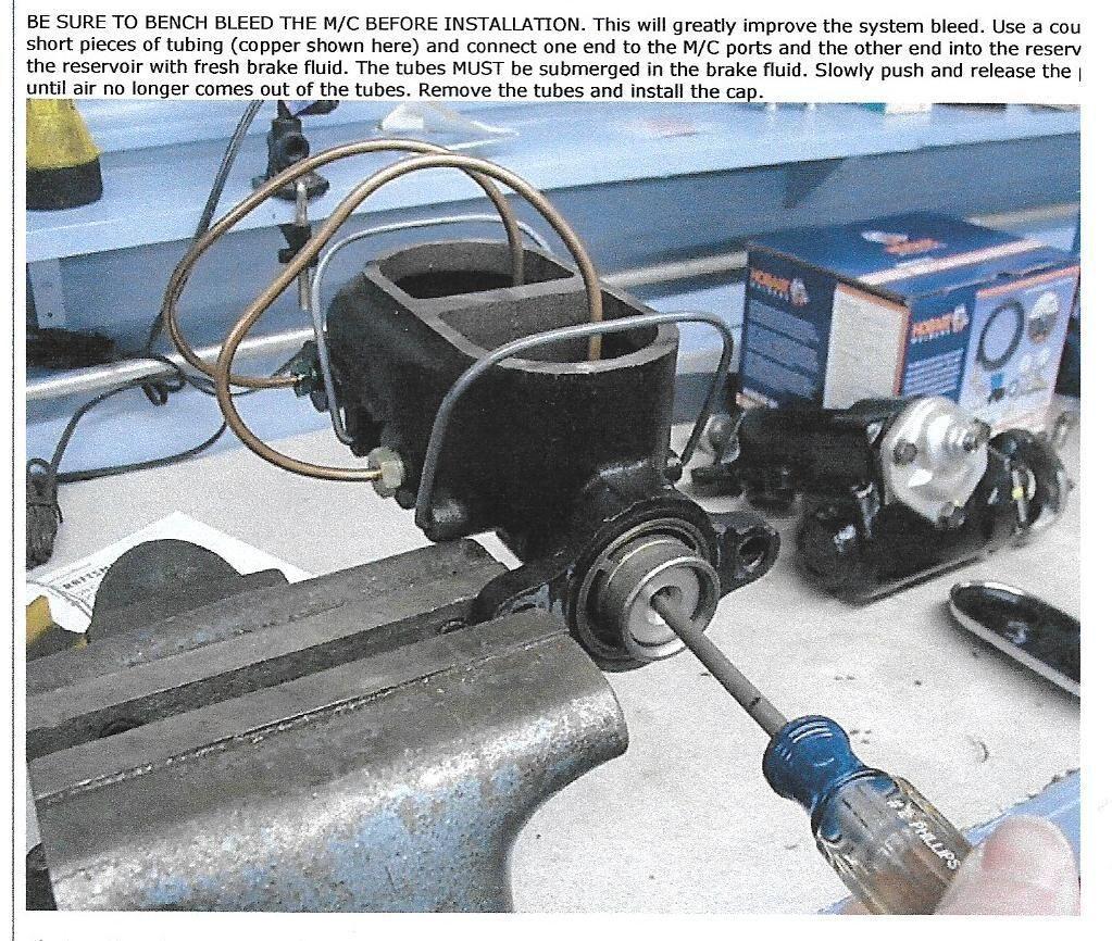

Used my old might vac we pulled fluid and air and it will not stop. Pedal still on floor. WE are sucking air from somewhere. How do you bleed a existing Master Cylinder 5 years old on car without a bleed screw on MC. This my next step, if this not clear the air i will remove caliper and split in half and hope it is the problem, but first MC Thanks for any help

Act normal, get a motive bleeder. You've most likely tripped the porportioning valve and pumping the pedal and gravity bleeding will not work. You can try stabbing the brake pedal to bring that proportioning valve back around... but you've dug yourself in so deep.
Bench bleed your master
Bleed your rear inners
Bleed your rear gutters
Bleed the fronts

You can do it while mounted on the car by disconnecting the regular brake lines and screwing in stubby lines that loop back to the reservoir (ends under the fluid surfaces) - just like in the picture. Raise the rear of the car so the master tilts forward - when done in a vise, the same forward tilt is recommended. The forward end of the piston cylinder is a dead-end tunnel and an air bubble can certainly get trapped there so that no amount of bleeding removes it. Use the foot pedal to push fluid through the master's ports and release trapped air.
c3-tech-performance/4000148-get-the-last-bit-of-air-out-from-the-brake-master-cylinder.html

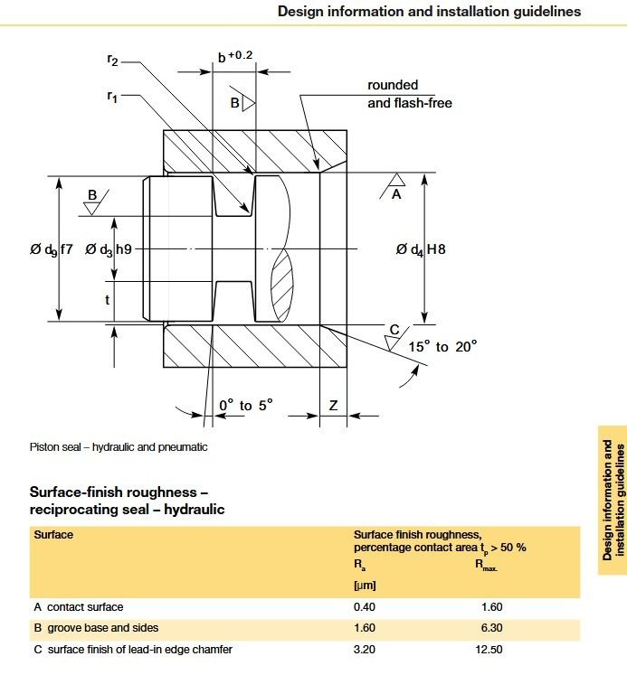

What reason is there for any scratch pattern? A scratch is a pathway for water to work itself in and behind the seal and for brake fluid to work itself out. Scratches would also be abrasive to any seal in there. We're not talking chrome-moly rings on a cast iron cylinder bore where you need the scratches to retain oil. The smoother the bore the better seal it's going to create with the rubber.

Here are the instructions from CSSB Inc. for their rebuild kits.
https://www.cssbinc.com/images/ads/h...structions.pdf
They don't say to refinish the bores. They say to inspect for scratches (Step 9). They also call out specific bore tolerances.
The spec for O-ring finish is different for a static application than for dynamic. If you have the ability to get a mirror finish, go ahead! It's probably easier to get new calipers, though. The SS sleeve bores are polished before the sleeves are inserted into the calipers.
The Parker O-Ring book calls out the surface roughness finish.
https://www.parker.com/content/dam/P...PTD5712-EN.pdf

[QUOTE=signify;1608895351]Used my old might vac we pulled fluid and air and it will not stop. Pedal still on floor. WE are sucking air from somewhere. How do you bleed a existing Master Cylinder 5 years old on car without a bleed screw on MC. This my next step, if this not clear the air i will remove caliper and split in half and hope it is the problem, but first MC Thanks for any help[/QUOT]
Here is how to bleed the MC while mounted on the car.
Get the last bit of air out from the brake master cylinder. - CorvetteForum - Chevrolet Corvette Forum Discussion
Once this is done then use a pressure bleeder mounted on the MC to bleed the calipers.
