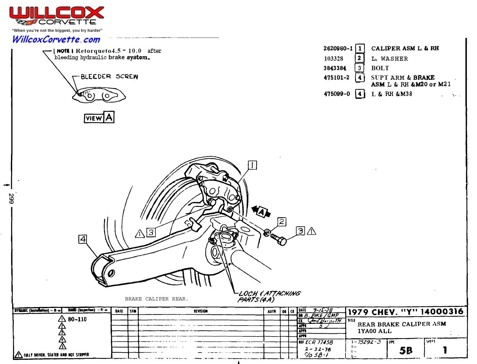

What is the torque for assembly bolts C3 rear

in assembly manual ..here is 79..cannot be that different for other years. in NM

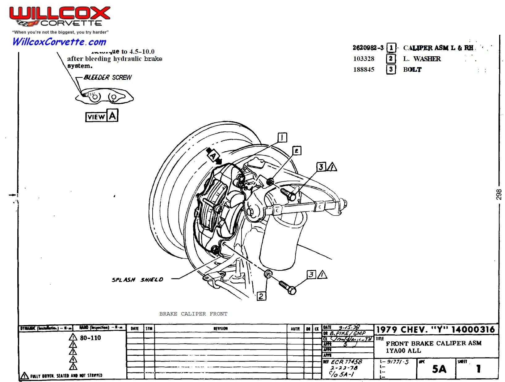

It's from the '67 service manual; copy/paste wasn't a thing back then, so who knows...
Here's the '72 service manual - which is certainly more in line with the comments here for mounting.

op pay attention to foot pounds and newton meters. The aim i posted is in nm.
so 80-110nm is around 60-80 ft #..
