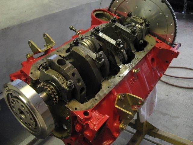

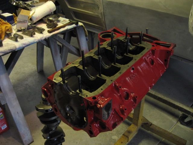

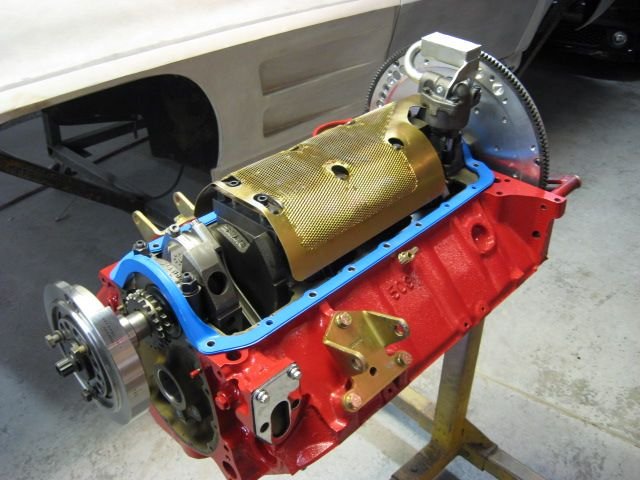

4-bolt mains are grossly over-rated. I run 2-bolt mains on a 500-hp 407 small block, and I shift it at 6800 rpm. A 400-horse engine will last forever with 2-bolts. Save your money - don't **** it away on needless, non-value-added operations.
