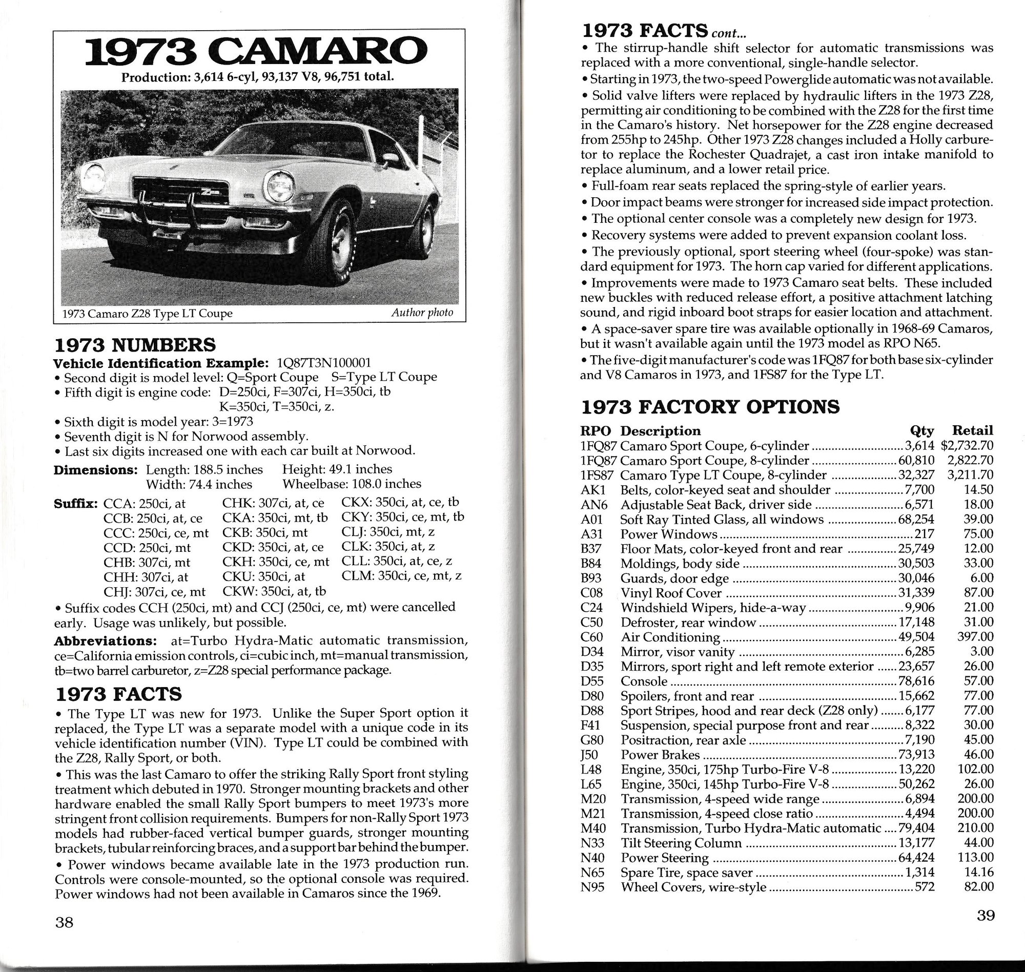

Here this will get you started when you know the codes on the engine....from the Genuine Camaro White Book.
