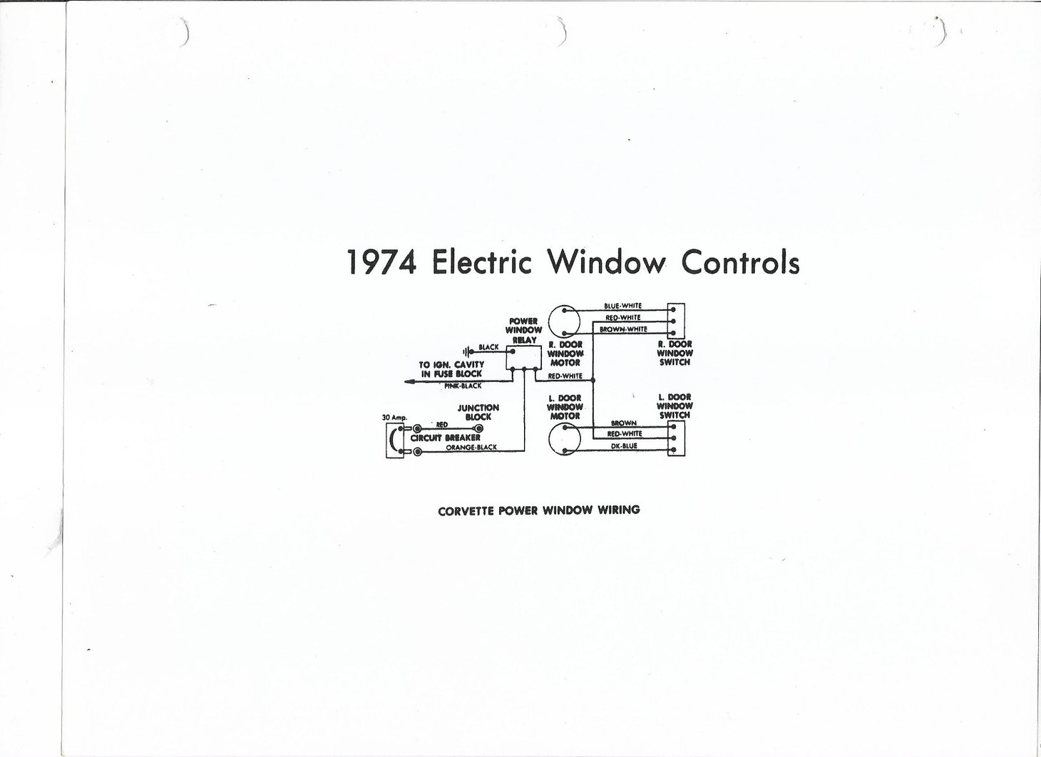

Make sure the pink/black is connected.
Check for 12 volts into and out of the CB.
One wire on the motor's two-prong plug is up and the other is for down.
Check wire connection between the switch and the motor.
