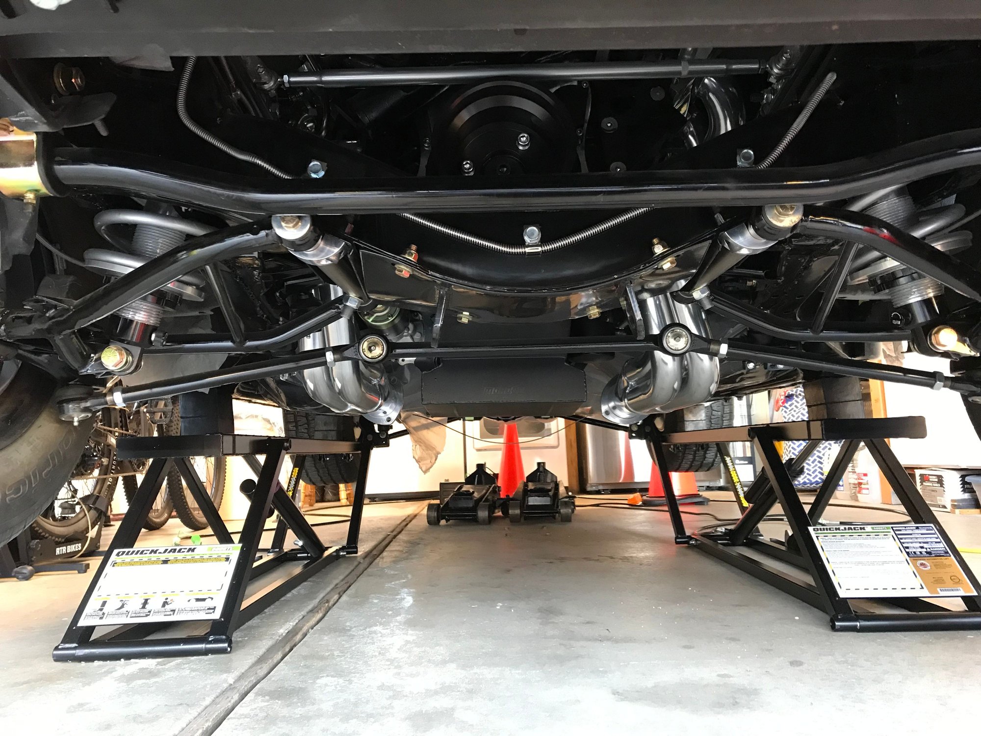

I bought three different sets of Hooker headers for my big block and each set fit a little differently.
I also bought two sets of Hedman headers and neither set fit.
The first set I purchased were already ceramic coated and I didn’t want to scratch them up.
The second set I purchased were the same model but were just factory painted.
I had to modify them to fit and give good clearance at the passenger side frame rail, the starter, and the oem steering box.
After I got them to fit I had them ceramic coated and they were perfect.
I also purchased a set of Sanderson Short Tube headers that were better quality that the others and they fit with plenty of clearance and without modification.
I really wanted the long tube headers, but honestly I liked the Sanderson’s better because of the difference in quality.
Another important thing to consider is ground clearance which is greatly reduced with any long tube header.
The Hookers hung down lower than the Hedmans.
I posted an entire thread with all the issues I had.
In the thread it explains the best technique to modify the primary tubes and please don’t use a hammer.
Heat and rolling the tube with a wood baseball bat makes the beautiful.

None of the Hookers even came close to fitting.
The drivers side fit with one set, but all three needed a tube to be cut out and rerouted to clear the idler arm.

American Racing Headers make a great header, but you’ll pay over $3k.
When I called them they told me they won’t guarantee fitment unless they build them on the car, they are stainless steel which put off a lot of heat and painting or ceramic coating them voids their warranty.
They are great for race cars but the heat issue makes them not so great for street cars.
