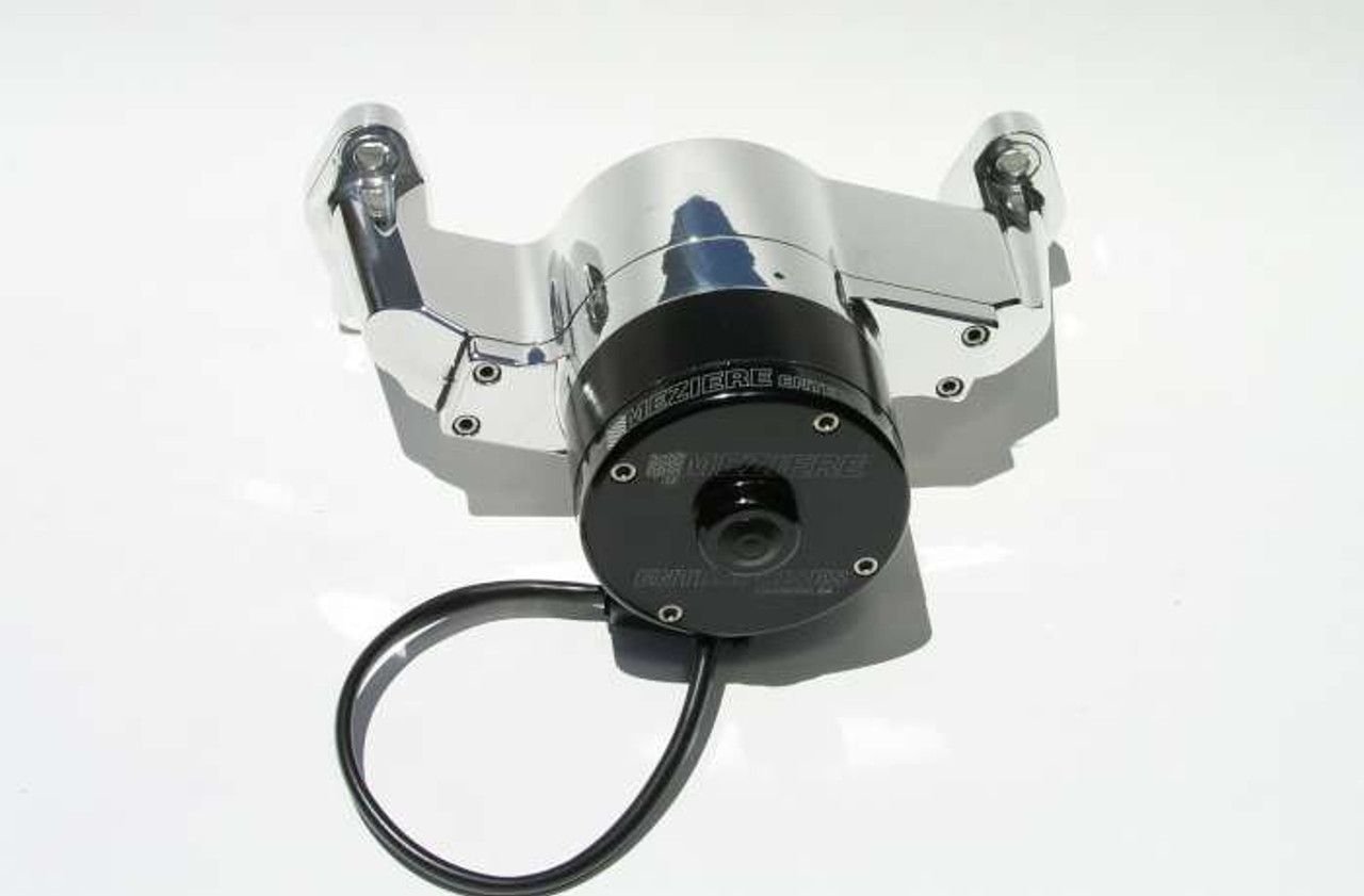

Just to throw another suggestion into the mix. Since you already plan on electric fans have you looked at an electric water pump? Some people question their reliability, but those that actually own and use them seem to like them. They come in all sorts of colors, and might be a bit of an upgrade to the cooling system too.
That is the electric pump I use on my SBC
That is the electric pump I use on my SBC. It has been working great for over 5 years so far. I don't really drive the car much, but I'm totally satisfied. But before the electric pump, I used the Edelbrock #8812 aluminum sbc mechanical pump......perfect for Corvette. I think it has been superseded by a new part number now. This.......https://www.summitracing.com/parts/e...FwwVLOJDFPoTKF
Additional Info: If you have a 1969-70 Corvette, the Edelbrock #8810 is listed (Why ?) This.....https://www.oreillyauto.com/detail/c...olet-corvette? The #8812 is listed for '71 and up.
Hmmmmm… now you’ve got me thinking! That looks super nice. I guess it would then just be a belt change to run the alt and power steering, with no worries about a pump alignment issue. Interested indeedy! Would free up even more ponies. Thanks @Piersonpie and @C3 Stroker !!! That might just be the ticket. Love how it’s got both the polished and the black that I want.

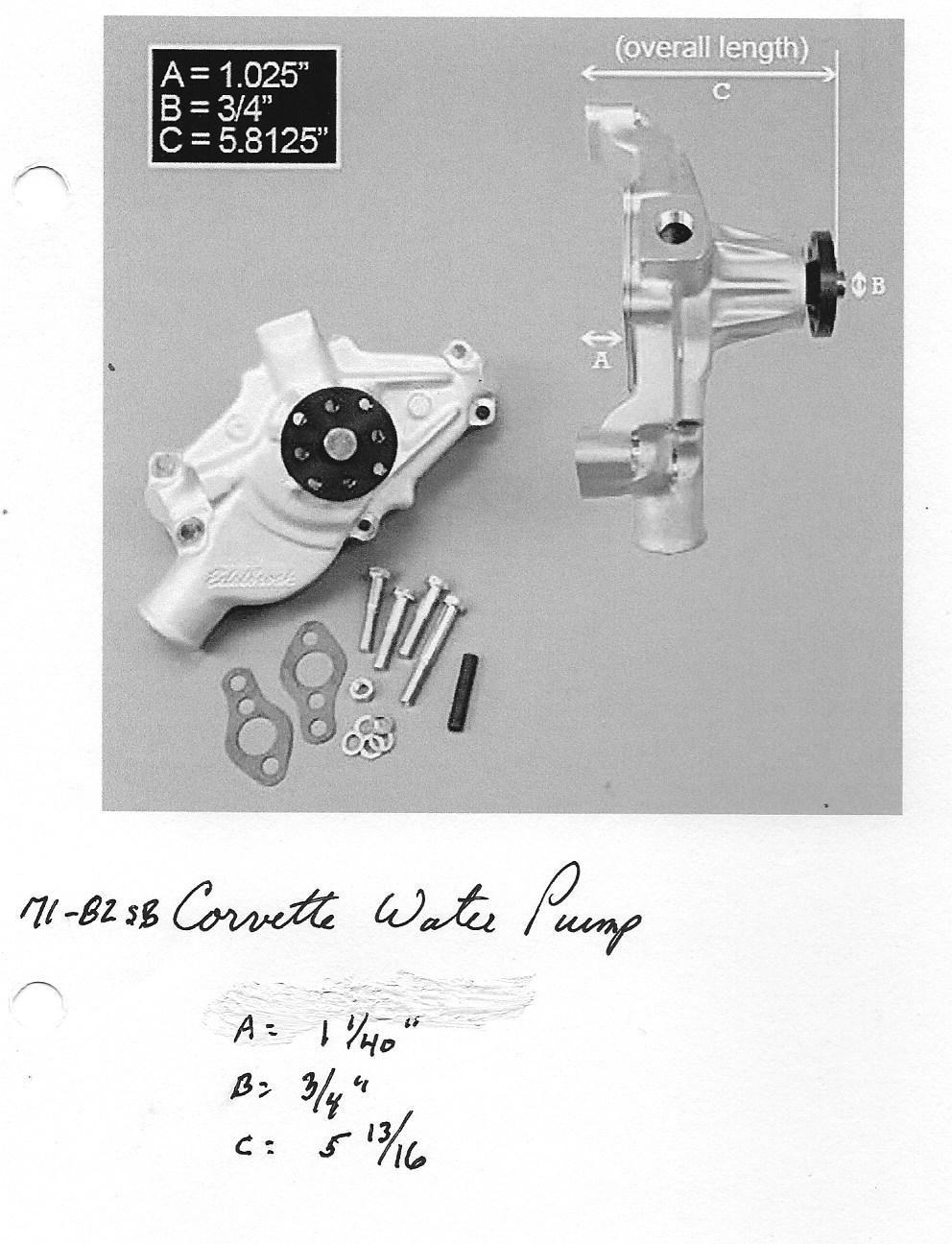

Courtesy of Peterbuilt

Thanks for those specs @sunflower 1972
