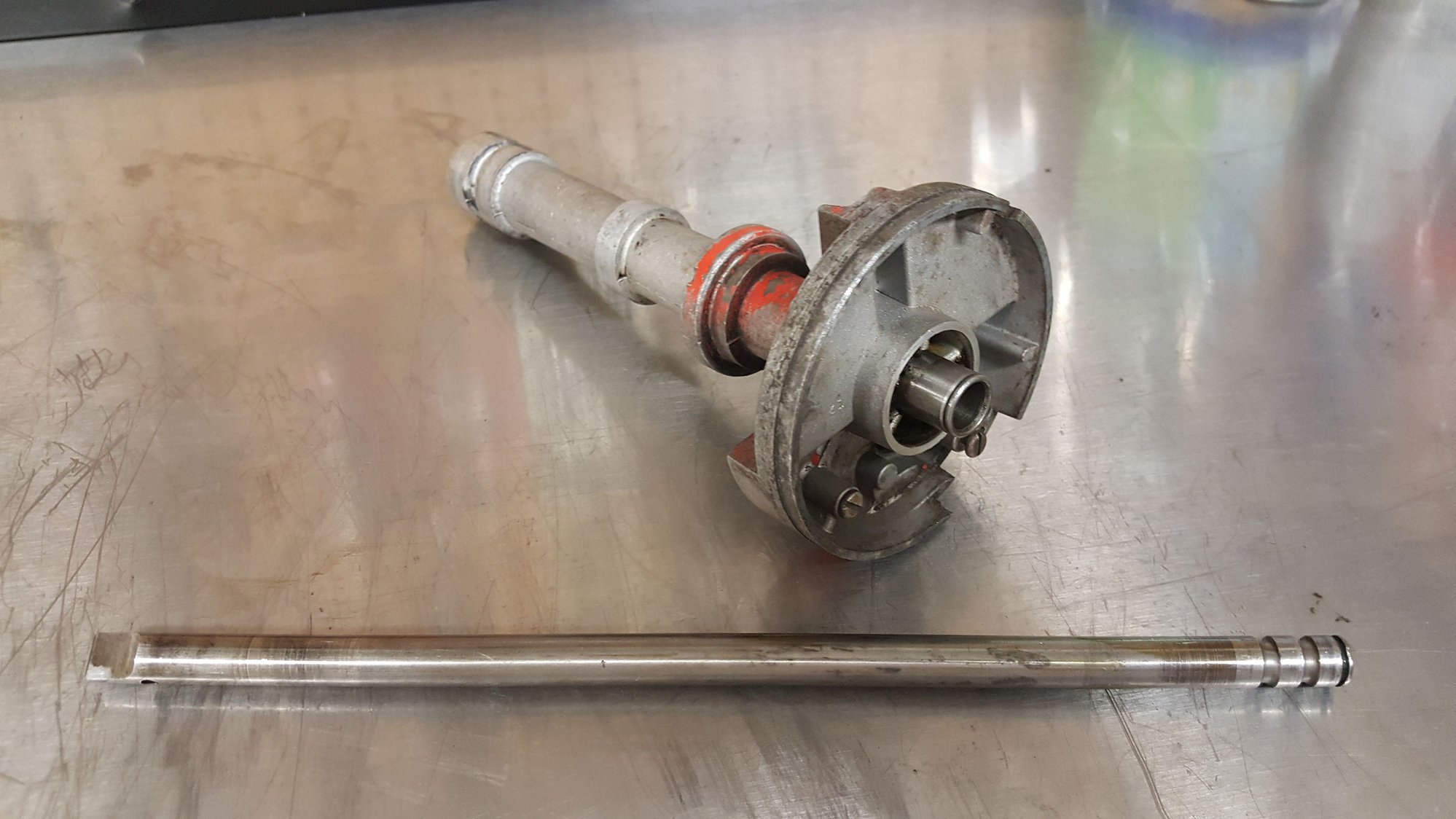

Originally Posted by 3x2
my thoughts. Grab a used or really cheap distributor and remove the gear and pieces leaving only the body ann shaft. Most priming tools do not seal the passages in the block.
^^^this^^^
Genuine GM/Chevy fits best; my priming tool is an old modified Chevy points dist. It fits-seals as it should.

Originally Posted by 3X2
My Thoughts. Grab a used or really cheap distributor and remove the gear and pieces leaving only the body ann shaft. Most priming tools do not seal the passages in the block.
All right - I'll try to get my hands on an old distributor. In retrospect, I should have spent my money on that instead of ordering the ARP tool for $82.

I see a lot of people grinding the teeth off the gear. No reason to do that. Just pop off the gear/ shims and rip off the top plate. Done.

Default It's all good
Well x 3. After putting everything back together, I gave my original priming tool another try. And oh surprise, all 16 rocker arms started to seep oil! I could clearly see it come out of their little hole above the pushrod. I think it was user error from the start. This time I let the drill go for longer before rotating the crank a bit, and I believe that made the difference. I feel like I wasted your time. Sorry about that.
Intake manifold installation planned for tomorrow!
and appreciate your frankness; too often in short supply
perhaps that rotation timing was key
not a waste; brain practice !
