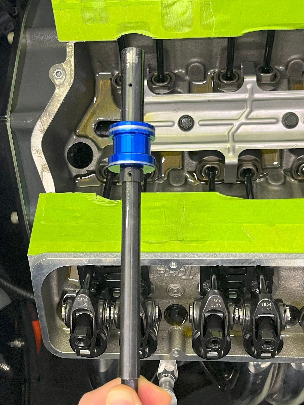

Hard to tell in the photo,
by the way. That's not a C3 is it?
but your priming tool does not appear to have a collar.
There are two kinds of primers. The better ones have a collar that would normally fit tight in the Intakes dist hole.
Without that collar, I believe the oil pressure is by-passing the lifter-oil-galley. It may show up on your gauge as 75 lbs, but may not be feeding the galley.
I would not install the Intake just yet until you figure this out.
However, I would install the Intake WITHOUT gaskets, just lay it on the heads / block, couple bolts.
Then try the primer tool again. Or buy a different type specific for the hole in the Intake.
Getting adequate oil pressure from that port in the block does not guarantee pressure at the lift bores.

Thanks HeadsU.P.! It is my C3 corvette:

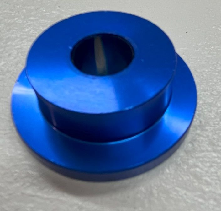

This is what my tool looks like:
I have not been using the top collar because the intake manifold is not installed.
I believe the lifters at #8 are the last ones to get oiled. I also read that it's when they're on the base circle that they are subject to the pressure - so I'll concentrate on that position.
Dry fitting the intake and drilling again with that top collar installed sounds like a reasonable experiment. There's a huge play between that collar and the intake's hole. The collar diameter is about 3/16" smaller than the intake's hole:
I could put tape around the collar, so it just fits in the intake and is centered.

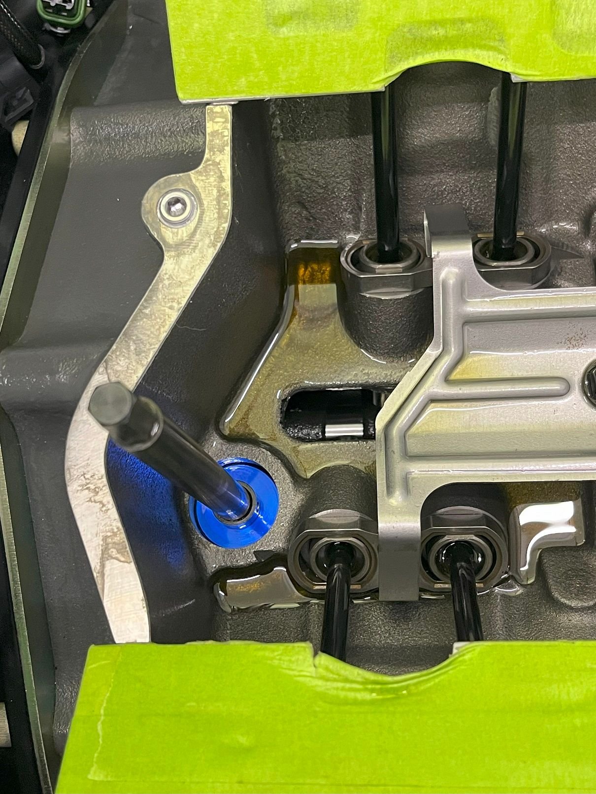

Not an expert on oil passages down inside the distributor hole.
But perhaps the way you have the tools collar shoved down in there its blocking an oil passage.
The distributor itself does not have a full collar like the primer tool, but rather a "stepped" collar.
I think you should "dry" fit the Intake and try the primer tool again, in the way it was intended.
Note if oil starts flowing better.
Nothing to lose, everything to gain.

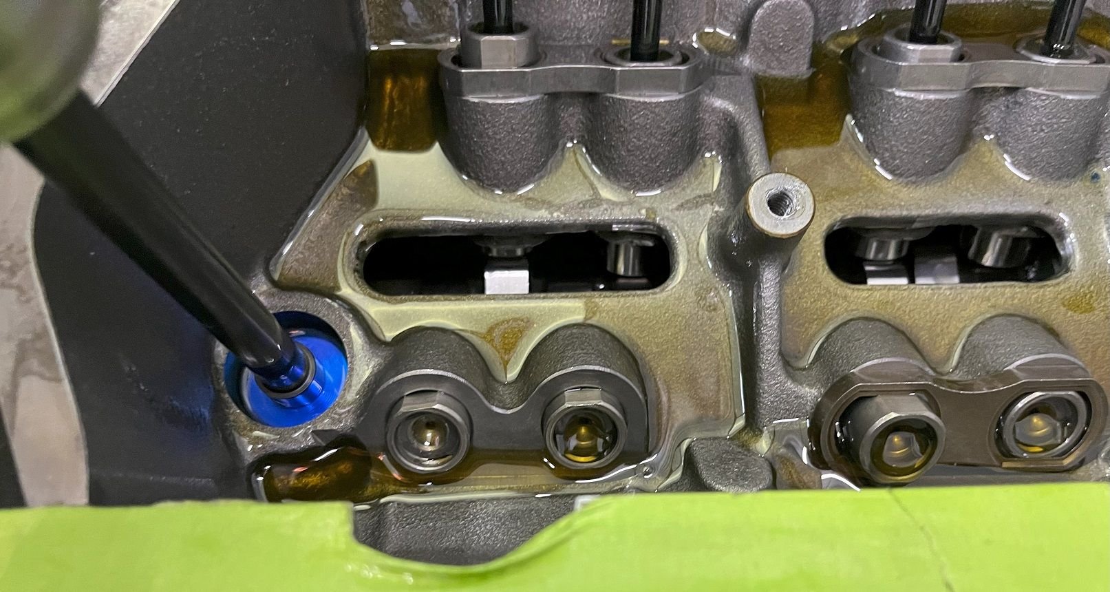

Thanks all! Agree with Rebelyell - there's no way the upper collar does anything more than keeping the tool somewhat aligned.
Just quick notes on what I had time to do tonight: decided to remove the spider retainer. Removed one #8 lifter and placed my finger in its place. Could feel the oil pressure coming out of the supply hole while I was drilling with the other hand. Did the same with the other #8 lifter: same result. So I could feel oil pressure with my finger in both lifter holes. Yay!
With all lifters back in place, drilled some more and could see a little oil coming out of the #8 tops. Less than for the other lifters though.
Swapped lifters from #8 and #6. Drilled again: exact same results. Conclusions of the evening: oil passages provide oil to all lifters. Visibly less at #8. No lifter problems detected at the moment.

In the Dart SHP SBC engine, the oiling system feeds the lifters from the front of the block to the back. This means that the rear lifters—those at cylinders #7 & #8—are the last in line to receive oil during priming. This is the opposite from an OEM SBC where #1 & #2 lifters are fed last.
Anyways, I only had time to:
- swap the #8 lifters with ones from the driver side.
- orient the 16 lifters so that their little oil feeding hole is pointing to the front of the engine, where the pressured oil comes from (I don't know if this makes a difference or not).
- reinstall the spider retainer with blue loctite.
- order the ARP 130-8802 Oil Pump Priming Shaft.
I will re-install the pushrods / rocker arms again and set the lash. Then, once the new tool has arrived, we'll see how things go.
