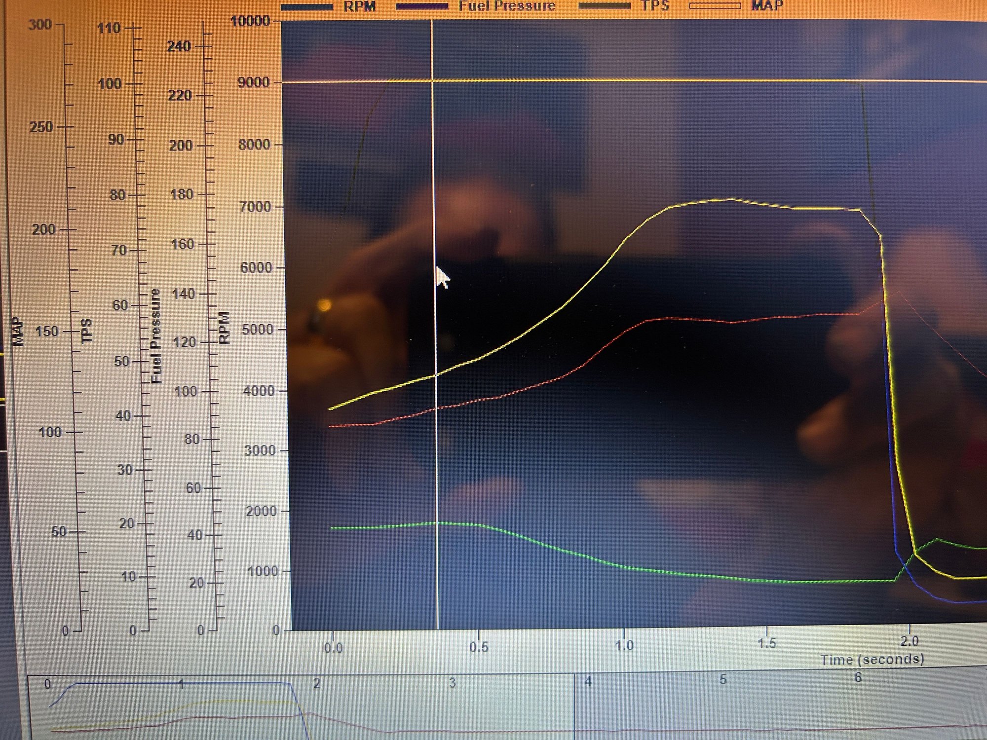

Thought it would be interesting to post just a little of what you can do with some of the modern EFI systems with data logging. I have the Holley Dominator EFI on my car. For reference, it's got a twin turbo 555" big block.
So it hasn't been running great for a while now. When you stuff your foot in it....it's not happy as it builds boost....it will start to pop and lay over.
I thought I knew what was going on since I've seen it act similar when testing on the chassis dyno. It's got two Aeromotive A1000 fuel pumps. One runs when just riding around...but one alone can't handle things when it builds boost and needs a LOT more pressure and volume. So when it's "party time" I throw the toggle switch to turn on the 2nd pump. I "could" have it activated with the Holley EFI...but I never changed it over...I just have them both wired to a two position toggle switch.
Anyway, I also thought I'd heard one of the pumps make some funky noises a couple of times...but of course it never does it when you're checking it.
So I took it out and poked it a few times for a couple of seconds and let the Holley Data Logger keep track of what's going on. When I got home, I downloaded 4 logs and they all show the same thing.
Might be a little hard to read as the colors might not be clear...but where I have the white cross is on the blue line for the TPS reading. As you can see it's reading 100%, which corresponds to the 2nd column of numbers on the left. This shows I had my foot on the floor right there.
The yellow line is the MAP sensor reading...which is boost. It shows 212 KPA which is about 16 PSI. (Gotta remove ambient pressure).
The red line is RPM. which is showing between 5100-5200 RPM or so while I had my foot in it...which is the exact range it shows the issue on each data log.
Now the BIG issue is the green line. That's fuel pressure. On the left side it's running around 43-44 psi which is about right because it's running naturally aspirated there and there's vacuum running to the fuel pressure regulator to reduce pressure. BUT...as it starts to build boost....the vacuum turns to boost and RAISES the fuel pressure about one pound per pound of boost. So, when it's making that 16 PSI of boost it should be putting out AT LEAST 55-60 psi....and keep rising as boost climbs. As you can see...it tries for an instant to increase...but then it starts DROPPING to around 18 psi!! You can see how it immediately starts dropping as boost goes up.

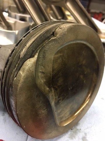

This is how you melt pistons and blow-up engines! In fact I've had it happen once before on this engine when a pump died at the track all of a sudden. BTW--I have safeguards in it now to pull all the timing out if it drops too low (tested that today too).
I'll do some more individual pump and regulator testing to determine if it's just one real bad...or two of them getting weak. Or a messed up fuel line or whatever. Probably time to box 'em up and send off the Aeromotive for rebuilding either way.
Just for fun...even with it running bad...from the time I hit wide open throttle to the time it was making 16 PSI was about .9 tenths of a second. I don't mind telling you....a LOT happens when you double the amount of air going into an engine......555" all of a sudden thinks it's about 1200 cubic inches!! It happens even quicker when it's got slicks on it and the tires don't spin...and when it has fuel pressure and even quicker when I have the timing cranked up for good fuel. Those little turbos don't have any lag to speak of!

I would suspect the fuel pressure regulators as you stated. Do you have data of a good run and compare what's happening now?

Ya, that piston has seen better days. Back in the day when working on small Cessnas etc. we'd get the occasional burnt piston (mostly on turbo aircraft engines, go figure) and we'd use them as ashtrays. I eventually quit smoking.

You'll find it. I'm taking side bets your party time pump is not coming on.
I like running one big pump instead of two. I pwm it for cruising and full power when boosted.
What size injectors? What fuel? Can you add an AFR line to the chart? I'm curious how that got affected.

Thanks for sharing the information. Data logging by itself is the single biggest asset to aftermarket EFI systems. I run a data log every time I drive triggered from an increase in fuel pressure. This has allowed me to troubleshoot when needed.

i'm with 2xtrouble. Your AFR should have gone pretty much sky high when the pump or regulator quit running correctly. As you already know, going lean fast usually means boom. I think you will find the issue for sure, GL.

Sorry guys...I left the laptop out in the shop and forgot to pull a new image with AFR...but yes...it went lean. I only let it go for a quick second or so.

When it had the old filter in it with both pumps running it showed a steady line of 12.7V-12.8V. No real movement whether pressure was running at 43 psi or 18 psi.
It shows a pretty steady 13.0-13.1 with both pumps running with the new filter from 43 PSI to 60 PSI. They liked that.
Fuel pumps like voltage...probably need to look things over there too just to help. They have separate relays within a few inches of them and heavy wire feeding to them.....but I need to check the switch for voltage drops as well as alternator capacity. It's a small Nippondenso unit.
Back to O2 readings....when it was barfed...it would immediately start going lean as pressure went down and boost went up. It spiked 18.4 for an instant at the worst. Started in the 12'ish range and hung around 14'ish for a bit but when it started breaking up it spiked to 16'ish and I'm sure gave all sorts of funky 02 readings at the time. It shows pretty ragged as it banged around a little. The whole timeframe of the test was about 3/4 of a second.
Tonight, the same range stayed in the 12.0 to 12.4 range.
