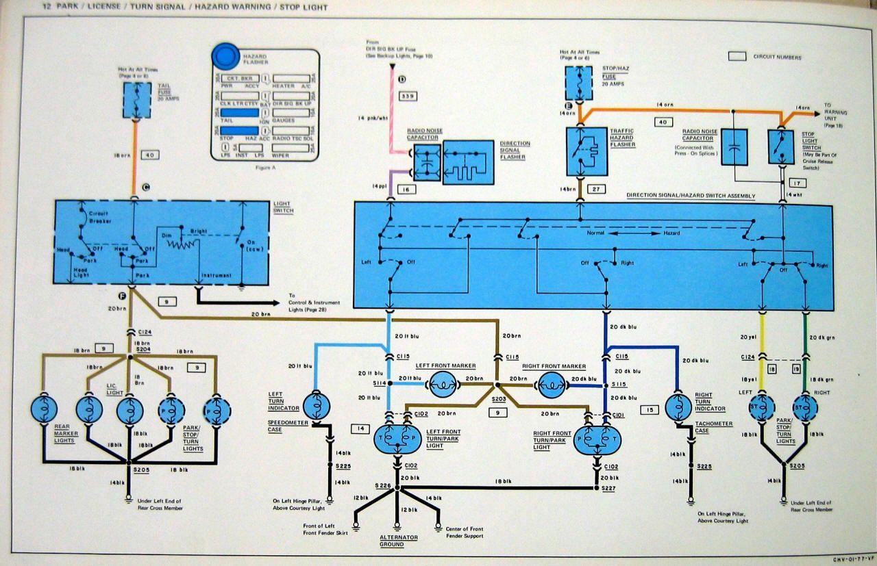

Check if the white wire has continuity with the green and yellow wires
Great diagram!... That's a big help
