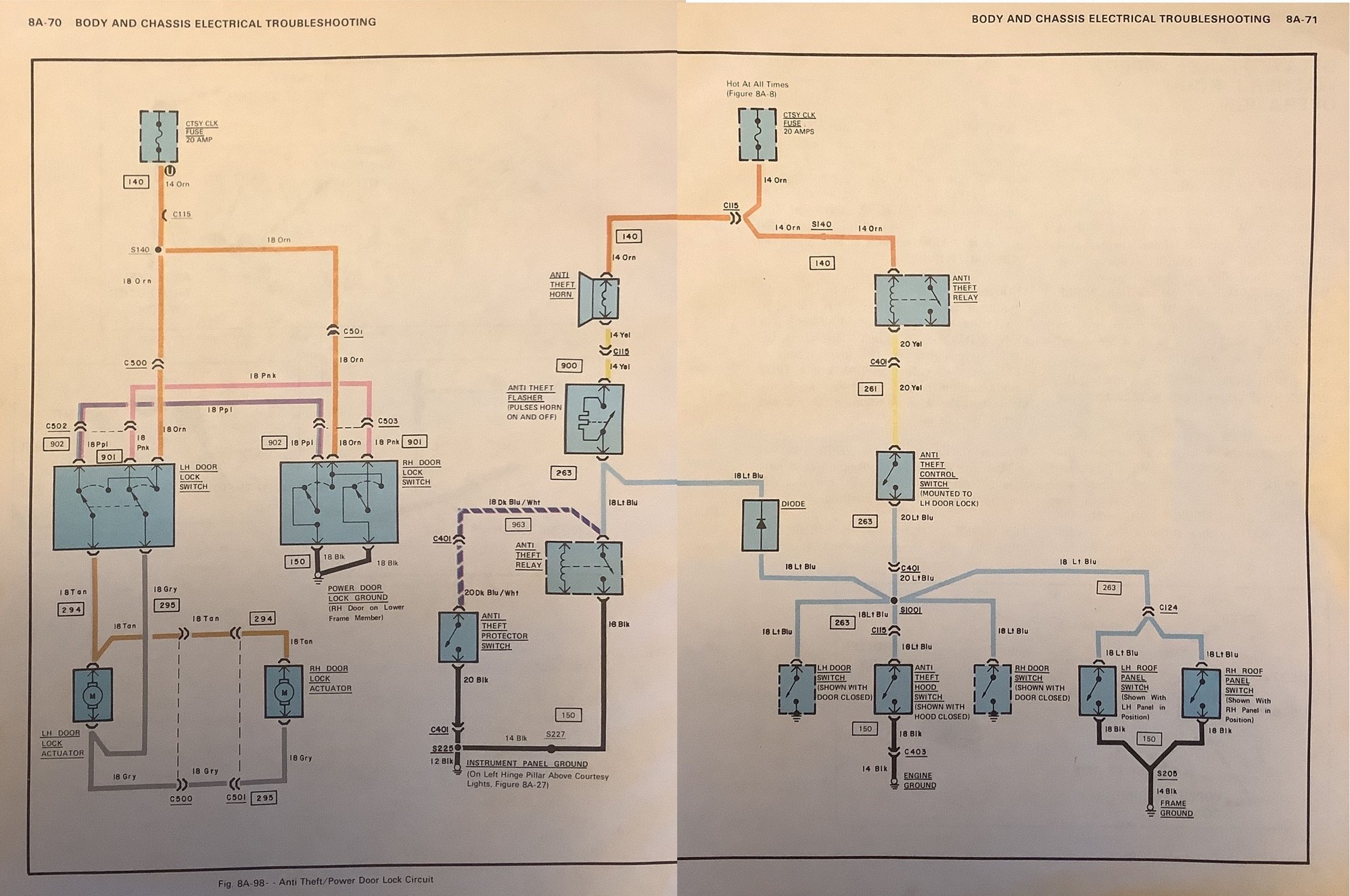

Here is the 1979 factory Corvette Alarm circuit.
I see NO kill switch...
Pick up a copy of the 1979 Corvette Service manual, you can find the originals on e-bay
