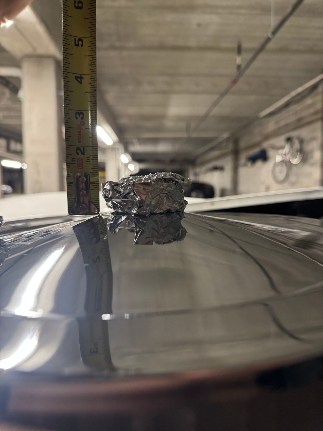

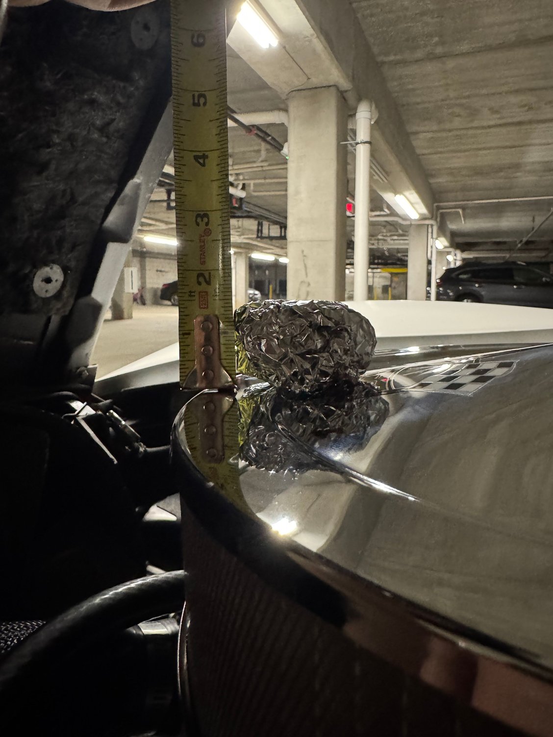

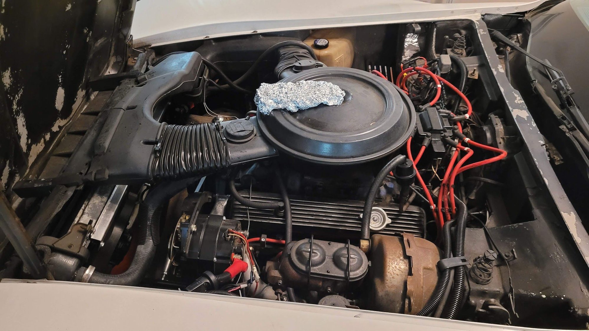

Here's my one hood measurement:
Using aluminum foil:
  • 5/8" clearance at front edge of air cleaner lid
  • 1980 L48
  • Stock 1980 hood*
  • Stock original M4ME Quadrajet
  • Stock original (for 1980) dual snorkel ducted CAI
  • No spacers or gaskets
I measured the dual snorkel air cleaner assembly. On a flat surface, it is 4.125" tall. The carb flange is recessed 0.75", leaving an effective height ofQ 3.375".
*GM lost 250 lbs of weight on these cars between 79 and 80, including in the hood. In order to close my hood, I need to drop it from about 6" or greater. It is possible that between the flexible hood, and the closing operation, I got more squish than would be present in operation. When I bought my car, one of the engine mounts was completely failed, yet there is no evidence of the engine bouncing around and hitting the hood. There are Moroso solid mounts, now, which should be the same height as stock.

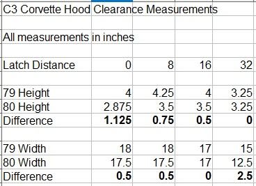

Since I also have a collection of hoods, I took some measurements.
Starting between the latch hoops at 0, then at 8, 16, and 32" down (32 inches is near the hinge, right over the radiator, so the tape measure is backwards in the image), I measured the max vertical offset from a straight edge between the two hood rails (marked in tape on one side), and also measured the "width" of the raised area.
These measurements are approximate only, but show a noticeable difference.

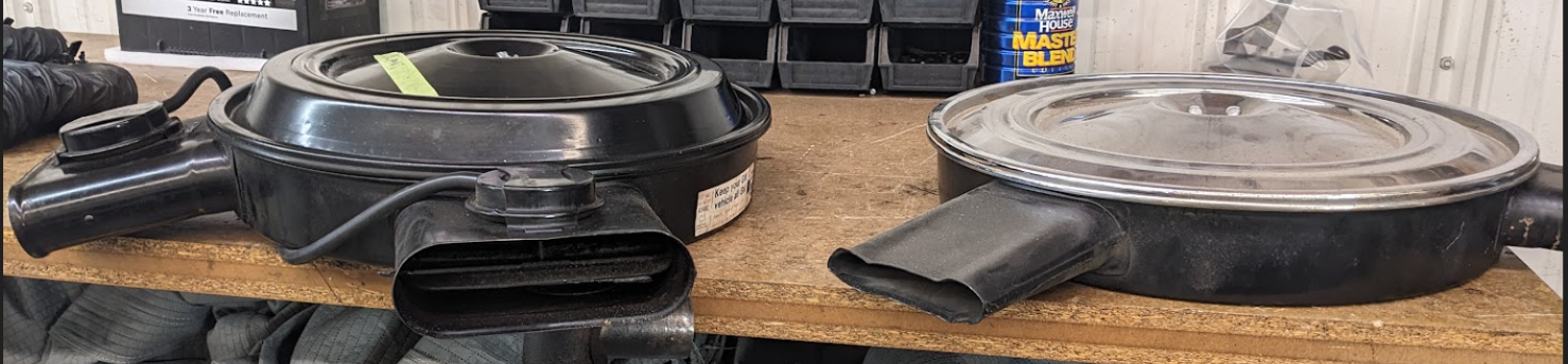

Two twin snorkel air cleaners. An 80 and a 71. 4-1/8" high and 3.0" high. Takes a 3-1/4" or 2-1/4" tall filter element. Both of these are a 1.0" drop, carb flange to base.
Also a GM Open Element air cleaner
4.0" high overall
2.0" drop flange to base. 3-1/4" filter element. This one is off a 71 LT-1. There are at least 4 variations of these air cleaners, but the only part that varies is the air vent tube, it's placement, and angle. There is even one with no vent tube.
