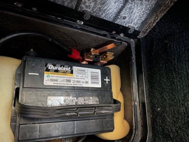

Originally Posted by USMC6113
Battery disconnect Mounts right to the negative battery connection.
This be the one I use, hooked up to the negative post....

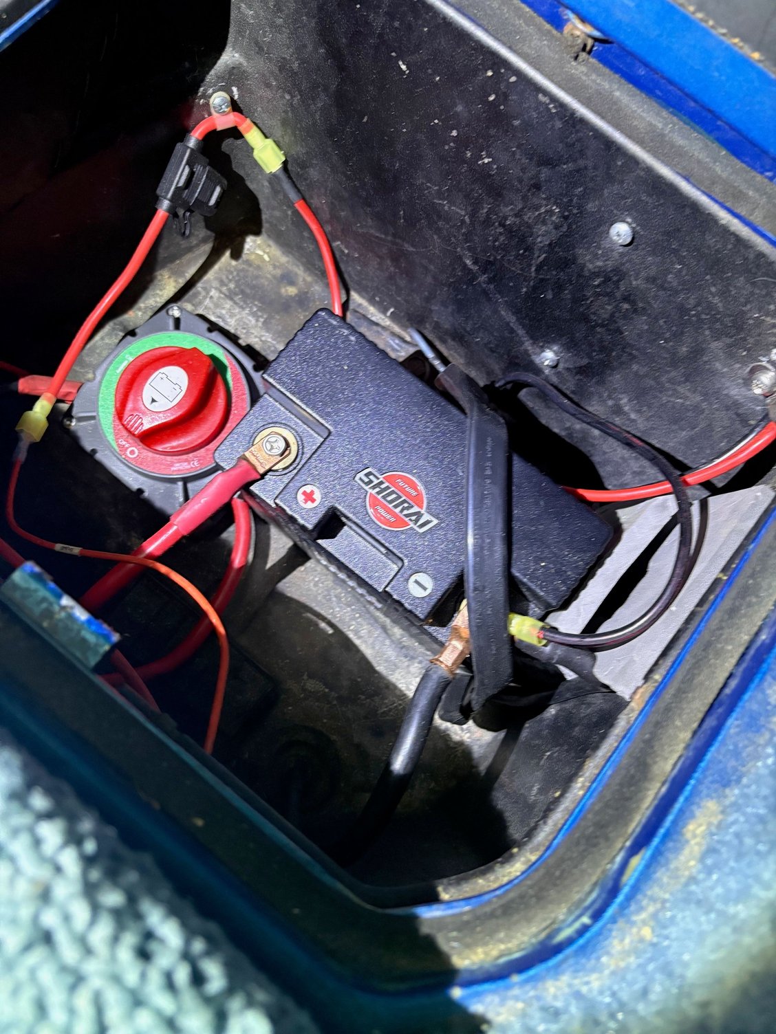

I used a switch for a marine application. 600A rated.

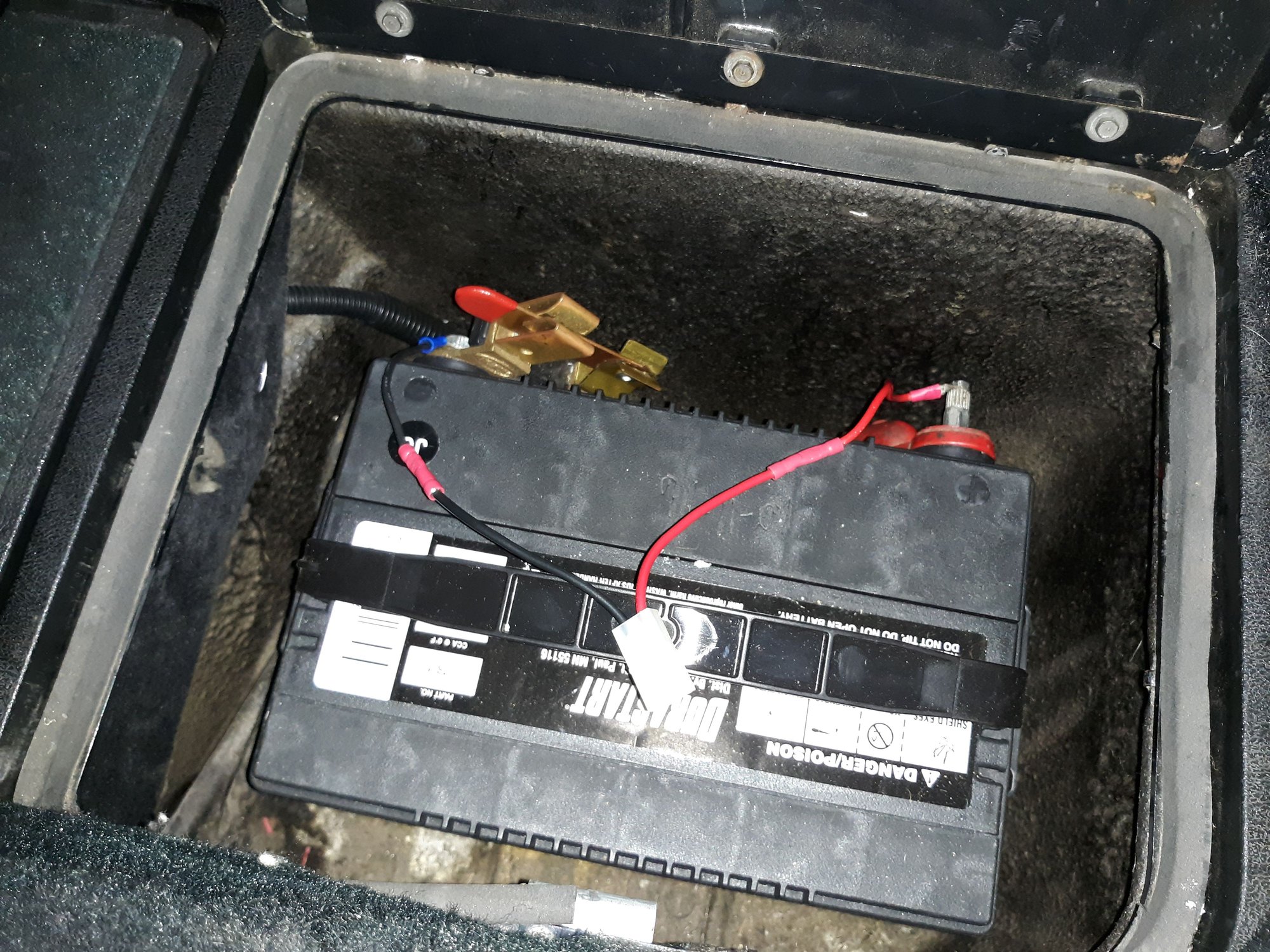

From: Fountain Hills (Phoenix) AZ
Don't like the **** switches at all. Awkward to use and sometimes a poor connect/disconnect feature. Your choice.
I have these on all my cars.... several for 20+ years. Seem to work very well and easy to use.
