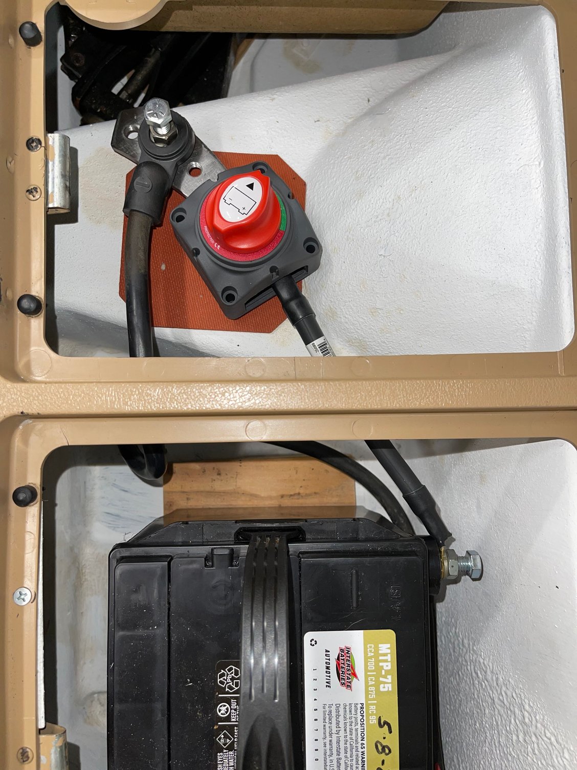

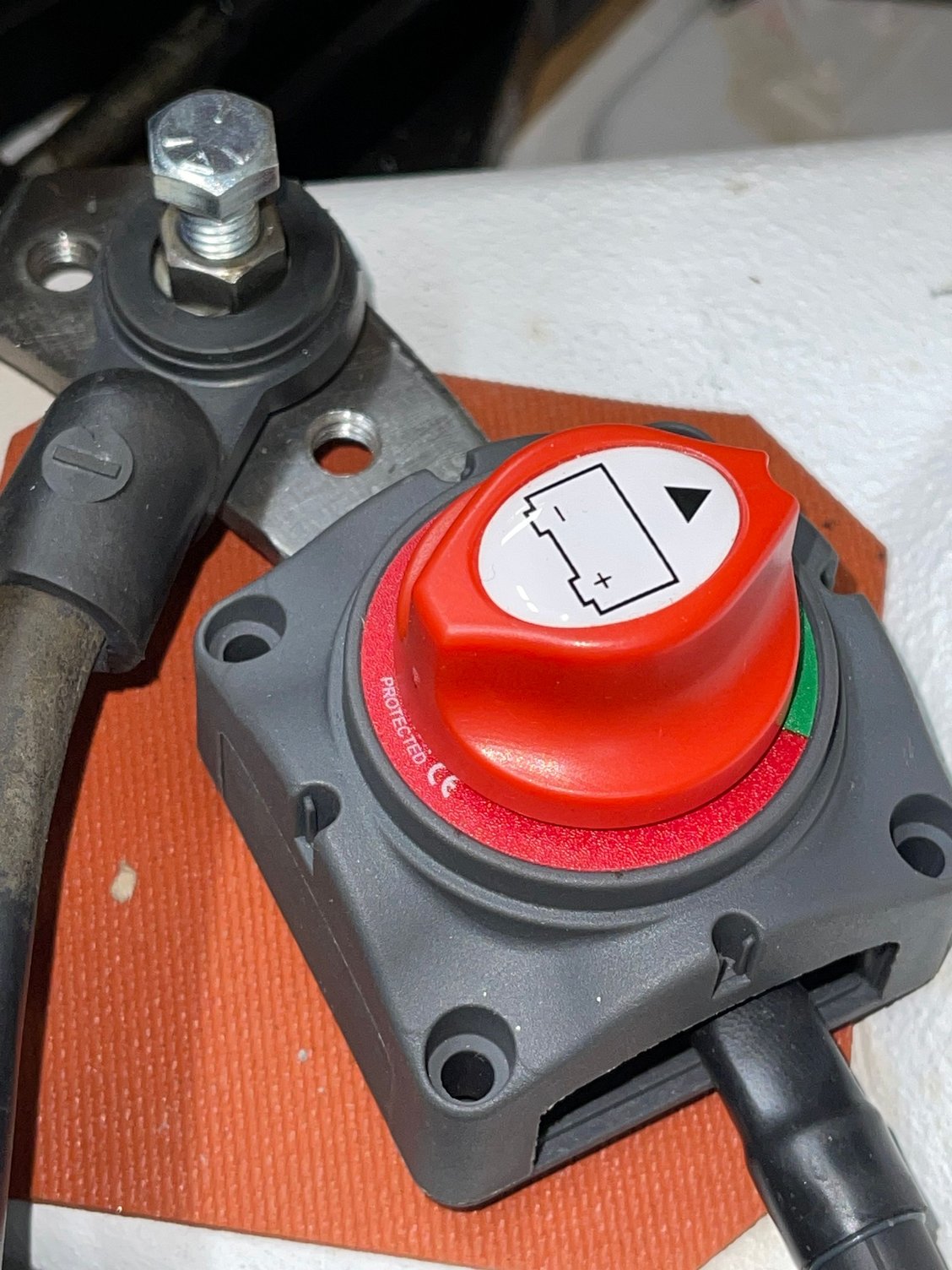

This is what I did. Removed the center compartment. Drilled and tapped a steel plate, attached negative cable to plate that is attached to quarter turn switch (tried flimsy rotary switch and knife blade switch, not impressed) then a short negative cable of proper size to the battery. Very easy, clean
access and not flimsy.

That came out great! Yes, looks sturdy too
