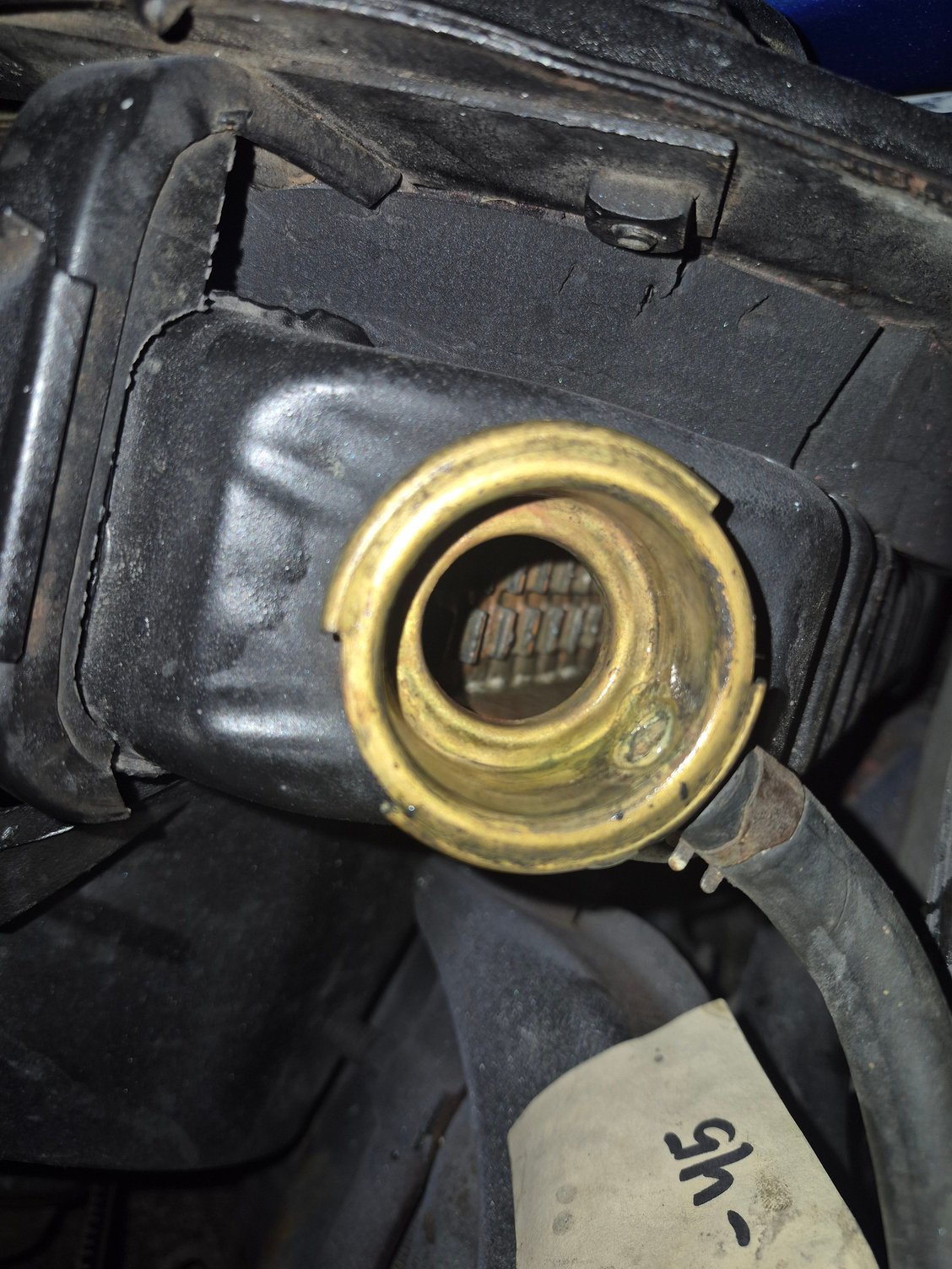

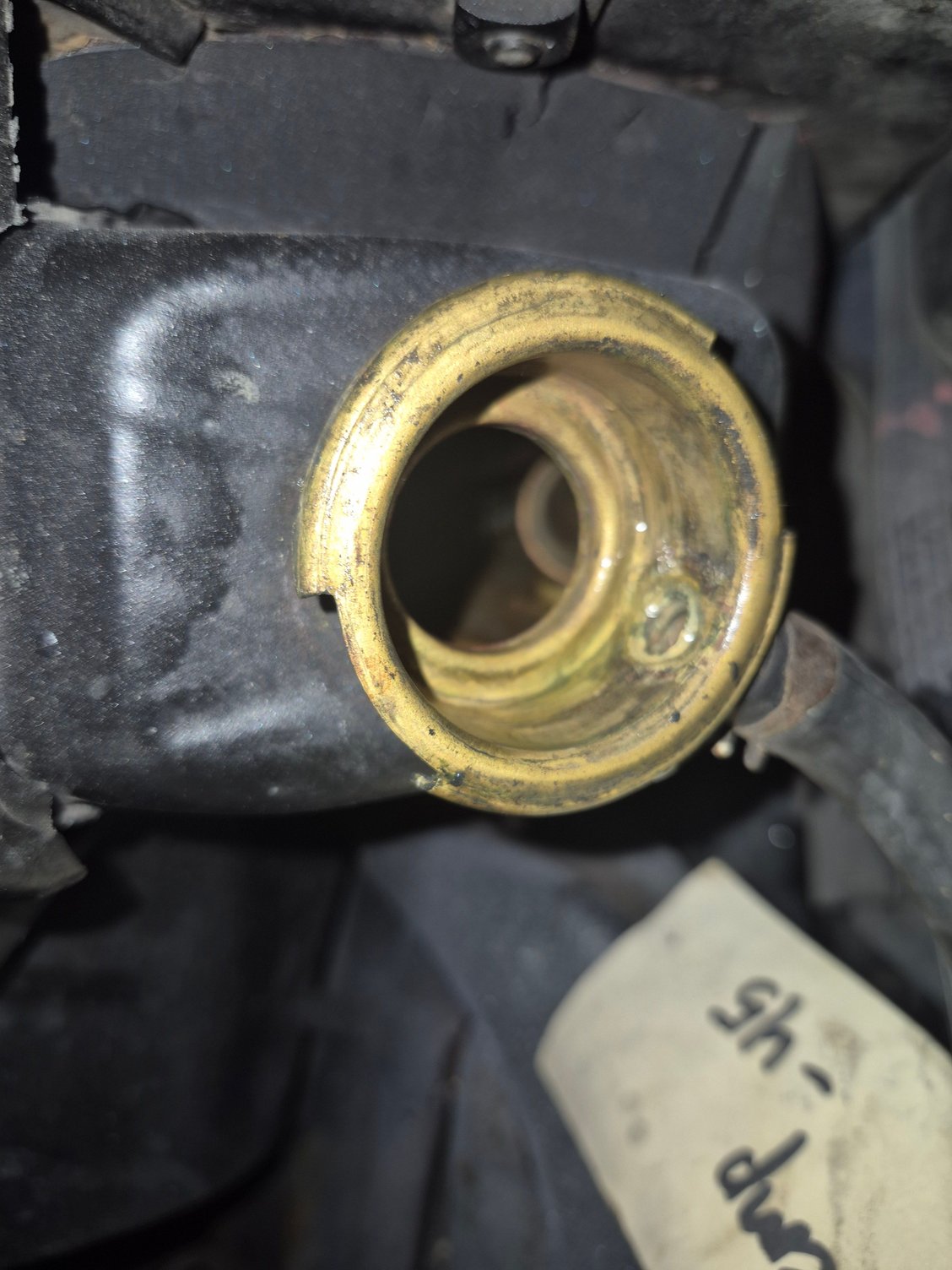

Glad we got that sorted out...but what does the inside of your rad look like?

best I could get

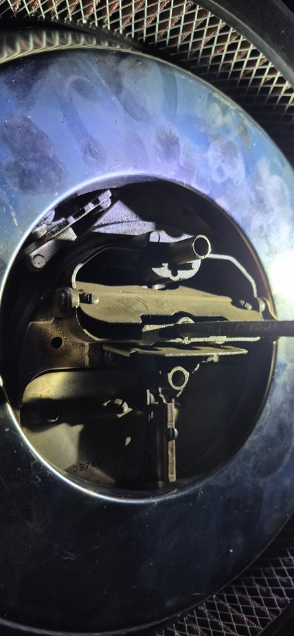

Is this right save an argue ment
