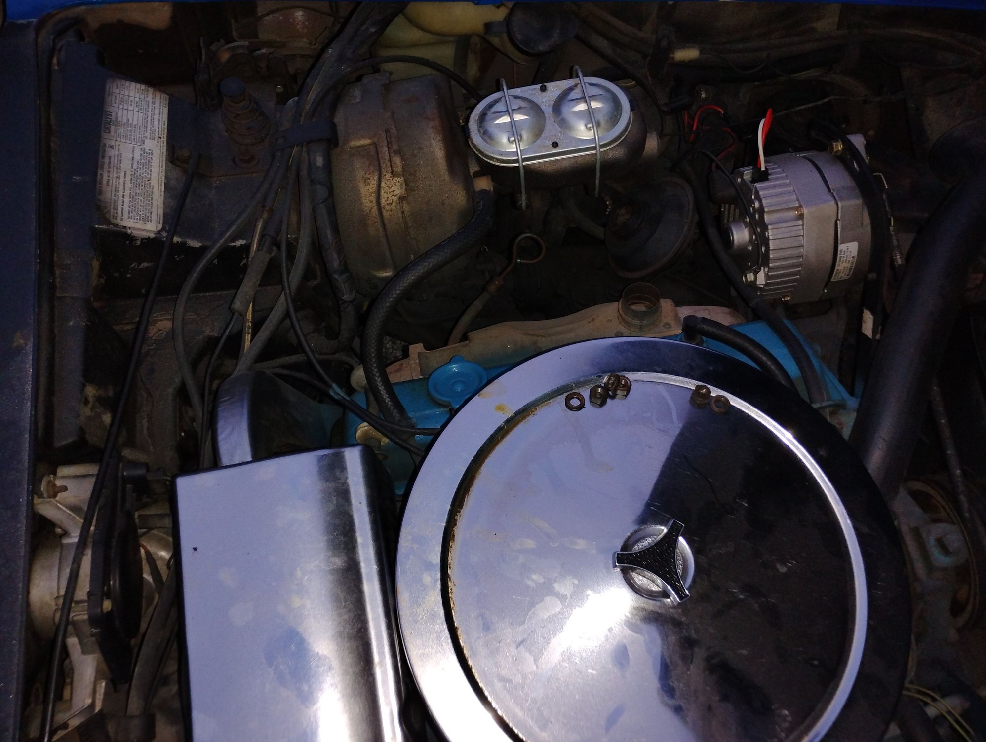

I will post some photos here in a few for better info maybe a video of the noise i was trying to explain

Default This is my issue
Old Aug 3, 2025 | 03:57 AM
Kdavis2271's Avatar
Kdavis2271
Joined: Jul 2025
Posts: 35
Likes: 5
Default Hopefully problem solved
I have discovered it was the water pump and have been working with my veery limited supply of tools (deff using some MacGyver status tools ) for a half day waiting on parts an some new wratchet an socket set......now bigger issue while giving the thermostat the attention it very much so needed i may or may not have smacked my pinky knuckle off the Lil sensor thing on the top while trying to loosen the bolt an it suddenly snapped fml

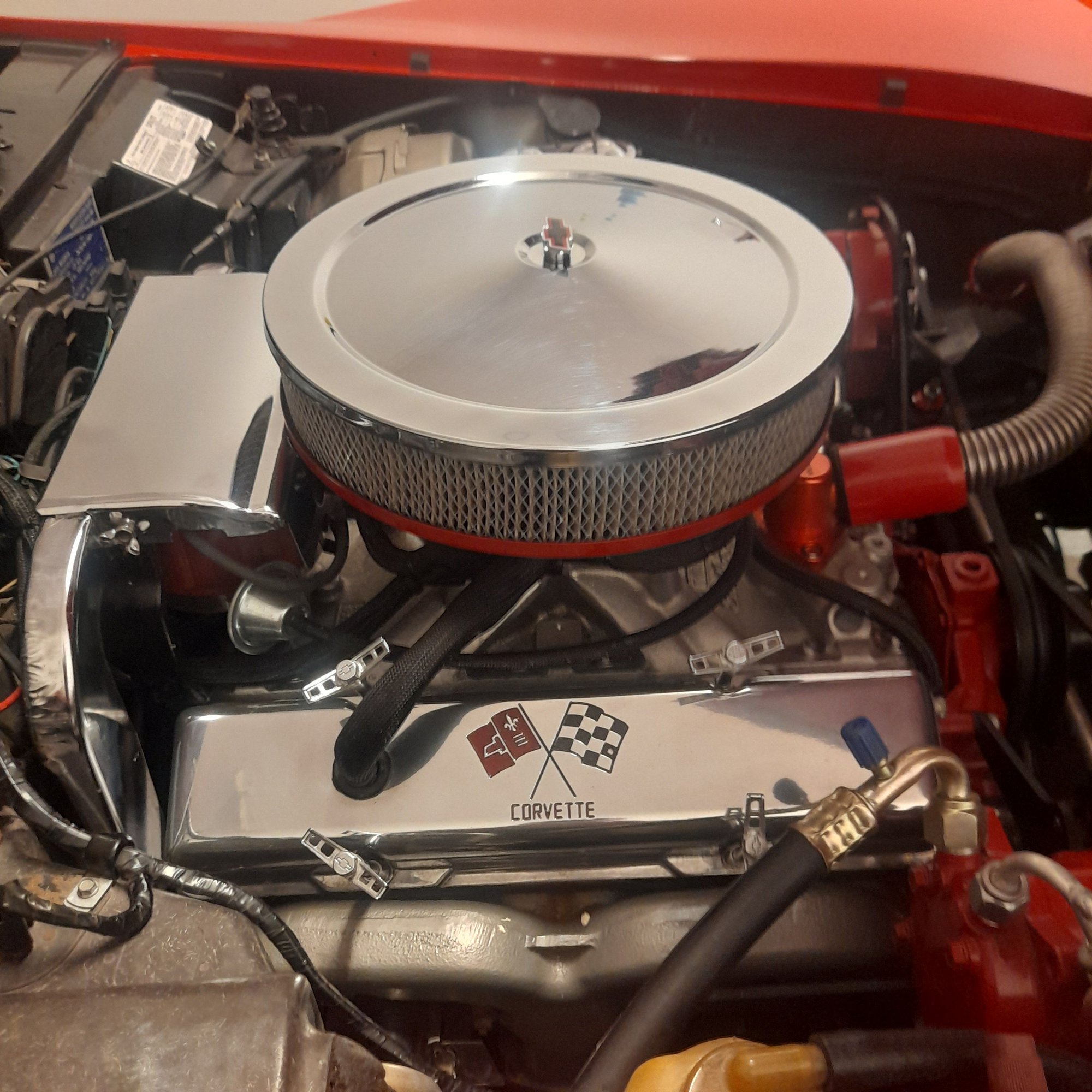

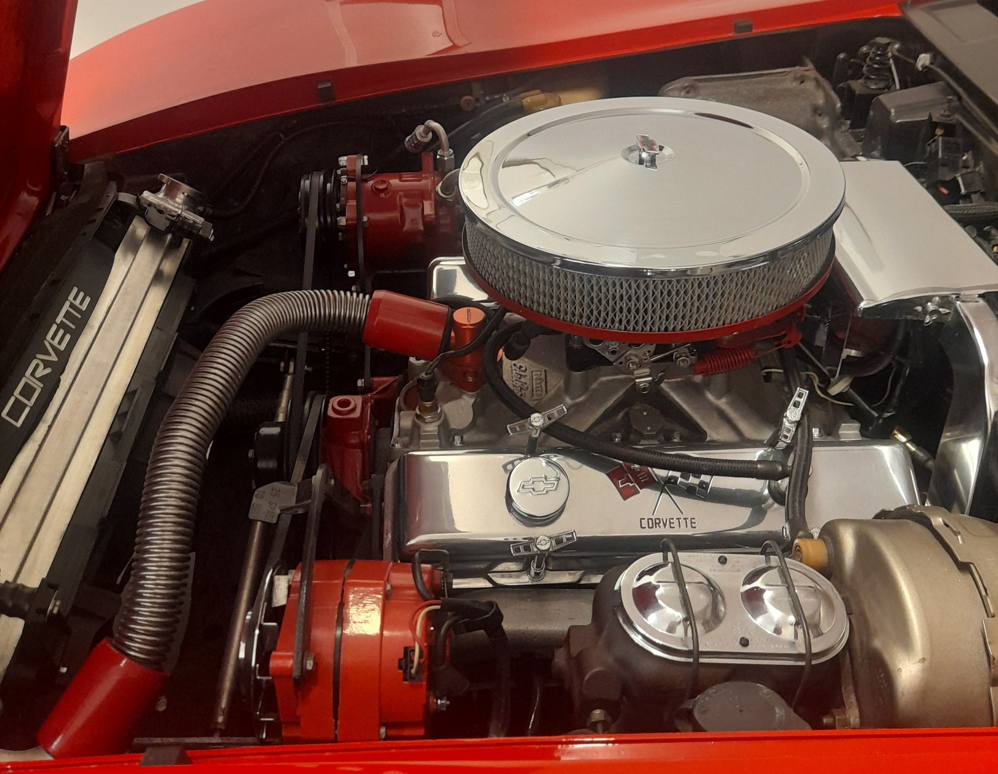

That's OK. I see a few things that are not factory stock in your engine bay. Just delete the stupid thermo vacuum switch and move forward.
here's my 77. See any thermo vacuum switches?

When the pics were taken, had you already started disassembling the fan from the pump? If not, where are the nuts holding the fan clutch to the pump/pulley? Speaking from experience, even if the clutch hub is just loose it can make quite a rattling racket.

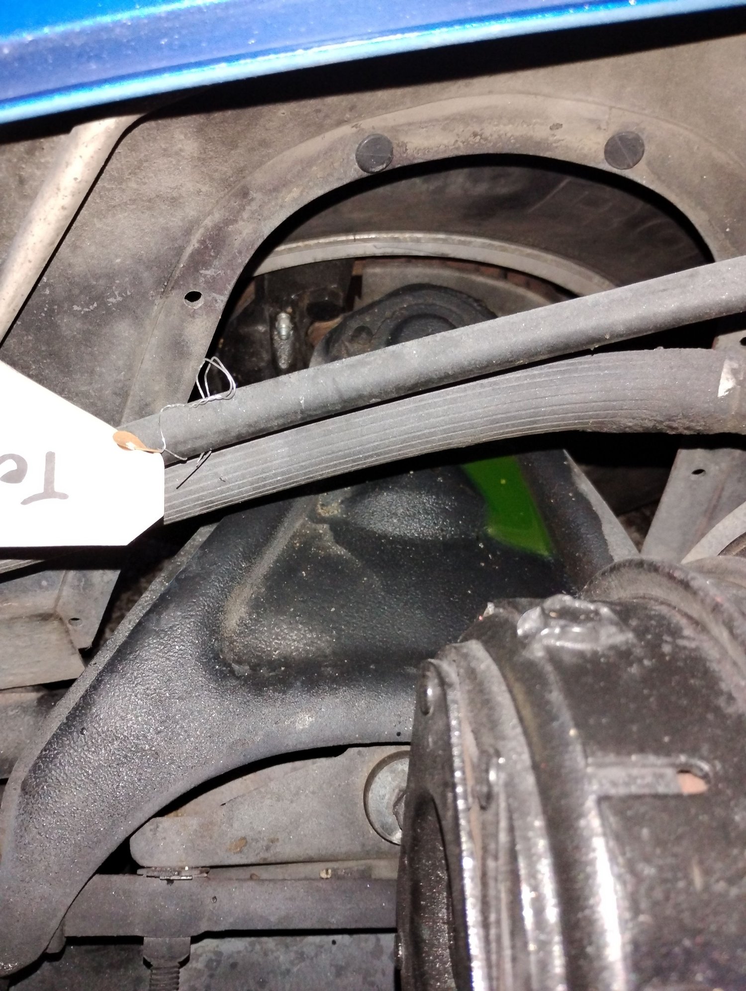

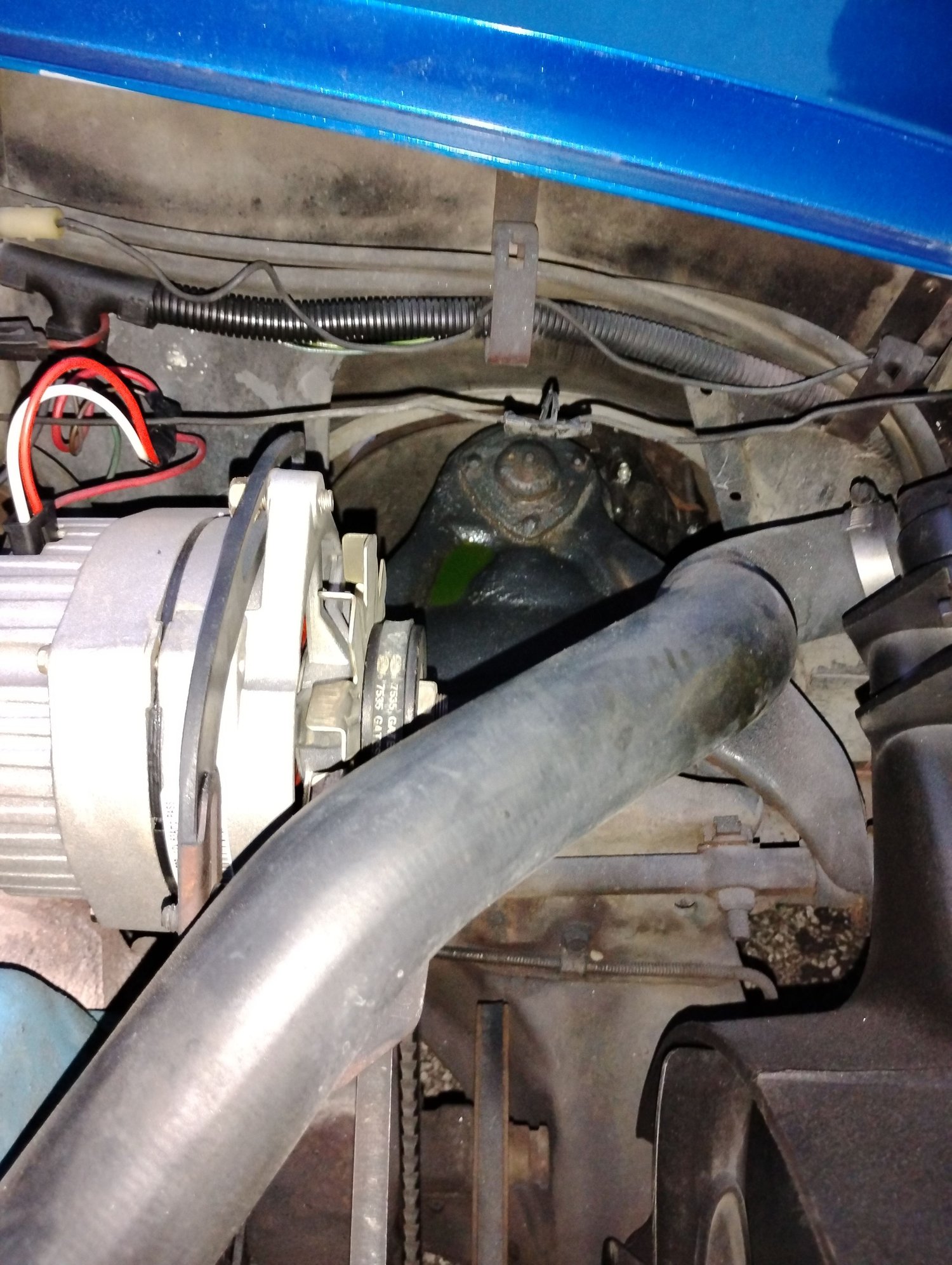

(The fan pulley nuts and locking washers laying on chrome air cleaner lid)
I still think you blew a hose on the passenger side.
Control arms are flooded with green coolant.
Waterpumps usually do not do that. But the surrounding hoses will.
When a W.P. is dyeing, usually the weep hole under the shaft dribbles.
Then, the shaft bearing starts to play games. The fan will have excess play in the blades.
And sometimes the gaskets between pump & block will weep.
But never seen one spray. (like a hose)

yes I had its been replaced not i have a few more issues such as that noise still coming from the heater core area I have a video but it won't let me post it an now my wife has found an unknown fuse of power relay underneath the passenger side console

It was all over the bay and coming from underneath

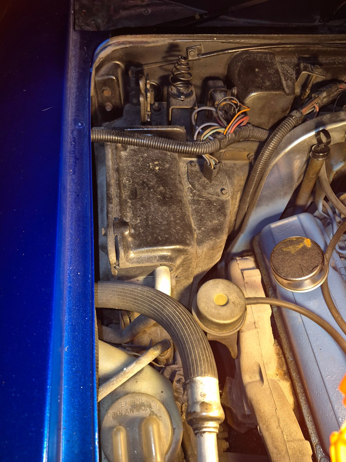

I've attached the updated photos since I've done the pump the heater core area still makes a god awful noise tho
This is after i broke the lil nips off the thing that was on the thermostat
This is where the noise is i have a vid but it wont let me post it
Post it to your YouTube account and link back to here.
As pspicci mentioned way up in #6, the heater core noise may be the heater/AC motor or squirrel cage fan. Try pulling out the Heater A/C fuse to see if the noise goes away.

Here it is ty for that one
Old Aug 4, 2025 | 04:01 PM
OMF's Avatar
OMF
Joined: Jul 2006
Posts: 2,286
Likes: 487
From: Salmon Arm, BC
Yes, that noise is your HVAC fan motor. It's dead and needing replacement. As mentioned previously....pull the fuse to confirm and stop the noise.
