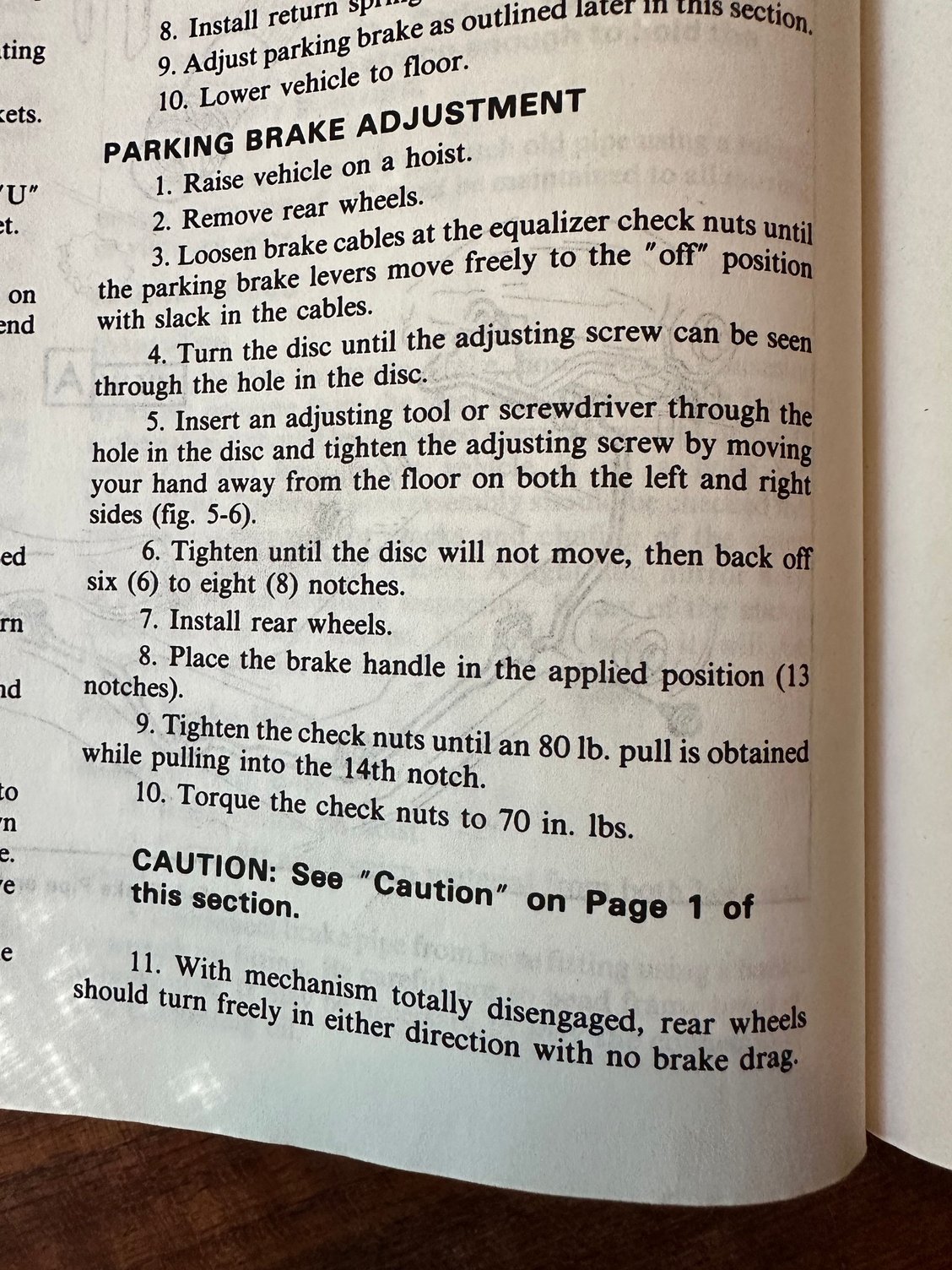

What procedure did you use to adjust?
Did you follow the factory service manual procedure?

After complete rebuild mine also needed several adjustments. Factory manual says to back off adjustment star 6-8 notches from tight; mine required only 3-4 notches to work. Charlie

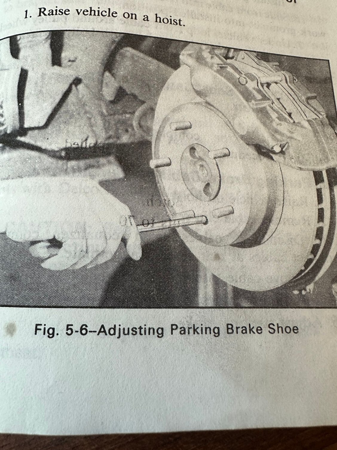

Maybe if someone can tell me how to get to the pictured star wheel adjuster I can try that myself
JJ78

You should have a hole in the rear rotor that gives you access to the star wheel. How were you trying to adjust it, by the cable?
Lots and lots of pictures and vids here and on the iweb

Rather than 6-8 notches, mine was best at 3-4.

No MelWff I was trying to find that hole???
Does the rear have to be jacked up with the TA's leveled straight out in order to make the adjustments??

The rotor may not be clocked correctly if the hole does not go through.

The rear has to be off the ground so you can remove the tires and turn the rotor. The TA's do not have to be level. The detailed instructions have been posted and as mentioned if someone removed the rotor and did not correctly install it the hole in the rotor won't line up.
