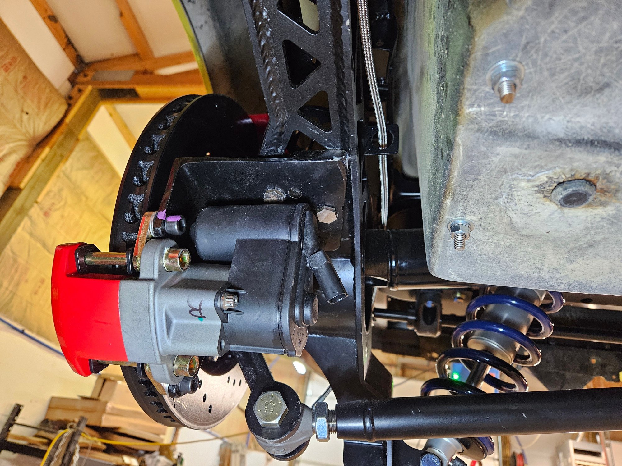

As an alternative to the stock system, I am using Wilwood's electric parking calipers. Granted this requires some adaptation and fabrication to get the caliper mounted to the swing arm, but if you have the means, this is a solid parking brake solution.
