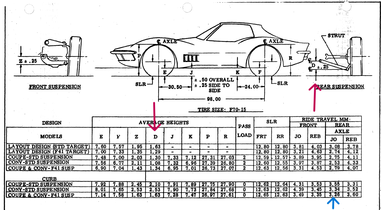

I have seen several posts recommending a “D” dimension for the rear strut rods of 1.25”. Just took a look at my 1978 AIM, UPC 0, page A14 that specs 2.33” plus or minus 0.25” at curb weight (full tank). What does the group think? Is the 1.25” for earlier c3s perhaps?

The 1.25 is from the Chevrolet Power manual for track usage.

My 72 AIM has 8 different heights:
So both of your numbers could be correct, depending on weight, F41, race, etc.
