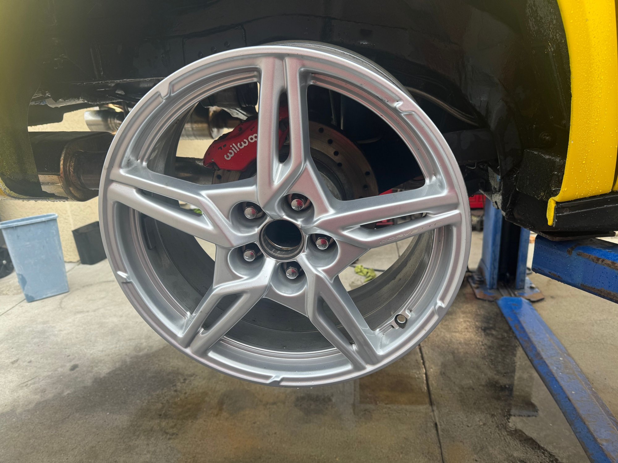

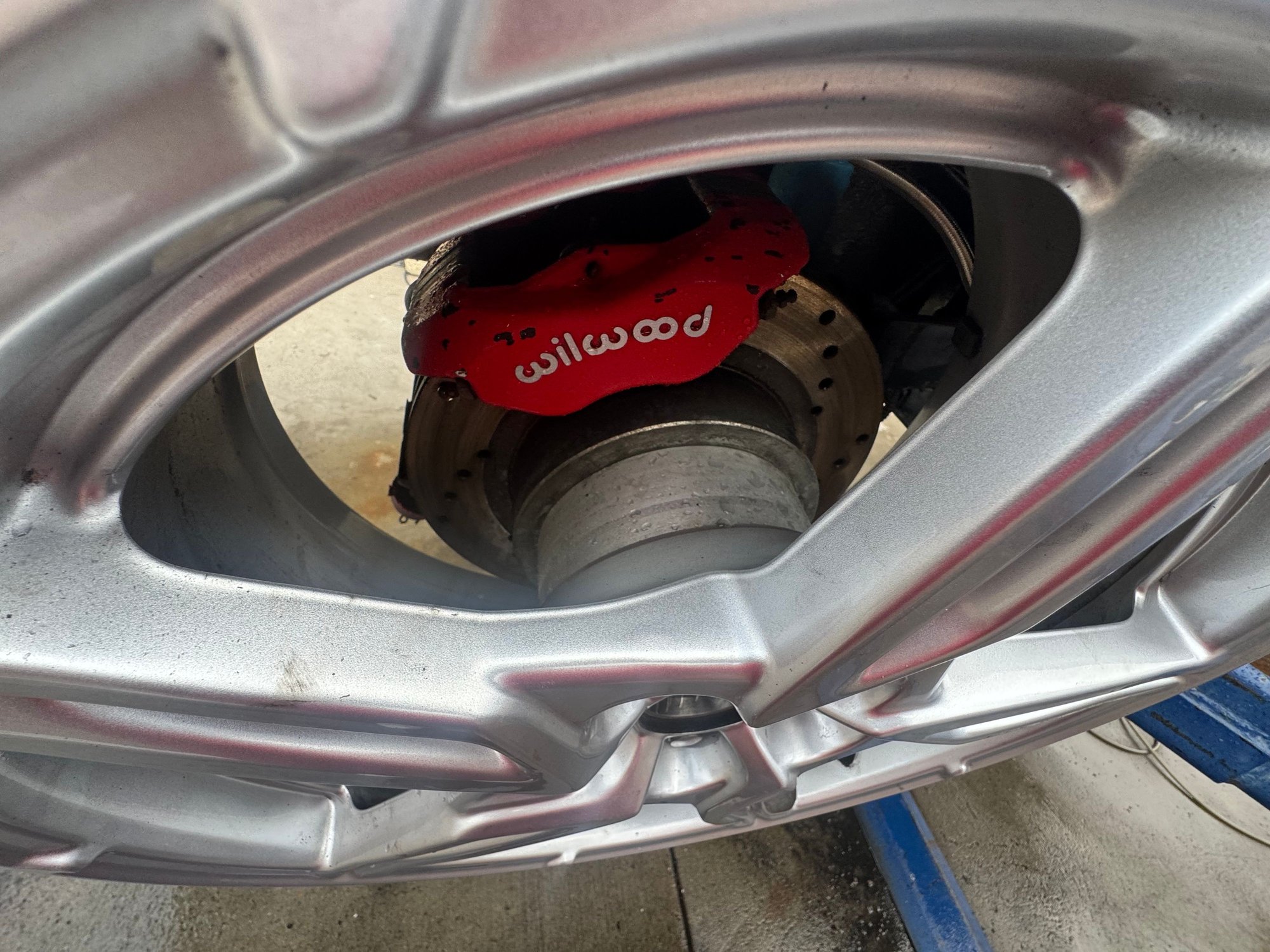

I just bought some new forged and polished wheels for my C8. I had the C3 up on the lift, and just for grins I tried the C8 wheels on the C3. They fit! Using the same adapters for fitting C5 Z06 wheels. Good to know!

They are very close but unfortunately not the same bolt pattern. There has been other threads on this in the past.
C8 Corvette- 14mm studs, centre bore 66.9mm, 5x120mm bolt pattern
C3-C7 Corvette-12mm studs, centre bore 70.3, 5x120.7mm (4.75") bolt pattern

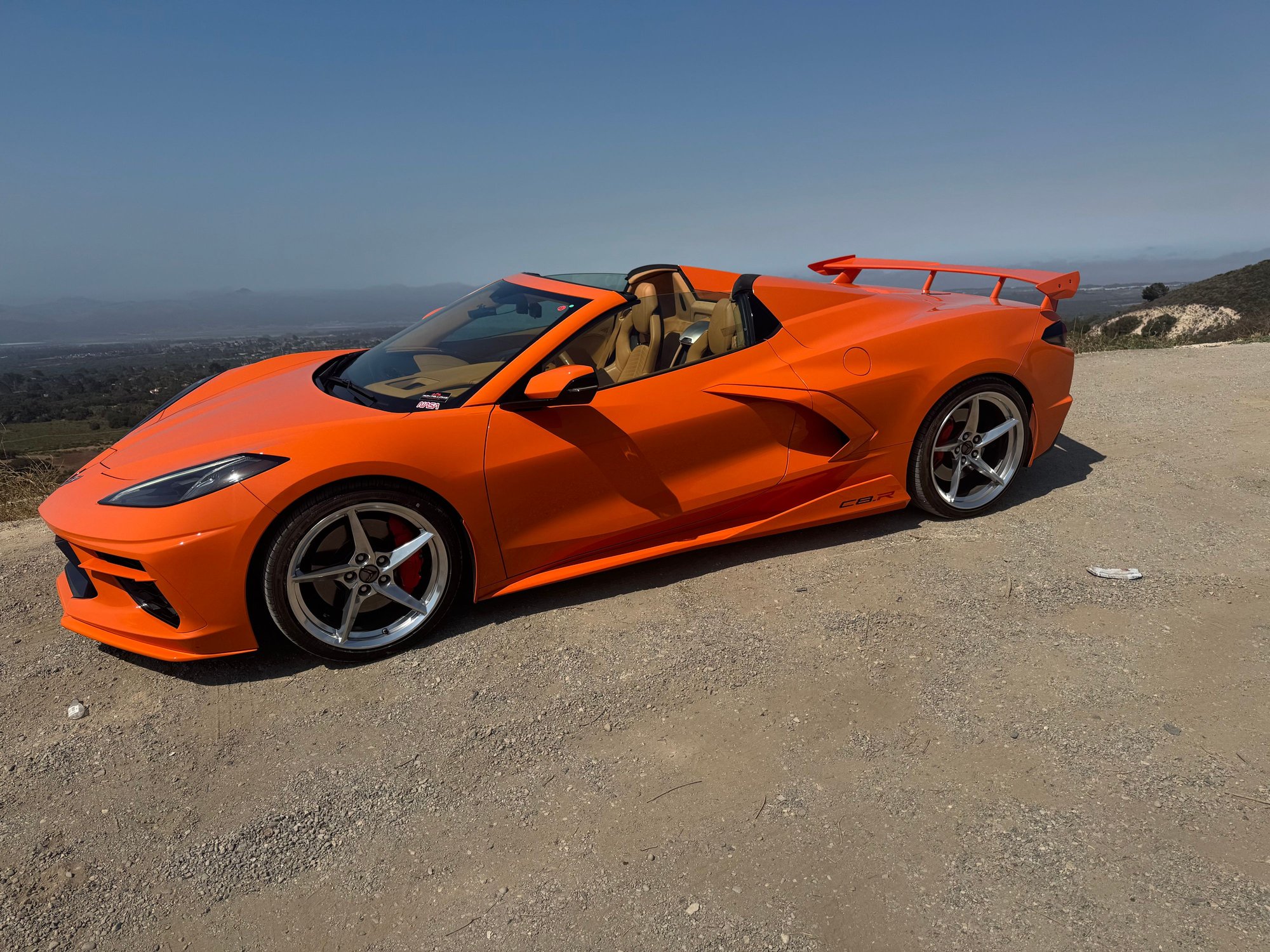

We need a better picture of the overall look.
