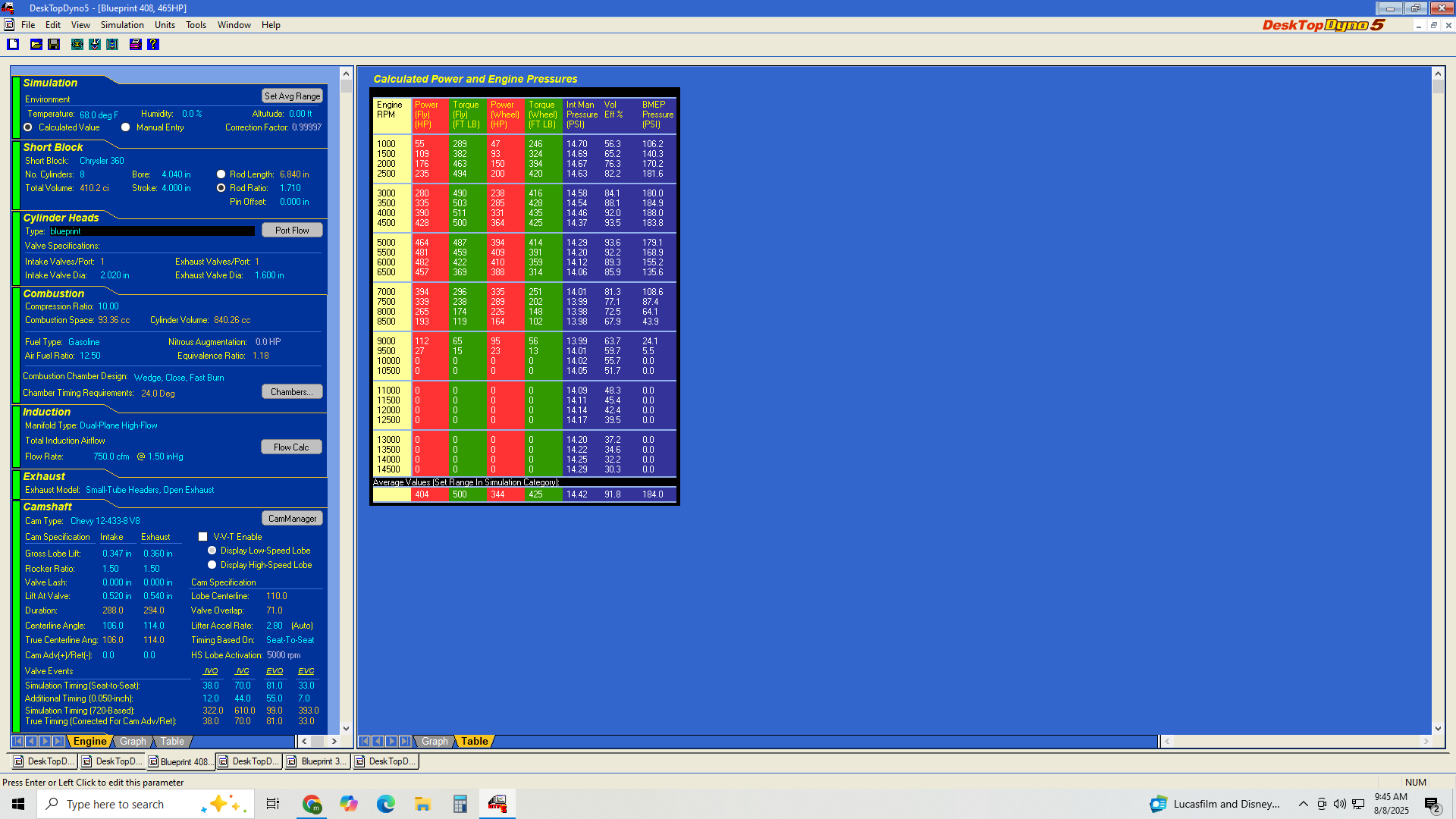

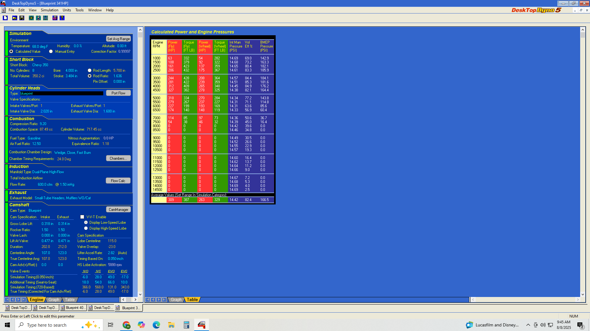

Here's my $0.02. I wouldn't ask anyone including camshaft manufacturers for a recommendation. It's too subjective. What I've done is to buy and download Desktop Dyno and plug in the numbers. Don't just look at peak horsepower but the average horsepower in your RPM range. I based this on RPM drop between shifts. Also the horsepower at 1000 RPM's is important too for a steet car to have good driveability. One of my cars makes about 63HP@1000RPM's with a start up ratio of 9.5 and the other is about 55HP@1000RPM's with the startup ratio of 10.7. While Desktop Dyno is not an absolute, it's a good tool. Also YouTube has videos of cars idling which you can get an idea from also. I'll start you off at one at the bottom. For some reason it's one of my favorites, LOL.

I totally agree with Fly skids up on a couple of his points there! Time spent on Desktop Dyno is well spent and you can learn a lot from it. Hours and hours of time were spent on my parts before buying started. The newer Desktop Dyno also has a bigger library of cylinder heads and cams shafts to pull from. I love playing with this software as you can frequently find horsepower.
