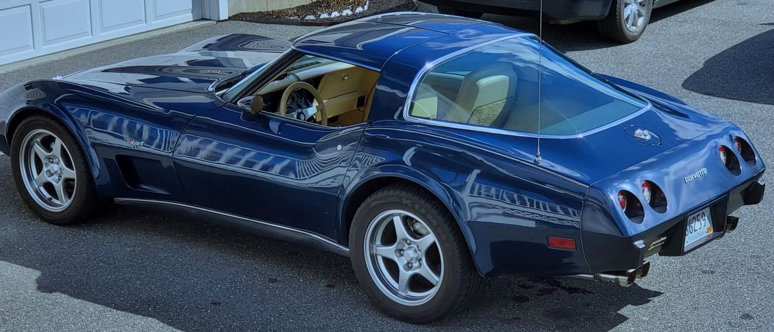

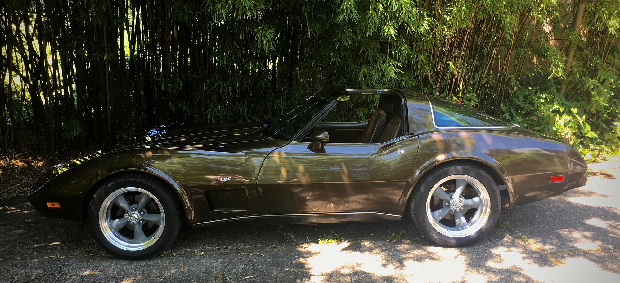

A few points to clarify here:
Both pictures are after I rebuilt/upgraded the OEM L-82 with aluminum AFR heads which significantly lightened the weight over the front axle. The ultra high performance summer only tires and rims are SLP 17's with 255/45/17's in front and 255/50/17's in the rear (needed to preserve the OD of the tire in the back because of 3.70 gears and 1:1 4 speed manual). I had to cut a half a coil off the front 550 springs after the engine was reinstalled and have a 360lbs composite monospring in the back since the late 80's.....
Second picture has C4 Borla Type S mufflers along with 1 7/8 inch long tube headers versus very restrictive Monza Turbo mufflers in the first pic with shorty headers I put on the car in the late 80's.....The 355 L-82 now is probably one of the more powerful SBC's (including just about any 383) I have experienced and the sound from those Borla Type S's are like no other muffler and worth every premium dollar for them....quiet at cruise, muted rumble at idle, and get your attention at mid to high throttle.....
